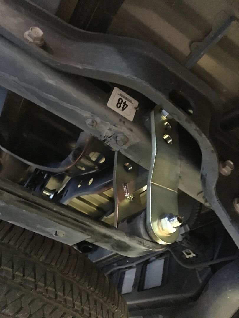

    I'd opt for shackles over a block.
    These Toytec have a 1" or 1.5" setting.. It's what I'm using..

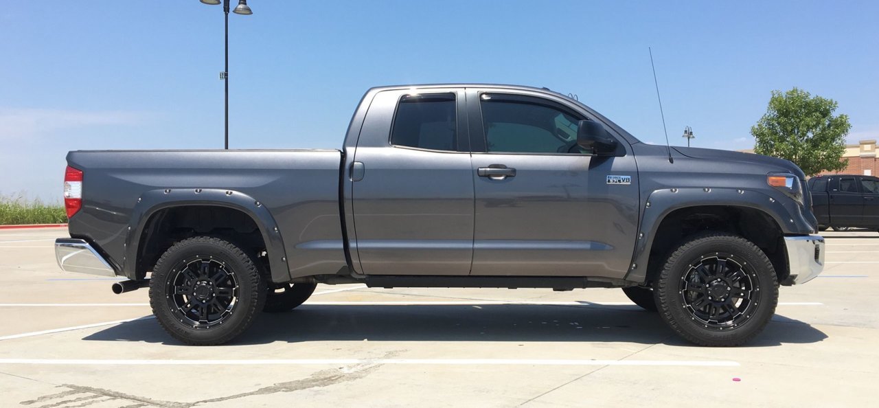

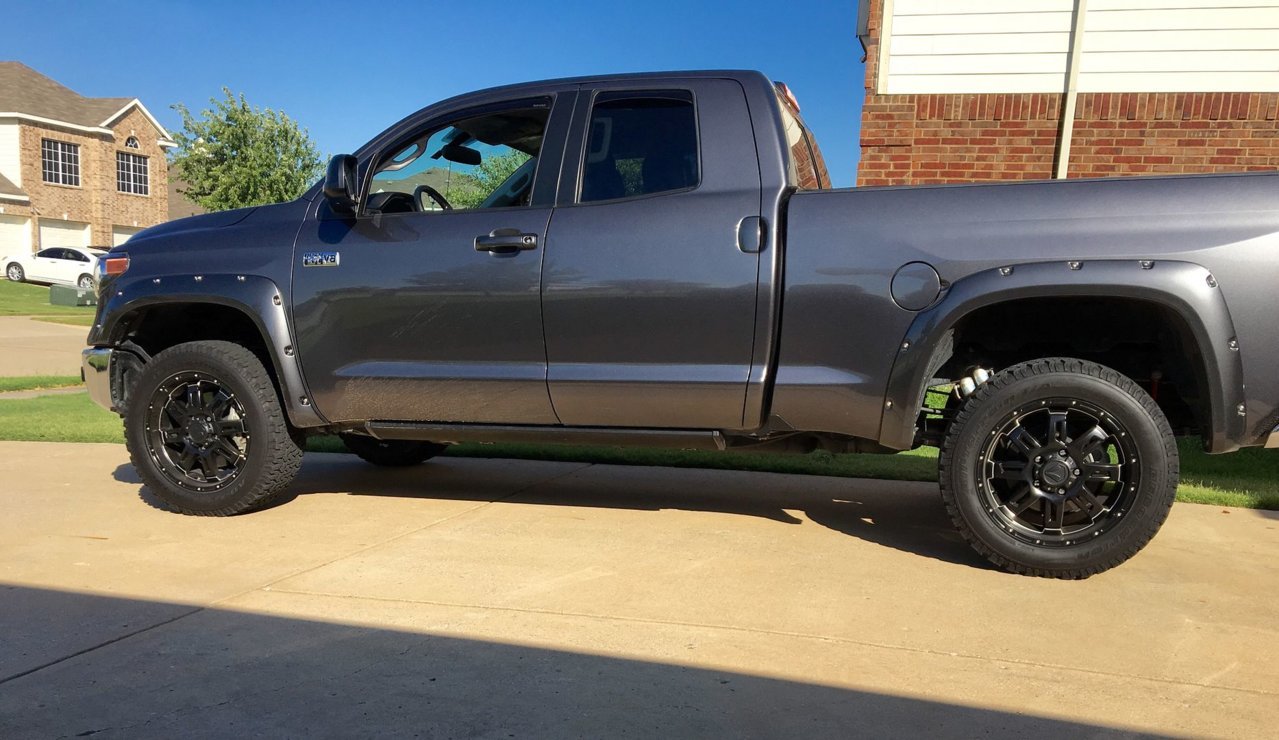

    Sure..
    6112 front set at 2.5 of lift.
    5160 rear
    toytec shackles on the 1" setting..
    942B7FE5-470C-4383-9C30-59887BC9D6D9_zps_a8747e7bccd94158852fe28b2148e53e73e14110.jpg
    91CBAE5D-765D-497E-9830-48F25491821C_zps_0c590860e5ef26b05e259383973e26b24493fbb1.jpg

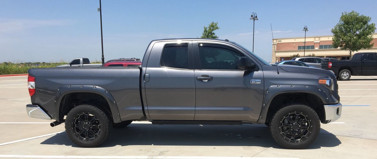

    I first put the shackles at 1.5" and it was too much rake.
    3733DCB6-FAEF-49B9-BA41-7B5A43CDDC24_zps_0f789051df21d756b0ae1b64d8232a17fdaf2a29.jpg
    A1236474-134A-4520-8381-00AB5F6E2B1C_zps_dd0805a91c7bcbed3a20f60d75f47d5614182281.jpg

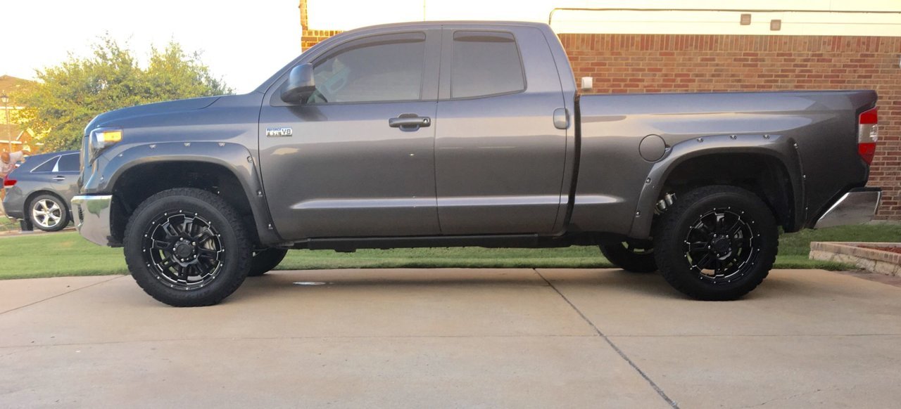

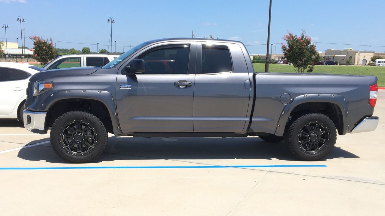

    With 2.5 front lift and rear stock, it sat about level.
    Maybe a touch front high.
    But it set off nanny warnings when I turned too fast, which I often do..
