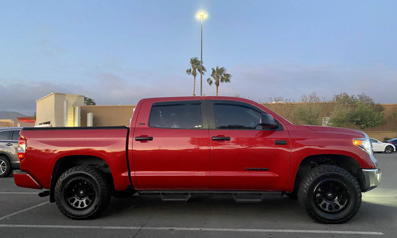

    tundra_uso
    tundra_uso New Member
    Sep 12, 2020
    #52132
    18
    East Bay, CA
    2020 SR5 Crewmax 4x4
    5100s all the way around with the fronts at the top setting.
    265/70/R18 General Grabber ATX
    Fuel Vector Wheels 18x9 +20mm offset
    ATV25 and pvn.beluga[OP] like this.
  24. Jan 8, 2023 at 9:14 AM
    #54
    pvn.beluga
    pvn.beluga [OP] New Member
    Dec 28, 2020
    #56744
    2,009
    Phuc (Phooc)
    Connecticut
    Looking good!! What was the reasoning for downsizing to 265?
  25. Jan 10, 2023 at 10:06 PM
    #55
    tundra_uso
    Sep 12, 2020
    #52132
    18
    East Bay, CA
    I apologize, they're actually 275. I was thinking my original size which was 265.

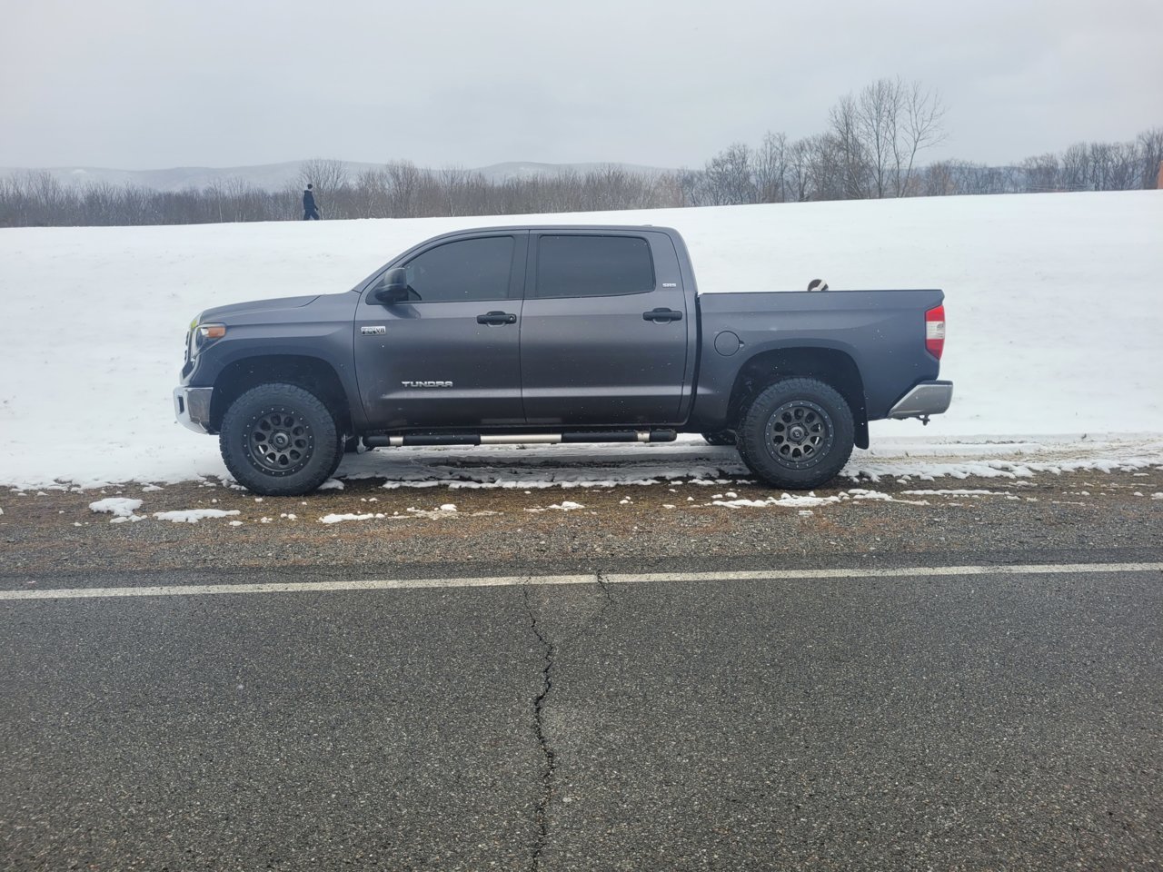

    72
    New Jersey
    2021 Tundra Crew Max SR5
    5100 front only, top setting.
    SCS Ray10s +25 offset
    275/70/18 Cooper AT3 XLT.
    Bone stock rear.
    Question, with a +1 CB on rear, would I still need to correct driveline angle, or is it plug and play at such little height?
  28. Mar 18, 2023 at 7:54 AM
    #58
    pvn.beluga
    Dec 28, 2020
    #56744
    2,009
    Phuc (Phooc)
    Connecticut
    No, there isn’t a need to correct it.

  29. Jul 28, 2023 at 9:46 PM
    #59
    SOUTHSTAR
    SOUTHSTAR New Member
    Oct 3, 2020
    #53124
    2020 White Tundra TRD Crew Max
    Thank you for taking a great side angle photo that really shows the fender gaps. This looks awesome. Seems level to me. I think some of the variance comes from the additional weight in the front on the 4WD vs 2WD models.
    Rockwell[QUOTED] likes this.
  30. Jul 29, 2023 at 4:45 PM
    #60
    Rockwell
    Rockwell New Member
    Feb 26, 2023
    #92778
    72
    New Jersey
    Thank you for the compliment. I agree with your statement about 2WD VS 4WD. I think top setting on 2WD would be far to much and give it that prerunner look, or bro lean.
    After living with this set up, I've decided that at some point im going to go with the +1 CB shackles for the rear.
    I like a small rake, the stock springs will only soften with time, and as another member pointed out, the roof line don't help. You almost have to be a bit higher in the rear, to appear level to the eye.
