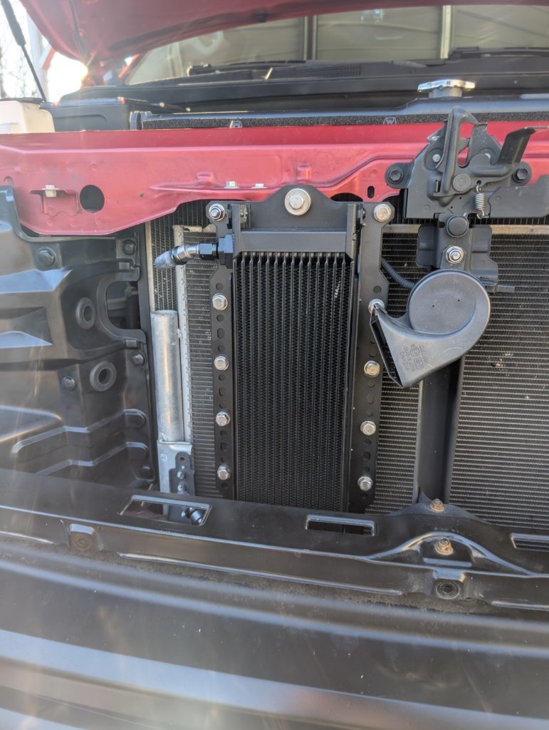

    I recently installed the Wholesale Automatic Transmission cooler. I had to purchase the thermostat and extra 10 feet of hose. Installation was pretty straight forward and a few little issues that were resolved with a trip to the local hardware store. So far no issues.

    Any pictures of the install?

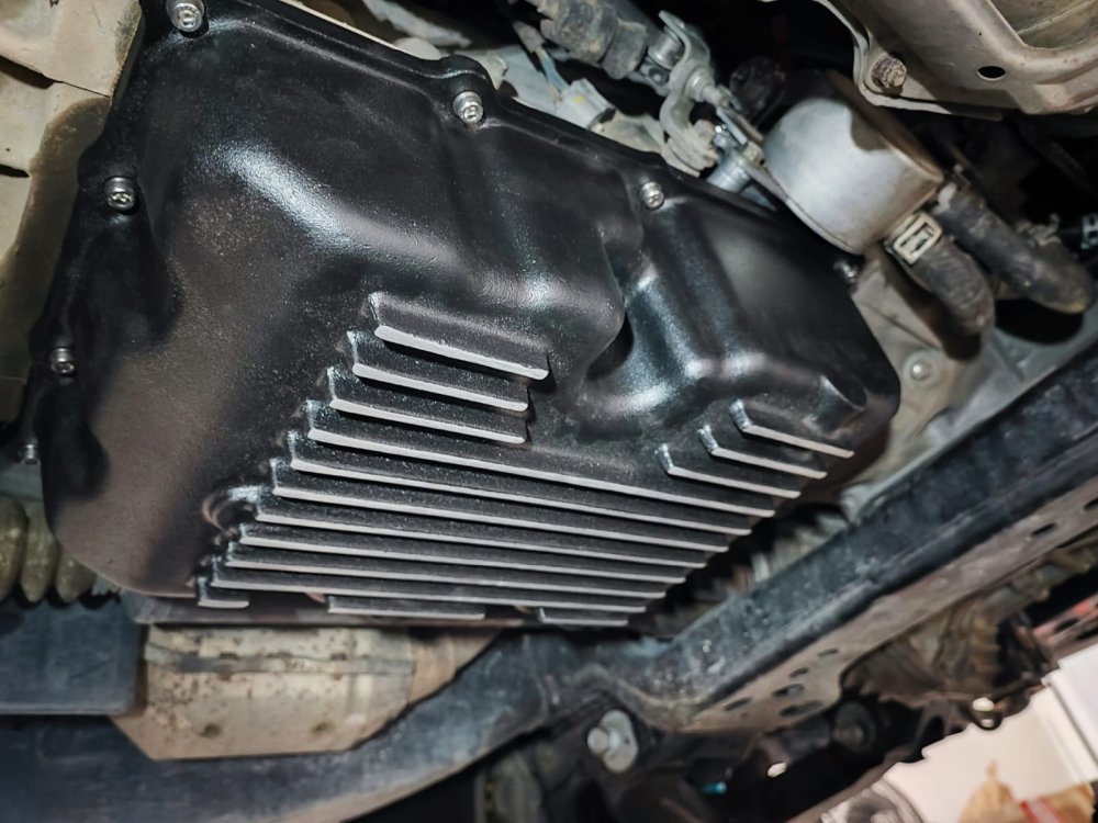

    Forgot to post! Trans kit + Deep pan installed both a few weeks ago. Used OBDFusion + Veepeak BLE+ to get the temp readings, took a while to reach the target at 66'F ambient.
    Happy with the results and ready for summer :D
    Couple mishaps with the trans fluid, but I was happy that I finally got to use a transfer pump I had laying around for like two years.
    The hardlines were the worst part of it, finding the right rotation more specifically.
    The OEM pan was messed up so it was time to go, some idiot overtorqued the drain plug and decidedly spread rtv over it to keep it from leaking... maybe leaked a drop every month.

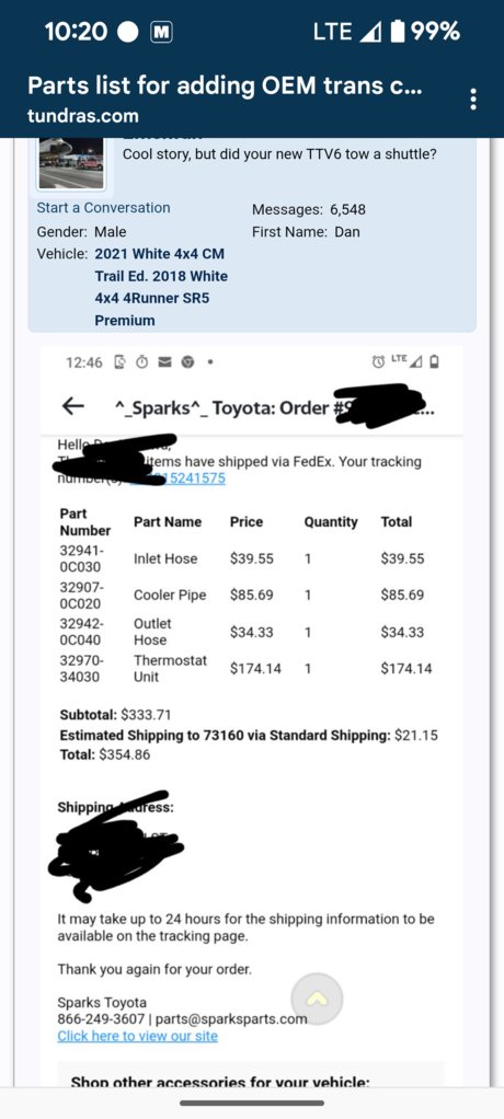

    hello all i'm a new member to the forum I have 2021 4x4 sr5 with out a trans cooler and to me it only makes sense to install one. i am in the process of gathering all the parts. my question/problem is the OEM toyota hard lines i assume a 2018 tundra part#329070C020 will work but no vendors will confirm this. any help is appreciated thank you

    No vendor will confirm fitment because technically they will not fit on a 19-21 truck since they never came with them, just like the driver side grab handle.
