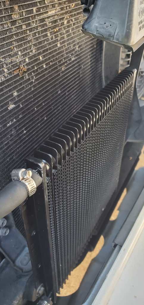

    I wouldn't call that good enough, not even from my house. YMMV
    Which way is front on that photo? If you need the rear to drop, dry deflating the tires to see if that is enough. If that is a driveway, you can also attempt to use the grade in your driveway to your advantage. Otherwise, if those don't work, really wide planks or you can try using leveling blocks (most commonly used by the RV community).

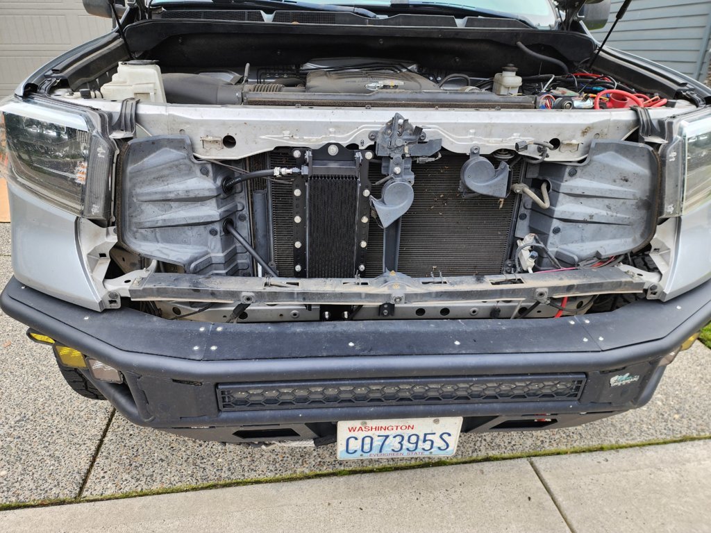

    Finished installing mine today. It was a bit of a PIA. Had to remove my Valhalla plates and some of the tight areas really suck. My hard lines mounting seemed to be a bit further apart than the holes and took a long time getting it put in. But done and ready to see the lower temps. Oh and still need to put the plates back on. Tomorrow's problem.
