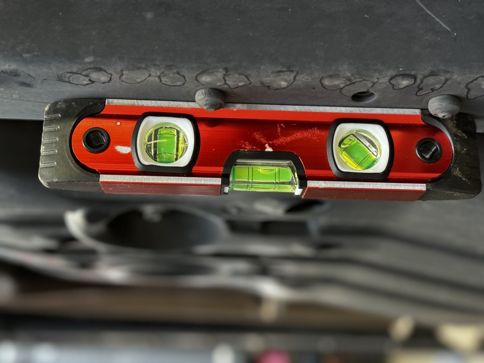

    RAS Road-Active Suspension System HD. 2" (estimated) Spacer and Block Lift . S&B CAI - closed VLED Footwell lighting MESO Customs Interior Lighting 285/65/18 KO2 Gator Hard Cover Tri-Fold AJT Designs interior trim CSU 9 - year ceramic coating Rigid Amber Fog Covers Full Tint (70% Windshield) 20% all others.
    All of the install instructions reference leveling the frame, I assume due to the ATF overflow step. I have an RAS induced rake and have Jack stands at max in the front. Level as I can get it.
    is this enough or should I stop and run to harbor freight?
