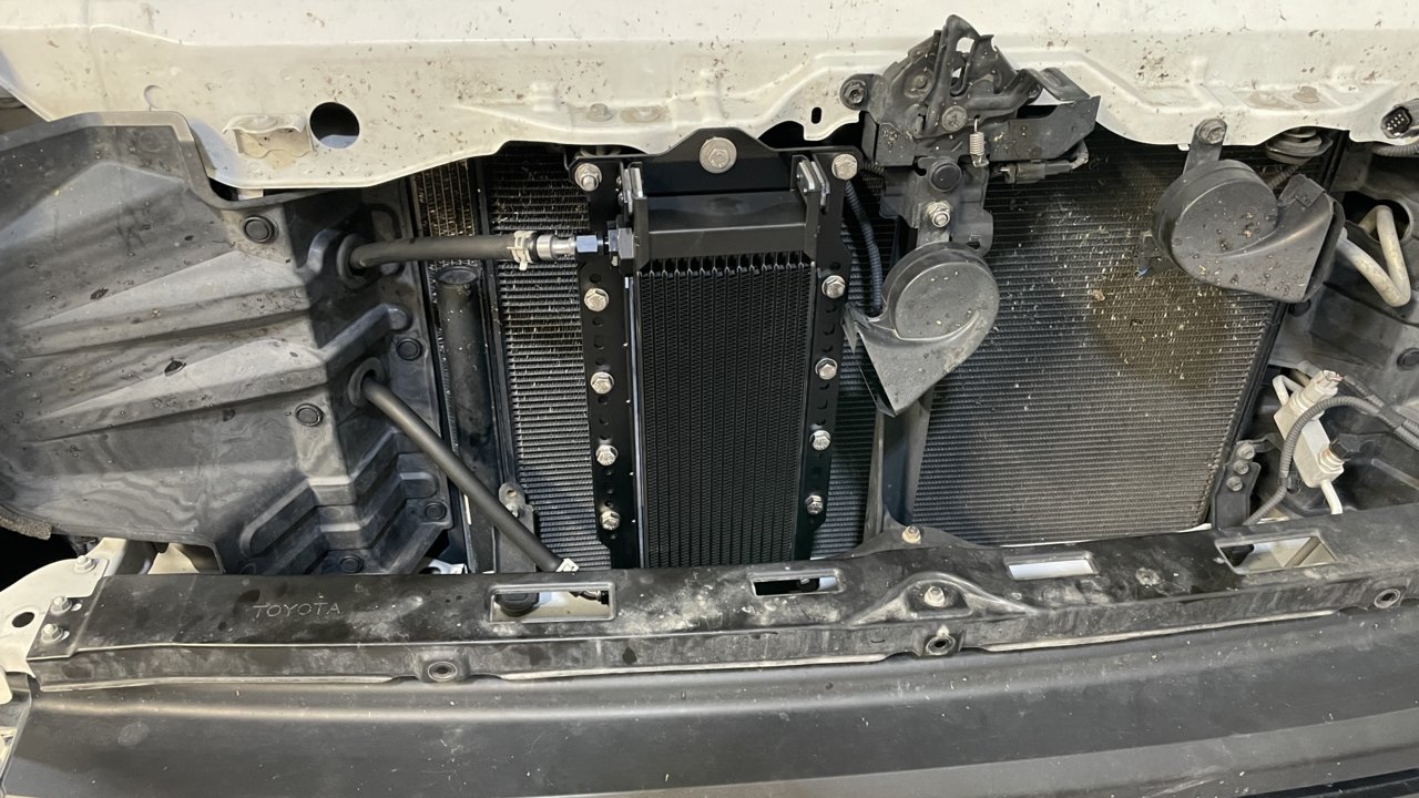

    My brother and I got mine installed yesterday. We couldn't really get the truck that high off of the ground which made it a bit more of a pain, but we got her done.

    Installed my kit yesterday...100 degrees....very easy install....took me probably 30 seconds with the hard lines so....I was in luck....now putting the skids and cat protection plate back on....that's another story...lol

    I have skid plates, (full cbi offroad), guess those will have to get removed I am guessing.
    on average how long do these installs take?
    I have a 2020 tundra crewmax on 35s and stock gears. In Texas summers I see 245-250 degrees.
    anyone with the 15 or 20 row kit experience over heating the engine after install?
    looking to regear and then do this kit after, hopefully the full 20 row kits are available by then.
  11. Jul 3, 2023 at 6:41 AM
    #1511
    bflooks
    bflooks New Member
    May 9, 2020
    #46273
    2,296
    Metrowest MA
    What is your question regarding overheating the engine after install?
    If based on location of the cooler, I can assure you that this is not a problem based on a few years of towing with the 15-row install, in ambient temps ranging from 45* to 102* F, running between 55 and 95% load on average. Coolant temps remain between 185 and 198.
    If based on something other than cooler location, I'm curious to hear about it.

    purely based on location and reduced? Airflow by stacking radiators.
    I would think if the 20 row caused problems the 15 row users would notice a change.
    I’m not a mechanic by trade, so I could be in the wrong ball park with this concern. You pretty much just convinced me it’s a non issue though.
    there are fan kits available for these radiators though as well.

    Took me 4 hours or so.....an hour was the skids...

    I'm not a mechanic, either. Here's what I think is at play (based on my experience):
    1) factory coolant system has a healthy margin built in, including to run the latest "puck" as only trans cooler (225-250*)
    2) the new trans cooler doesn't block all air flow, just reduces it some, over a relatively small area
    3) with the trans cooler, trans temps nearly match the coolant temp - this makes the "puck" operate at about 0% designed load, more than making up for the reduced airflow addressed in #2.

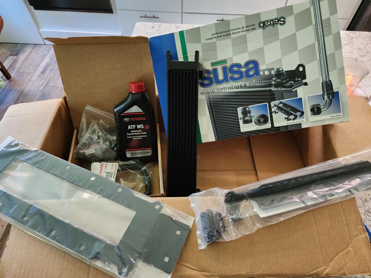

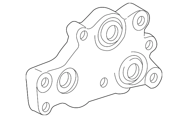

    Is there anyone who has installed this kit and wants to part ways with this spacer? It's what gets removed and replaced with the thermostat on the trans. I'm going to be trading my truck in and I would love to pull off the cooling system to sell separately, but like a dummy, I tossed this piece and Toyota wants over $300 for it.

    Monroe, CT
    2019 Tundra SR5 TRD Crew Max 4x4
    I think I still have it, I'll check when I get home from work.
