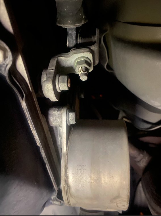

    I have a 2013 Sequoia with tow package. I have what I think was referred here as a hockey puck. Is that my "transmission cooler"???
    If so were I to get this kit do I need to replace that with the thermostat or can I route the lines to this cooler?
    Thanks in advance.

    Both the heat exchanger aka the hockey puck and the thermostat will be there working together to get the trans quickly up to the operating temperature and to keep it from overheating.

    I'm in Phoenix, it's at operating temp when I start it . :p (110 right now)
    When I do this do I use the lines to send the oil to the cooler?

    Does your passenger side look like this when you open the hood? E.g. the ATF cooler lines? If yes, you already have the external cooler.

    Unfortunately, nope.

    Looks like you have the thermostat. I believe you just need the plumbing and the cooler. If you don't already have it? You should in 2008

    I have a 2013 Sequoia.
    Thanks

    My bad but you still should have it in the 2013. You have the thermostat, are you sure there is no cooler? They stopped installing the coolers in the 2019+ Tundras.

    I tried to see where the lines from the puck go but it's impossible. Is there coolant or trans oil running through there? I also tried to see the thermostat behind it and I don't think it's there.

    I don't have the tech here at work to manipulate this photo and circle the area but the thermostat in this photo is right above the puck. It has little holes that you pass a pin through to pin the thermostat closed when checking the level. You definitely have the thermostat and I'm guessing you have a factory cooler. Your model year came with it.

    That was installed on my vehicle this week (post #721). e30cabrio doesn’t have one.

    Well shit I'm a moron! :rofl: Completely got both of your posts mixed up. So that still does not explain how a 2013 Sequoia doesn't have a trans cooler when it came with one from the factory.

    I don't have the bolt you have so don't have the thermostat.
    The video in post 707 shows I don't have it so now I know what I need to do. Thanks to wally & sd between the two of you I got what I need and I appreciate it!
    Off to spend $$$.

    Happy my confused dumbass could help you in some way. :D But still surprised you don't have one given it's a 2013.

    It's odd, my 2010 Crewmax has it. I checked to verify the Sequoia has the factory hitch & wiring. It's all 100% oem. I don't get it.
    I'll add it and it'll be fine.
    Thanks!
