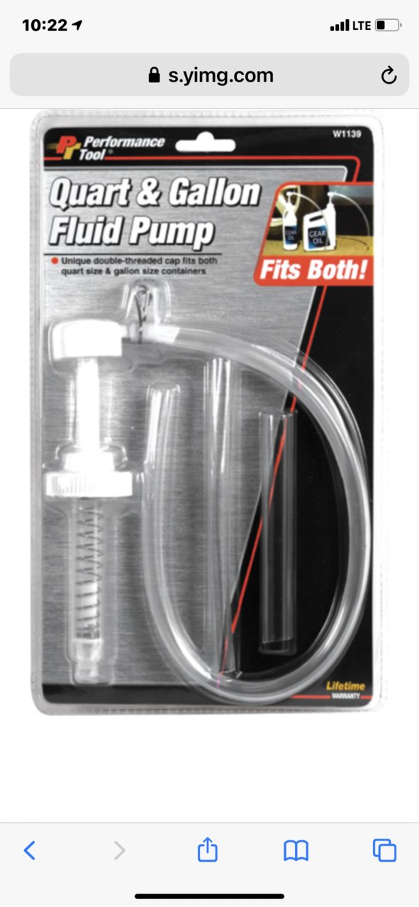

    I'm getting ready to start installing my kit. What did you guys use to service the fluid? Also, is the quart and a half all that needs to be added even after what will drain when the warmer is removed for the thermostat installation? Thanks.

    Thanks. What did you use to put the fluid in? The paper inst. said using a pump....

    Yes sir, I used a fluid pump...picked one up for like $6 or $7...makes it super easy to add

    If ya don’t have a pump you could also do as mentioned above, run a hose down through engine bay and fill from above with a funnel

    14CD334C-0356-4808-AD14-650FE6E1F876.jpg Get the quart/gallon if you go this way. The bottles I received had a larger opening then the old school quart bottles.

    Yes sir, agreed...that’s what I got as well...works perfectly

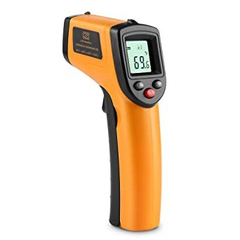

    So I have the install done, and went and bought the pump to service it. However my temp scanner won't be in until Monday or Tuesday. If I'm reading it right, you service with 1 and a half quarts and then pull the overflow plug in which you will lose about 1/2 quart after you cycle through the gears and get between the temperature range? So can I just service 1 quart and be good until the obd scanner comes in?

    1 quart will get you very close to where the level needs to be until your scanner arrives. I recommend you do the level check prior to utilizing your truck but in your case you already have the cooler installed.

    Why don't you just use a temp gun on the oil pan?

    Bc i have no idea where it is or if it still works.
