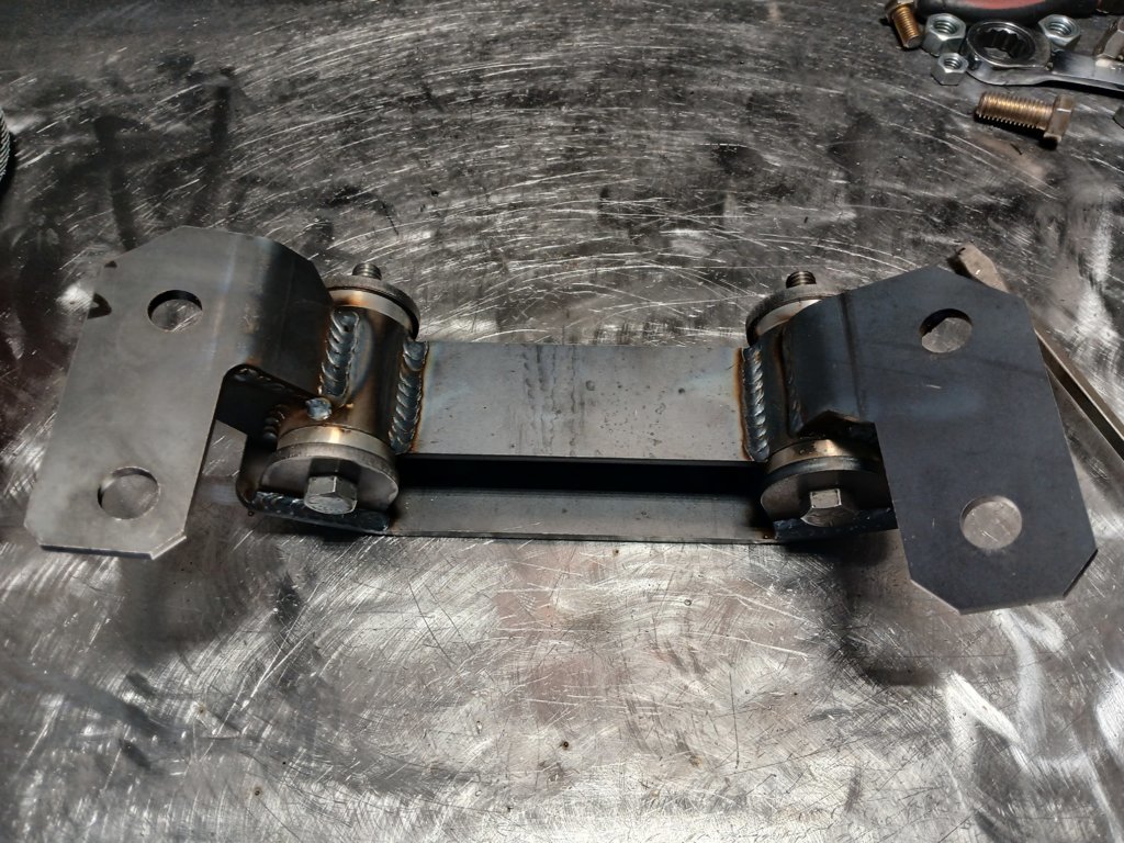

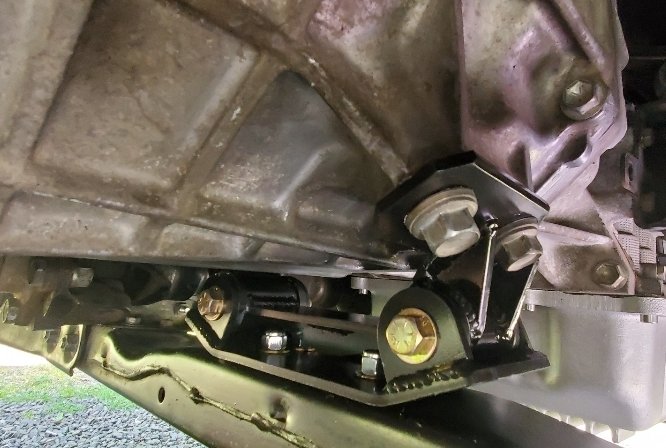

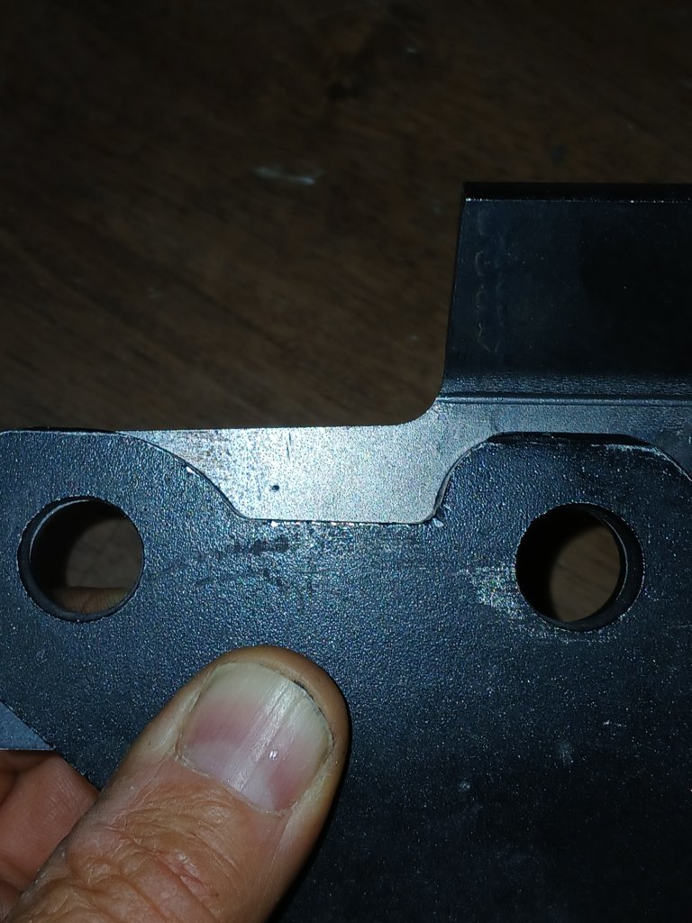

    Got the transmission mount installed. Had a minor tolerance issue that was easily resolved with the mounting holes to trans. @Bonzen will address for final production. I opted to get the mount unpainted to speed up test fit. I should of waited a bit for paint to cure. Ryan is a super nice guy to deal with. Will be taking it out for a test drive but probably won't feel any difference just cruising.

    Did you have to redrill the trans side mount hole?

    @Bonzen said he'll be welding them up this weekend after making a few adjustments. Trans mount was an easy swap. Definitely a driveway install. Torqued transfer case to mount 52ft lbs and crossmember to mount at 25ft lbs. I tightened the bushing mounts until they met the bushing then a two turns more. Just don't over tighten them.
    I was able to jack rear transfer case up to clear the OEM centering stud. I didn't have to loosen the front solid engine mounts or remove the crossmember.

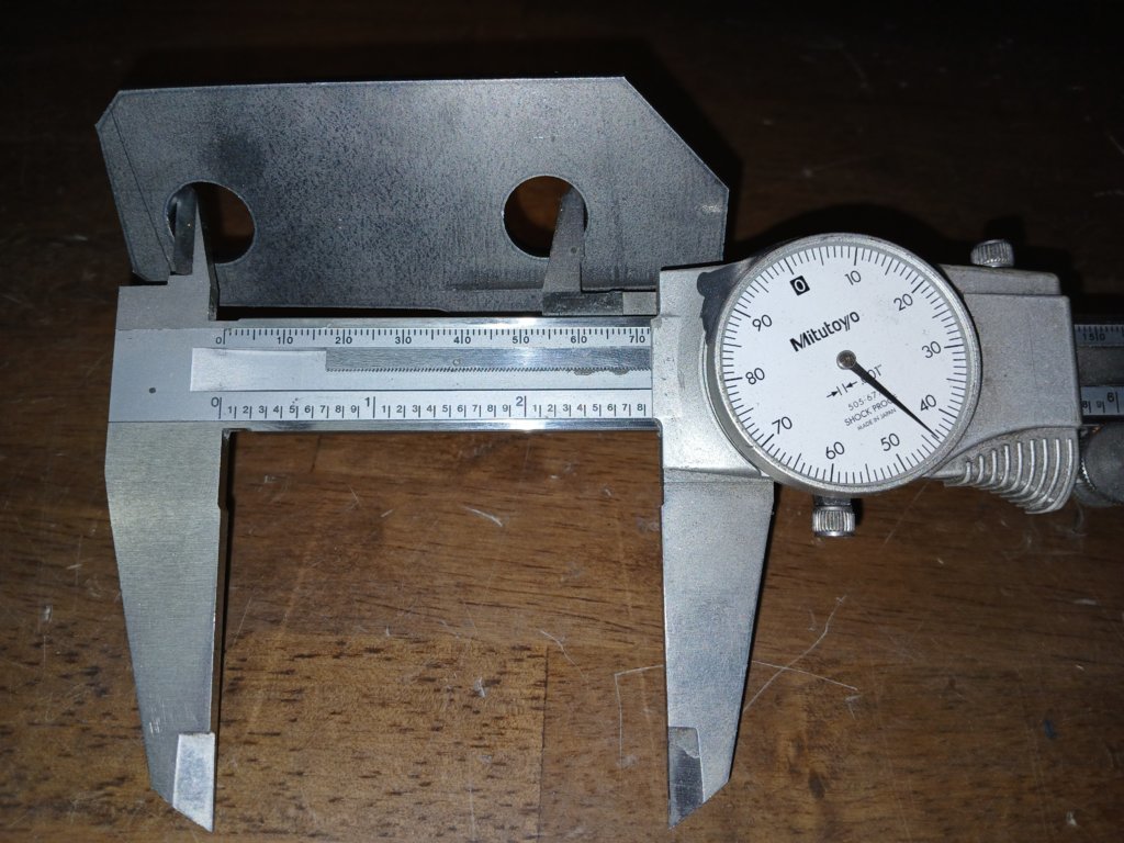

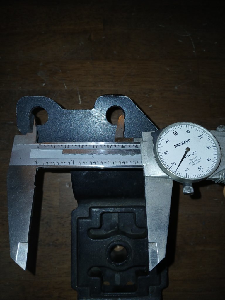

    The driver's side rear mount hole need to adjusted. I sent him where it wasn't lining up.
    I only needed to dress it up with a die grinder at the 2 o'clock position. He slotted the crossmember bolt holes to compensate for any dimensional irregularities.

    Went out for a drive and you can feel the drive train just a little bit. Not much more than just engine mounts. Although I couldn't really tell any changes with the engine mounts, except an increase in performance.
    I believe this will be a good performance upgrade combined with the solid engine mounts. I did a few WOT pulls and it "felt" solid and just hooked up nicely.
    Now for those that are jumping and crawling I see no downsides to this swap.

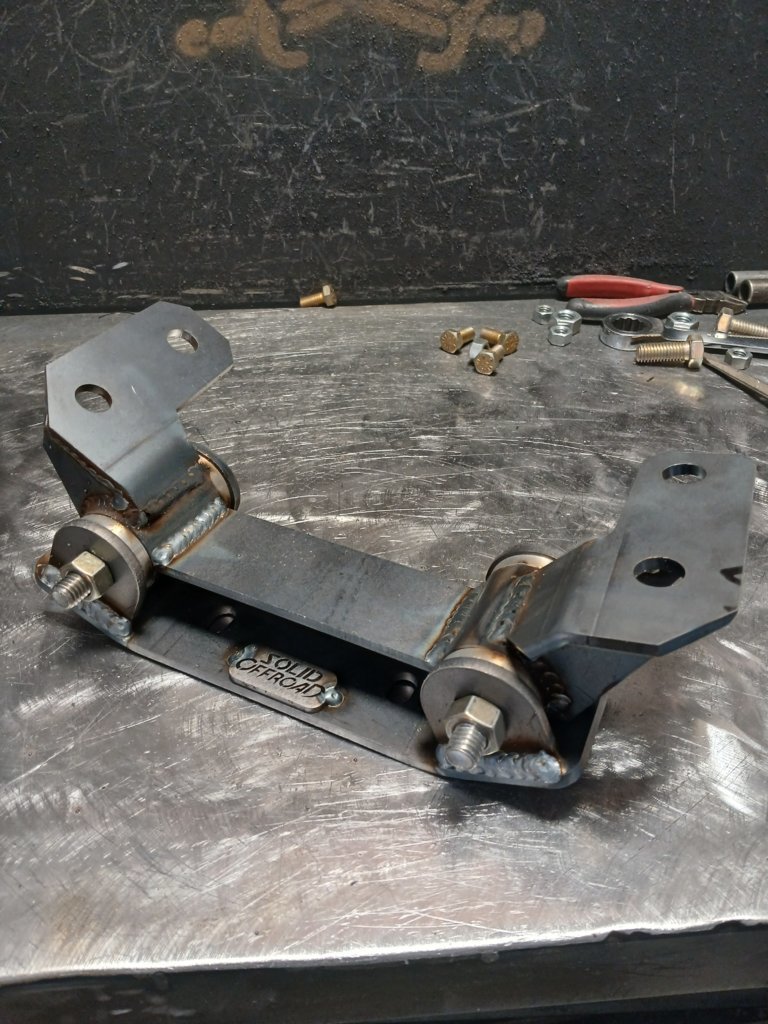

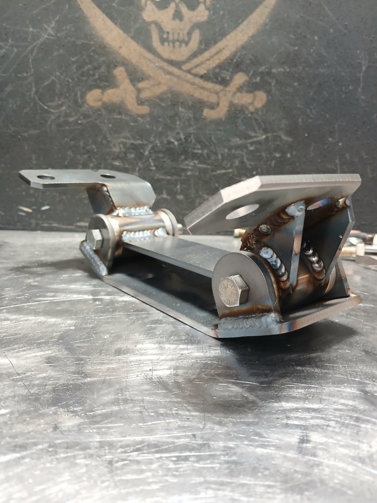

    You nailed it dude, I am stoked to have such a competent guy to do the first install.
    So the 2 trans housing mount holes on the OE part & my laser cut part ended up being off by basically .022" definitely within "off road truck weld specs" but I think the bigger issue was the whole tab may have weld warped a tiny bit which compounded the issue making the holes seem more off than they really were. Something I will address on subsequent kits. Its a long arm, with multiple gussets to support it so there is a lot of heat thrown into it. Glad @Mdl handled it no problem.
    This is a challenging part to reverse engineer & build. The angles and tolerances are tight, the whole thing is very compact and "flat" its difficult to even get the gun in many spots to weld it up, especially working around the weld fixture structure. But I'm definitely happy how it came out:thumbsup:
