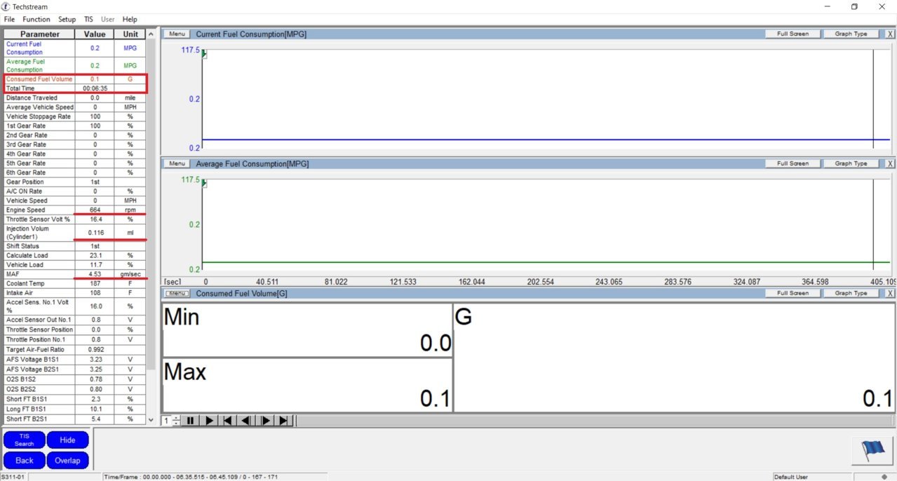

    I got out my laptop with a copy of Techstream and started data logging on my truck through Toyotas software.
    Here is the log screen in Techstream. I logged Coolant Temp, RPM, Injector Fuel Volume in Cylinder #1, Injector Port time, and MAF
    Here is the same data in a spreadsheet. I logged 5 minutes worth of data and show the avg value for each at the bottom of the list. This photo shows the last 15 or so seconds of data. As you can see almost all values are stable at this point.
    The truck was warmed up at normal operating temp when I started logging. Coolant temp was 187 the entire time. RPM 600-700 Rpm.
    Fuel flow into cylinder #1 was pretty steady at 0.110 ml per second. That would mean 0.880 ml per second across all 8 cylinders every second.
    52.8 Ml per Minute
    3168 Ml per Hour which equates to 0.85 Gallons per Hour
    I have read online that the factory fuel injectors are in the range of 370 CC/min. This would mean at idle and 0.85 gallons per hour the injectors are operating at 1.7% of total capacity.
    I found a second source to try to verify the data further. Using the fuel consumption logger inside Techstream I logged that it took 6 minutes and 35 seconds at warmed up idle to burn 0.1 gallons of gas. This was at the same 600-700 Rpm and about 0.115 ml per second on Injector #1.
    If it takes 6 minutes 35 seconds to burn 0.10 gallons then total gallons burned in an hour would be about 0.90 Gallons per hour very close to the number above including minimal error.

    A few other things to note from my newly logged data.
    On startup and a cold engine the truck defiantly burns 1.6 - 2.0 gallons per hour, however as the truck starts to warm up this number comes down significantly to stabilize about 0.80 gal/hr. I know at 3 minutes into warmup the truck was down to 1.1 gallons per hour. (This was from an earlier log today when the truck was started cold)
    The other interesting thing was that using the MAF values as others have suggested in the post doesn't seem to give accurate results. However I’m not entirely sure as to why yet.
    My MAF was steady at 4.77 Gm/Sec, according to the math calculations this would be about 0.40 gallons per hour. However the raw data from the fuel injector is telling me the real number is significantly higher than this. Seems most people with Scangauge are calculating fuel burn based on MAF values and I am not convinced this is giving accurate results.

    0.90 US gallons is 3.42 liters. Which also was my post 1 napkin math. :eek2:

    Can you send the TSE file? I have Techstream too and I’m curious to see. Technically, maf*afr is correct… the ECM judges injection amount based on maf and afr.
