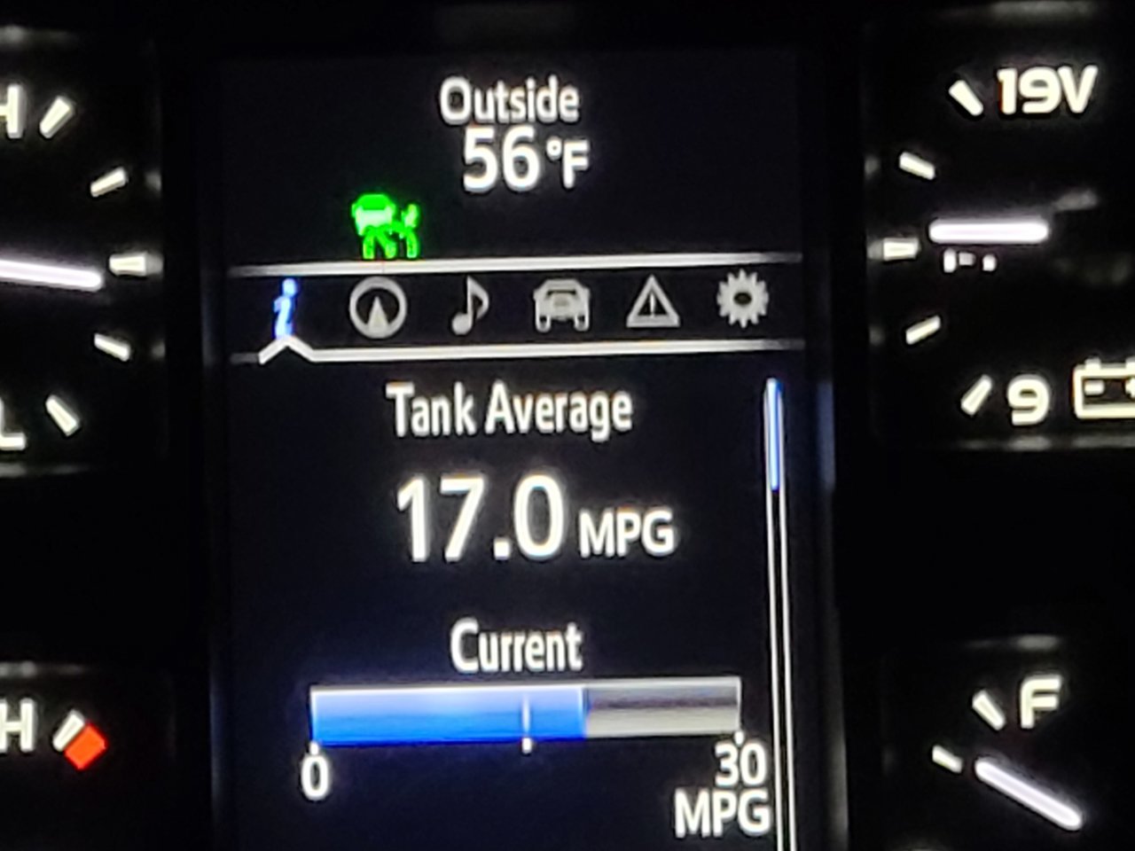

    10-4 I wish I could be so calm about it. And maybe its just my engine coming into its prime cause my gas mileage has gone up a bit in the last few months, but this thing gets fuggingg LOUD sometimes just like that video. Sounds like its gonna slowly rip its self apart...

    How did you get your mpg up to 17.0? Just curious, since the best I see is 14.5 mixed city, with some highway. Maybe that’s my issue.

    Gassed up right off the freeway and took it ez getting back on, set the cruise so the tack was little over 2k and rode it.

    I used to get 17 in mine when I was doing mostly highway cruising at 70 delivering stuff far away. Now I do more city driving and its 14.5. I also put a heavy front bumper and bigger tires. It makes a big difference.
