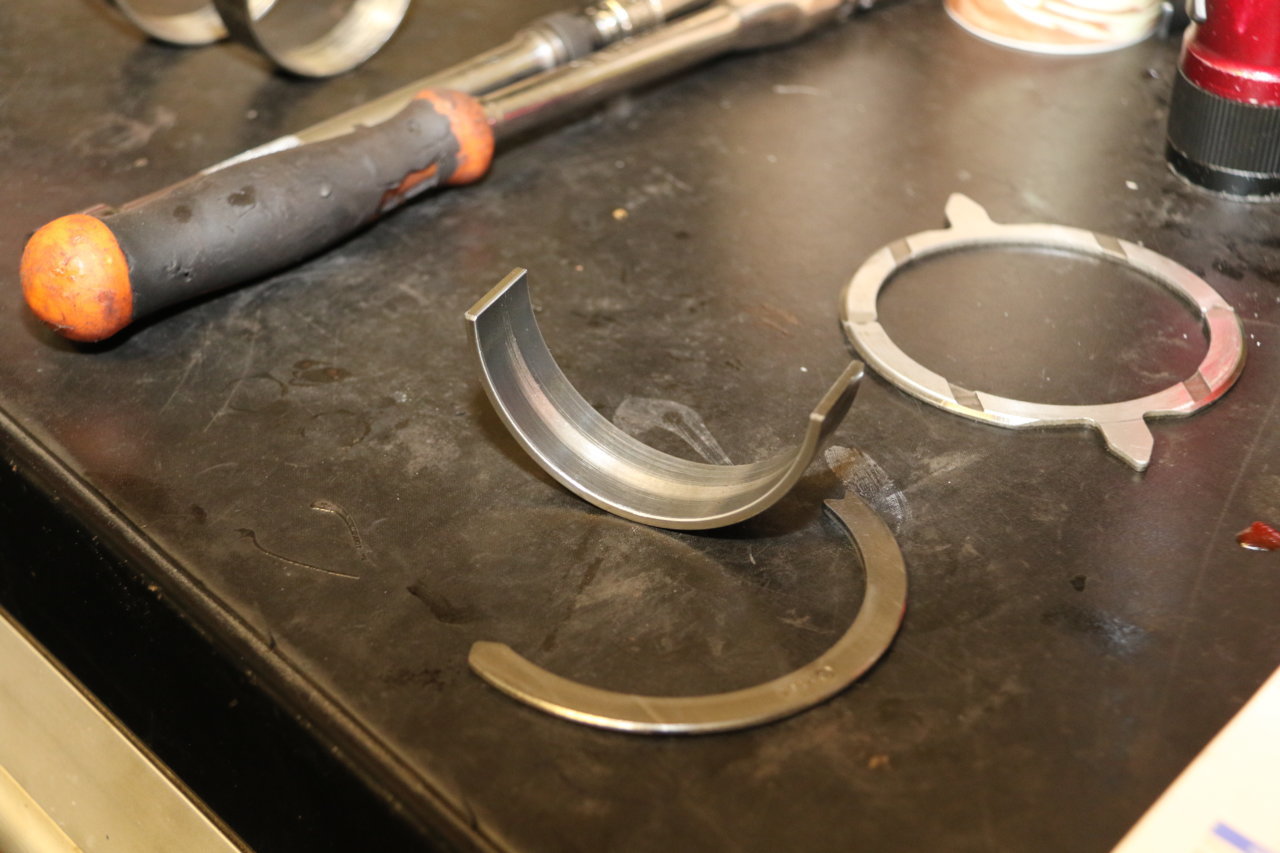

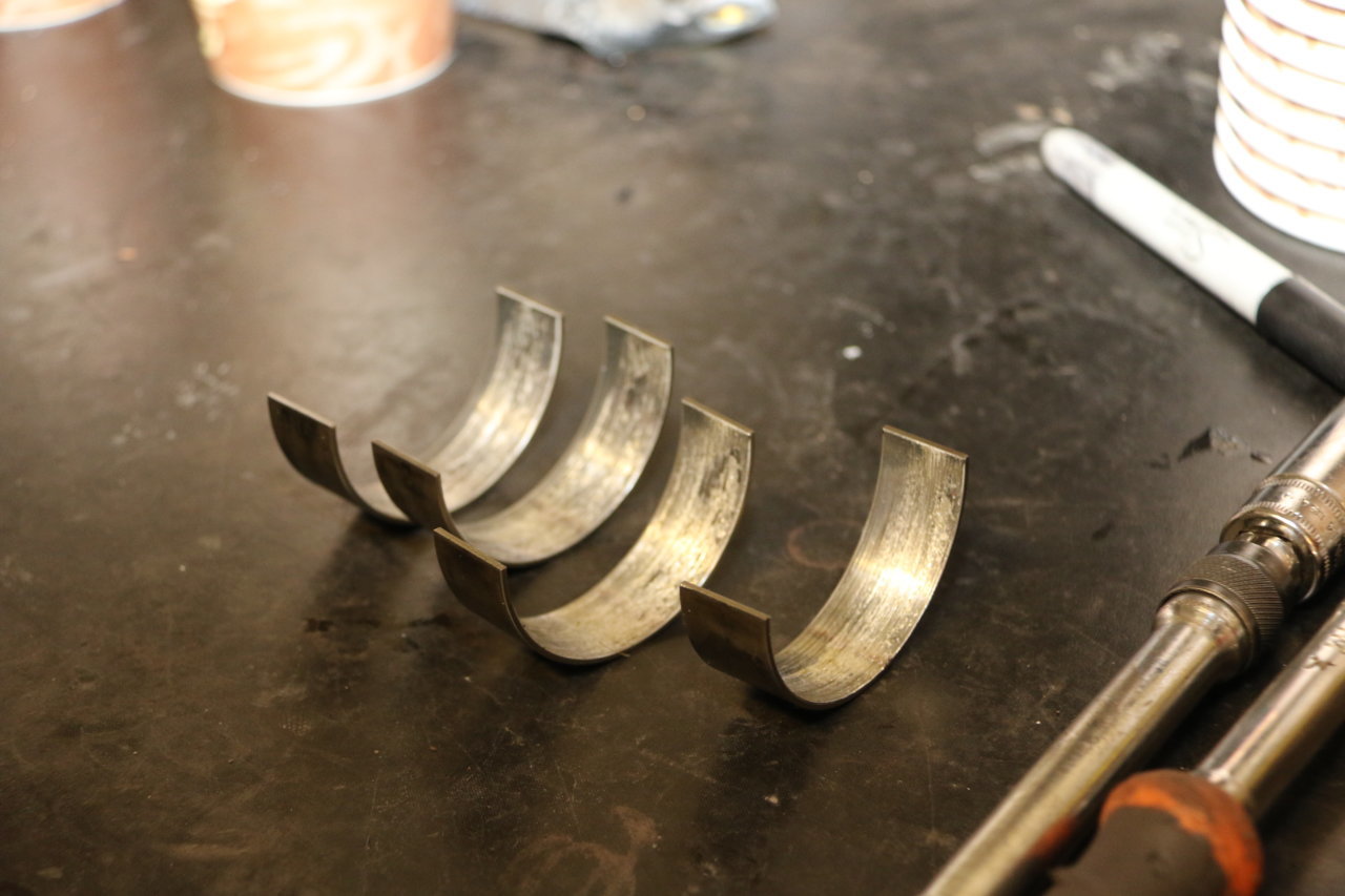

    I had a 5.7 bearing failure at 96K. Unexplained. Always dealer maintained and always ontime. Synthetic since birth.
    Toyota assisted with the replacement due to having made a dozen purchases over the years... Below are bearings that failied - Center main and related rods looked starved for oil. This is the factory fresh 2010 block that replaced the failed 2008.....It can happen....

    2008_Sequoia_with_96k_bearing_failures
    The photo includes the Center Main Bearing and the thrust bearing that also failed....

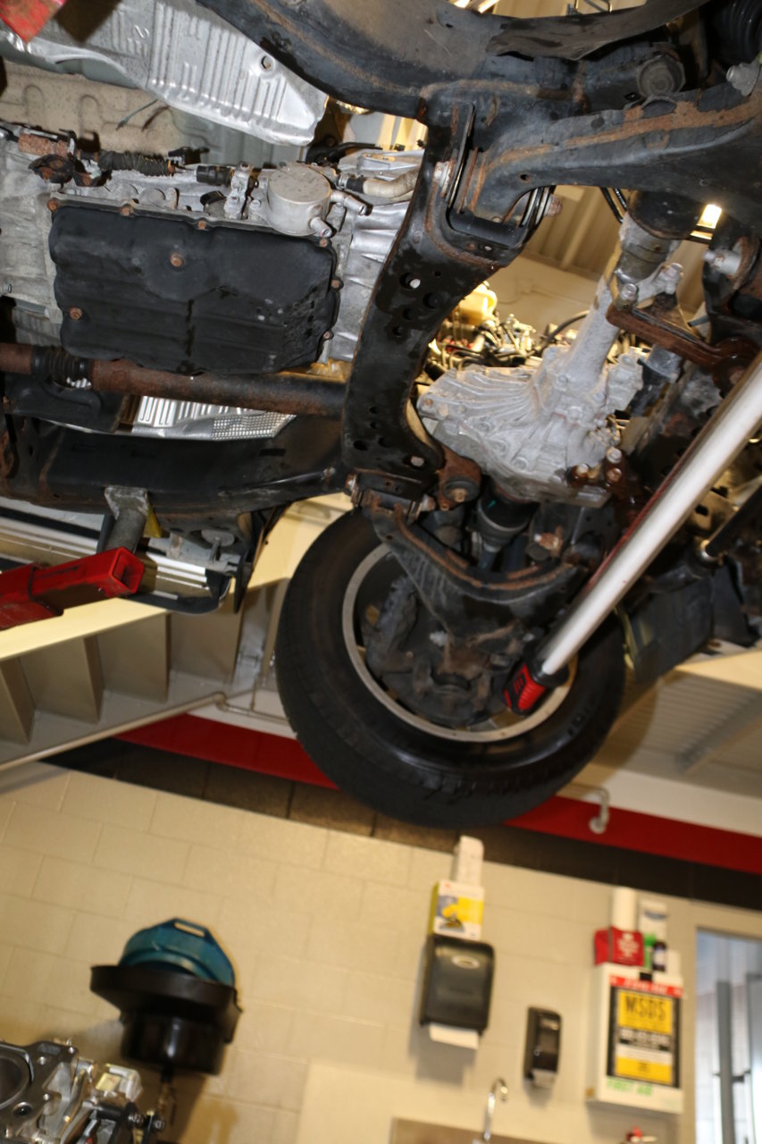

    Something you never want to see from underneath - nothing under the hood!!!

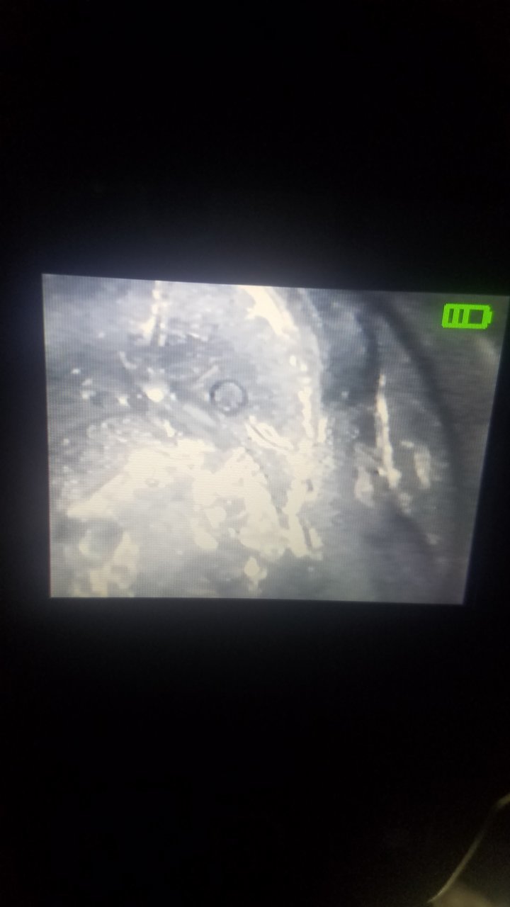

    My tundra just dropped a valve in the #1 cylinder and I'm sure it's going to head a new engine. Plan on pulling the head and assessing the damage. The inspection cam picture shows a gnarly mess.

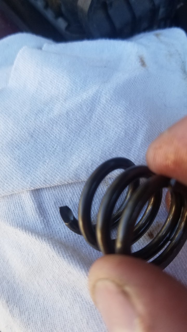

    Pulled the drivers side valve cover off and found the broken spring bent valve and found the roller rocker. Still searching for the spring cap and locks....
    Good news is my mechanic says that a used head and new piston wont be near the same cost...
