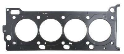

    2 adjacent misfiring cylinders is about as classic of a sign for HG leak as you get. Coolant in the holes hamper the ability for them to ignite. The thinnest part of the gasket is always between two holes.
    Car care nut says they changed gasket material starting for MY 2014.
    ETA pic of 3UR head gasket

    #53
    phabej
    phabej New Member
    Oct 22, 2018
    #20840
    1,283
    Washington
    2018 Platnium
    #53
    rocketdog[OP] and 2mchfun like this.
  24. Aug 21, 2025 at 1:43 PM
    #54
    AZBoatHauler
    Aug 13, 2019
    #34576
    9,330
    So.Arizona
    #54
