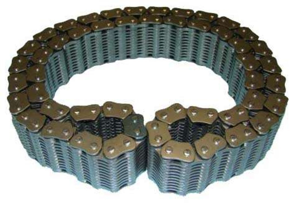

    WOW. Never seen one that big. I would still argue that each individual pin in that chain could cause a total failure and a forging flaw leaving a crack will make it very weak.

    That is one insane looking chain! Why does it look so intense compared to a timing chain?

    The driveshafts and axles are a lot heavier than the cams and valve train
