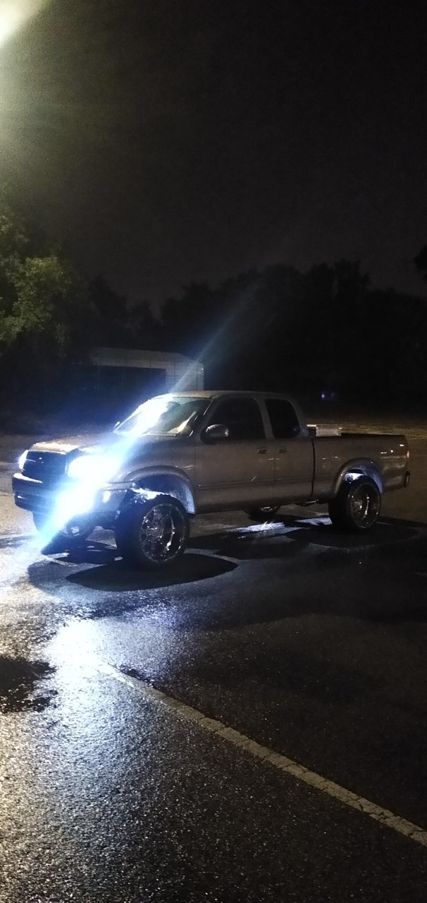

    The website rough country says its not made for it but i thought that your could use 4wd on the 2wds just not sure. A guy i know has that same setup i was talking about the 3 inch spacer and extended upper on a lifted strut and his seems to ride pretty good from what i was told. but his is a 4wd 2006 extendede camso im sure there are some differences in it. I know my rock light setup in the pic sucks lol IMG_20230527_221645446.jpg

    If that's what you're looking for, I can't help. Suburban highschool kid mall crawling bro-dozer isn't what most folks on here aim for. :D
    Seriously though, check those links I posted. The last link I provided, that guy basically did what you just mentioned with your buddy's mall crawler. Spacers + Rough Country lift. Mixing spacers with lifts is a big no-no as it is, unless you really know what you're doing, and it seems most people don't. Spacers amplify lift, whether your trucks articulation can handle the extra lift or not. That's when shit gets bent during everyday events, like hitting a pothole.
