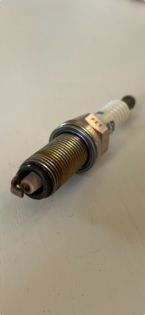

    Plugs needing to be changed at 40K shows how dirty these new engines must run. I changed my original plugs on my 5.7 at 120K and they looked a lot cleaner.

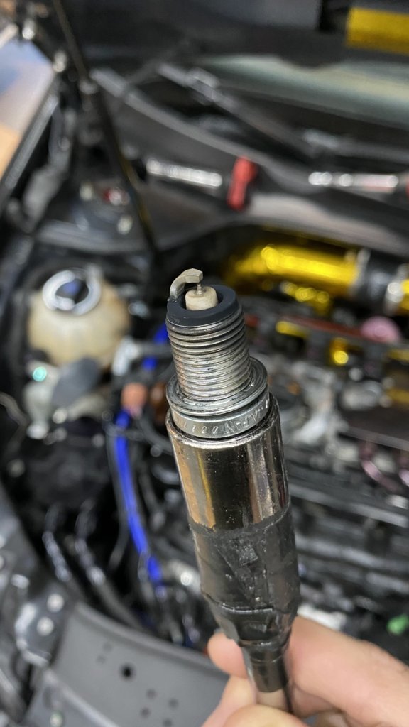

    Plugs have always been a consumable. They just didn't get consumed as fast in the past due to lower cylinder pressures and temperatures.
    DI/FI engines consume at a significantly higher rate than the older NA units.
    I religiously changed mine in my GTi every 10k miles, but granted that was running methanol injection and 26psi of boost on 2.0l 4cyl.
    Now, one thing these trucks have going for them is consistent IATs from the Air to water intercooler/heat exchanger.
    That will keep combustion temperatures down, but these are not meant for 80-100k changes like the older style engines were.
    This is an example of a properly tuned DI engine plug. Notice the white mark on the strap and electrode. Complete combustion, clean and not running hot (lean).
    I'd be willing to bet these trucks could stand to use a step colder plug.

    Still a lot more carbon on the end of that plug compared to mine at 120K.
    Give me port injection all day long for longevity.

    DI definitely has some drawbacks, but the nice thing with these engines is the dual injection. Port and DI.
    Carbon isn't that big of a deal, especially if you drive the vehicle hard and get the cylinder temps up to operating spec with top-tier fuel.
    The ceramic coloration is what has me concerned. Too hot IMO.
