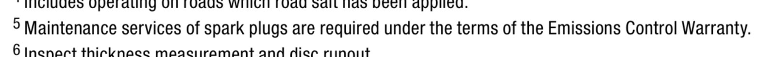

    Almost certainly. From the warranty and maintenance manual:
    I agree 100% that changing Iridium plugs at 40k would be like changing synthetic oil at 3000 miles. It’s throwing good money away. But do you risk getting into a pissing match with Toyota with a warranty claim?

    i,don’t care about the emissions warranty. I’m more concerned about the engine warranty.
