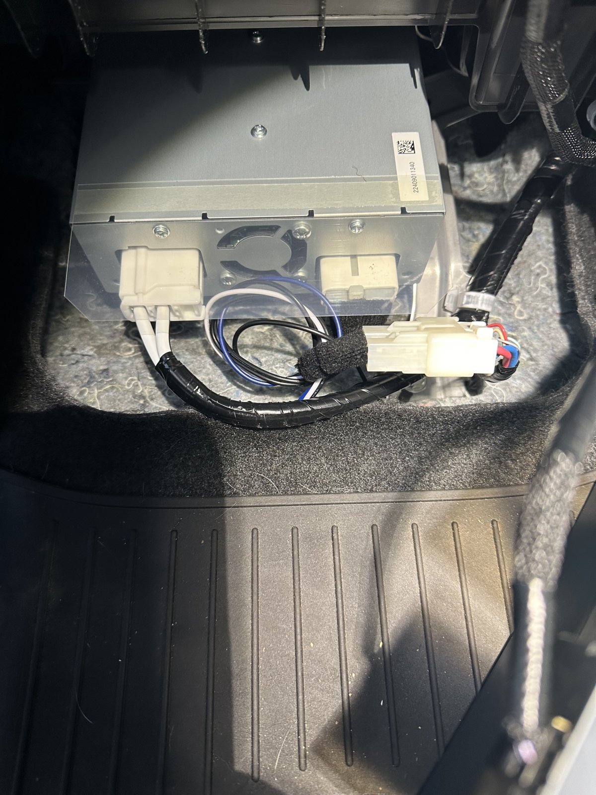

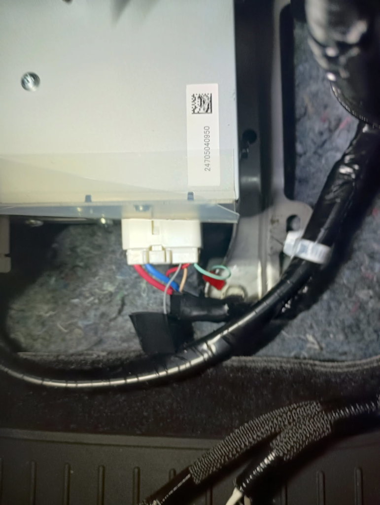

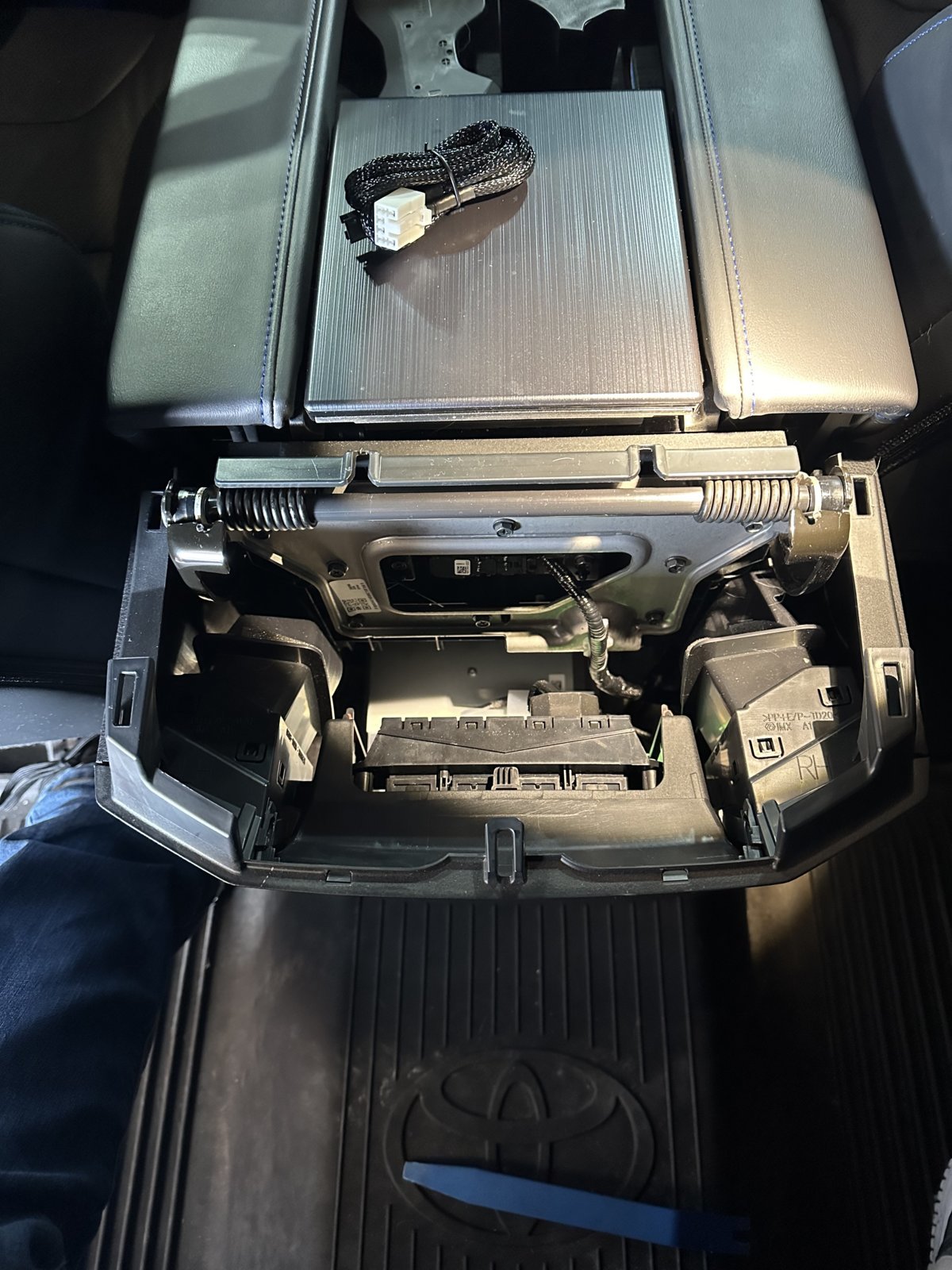

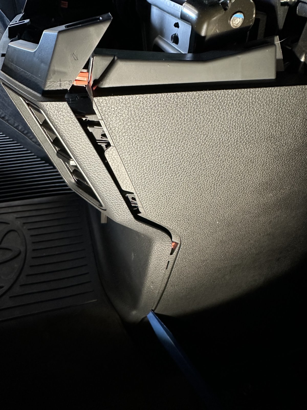

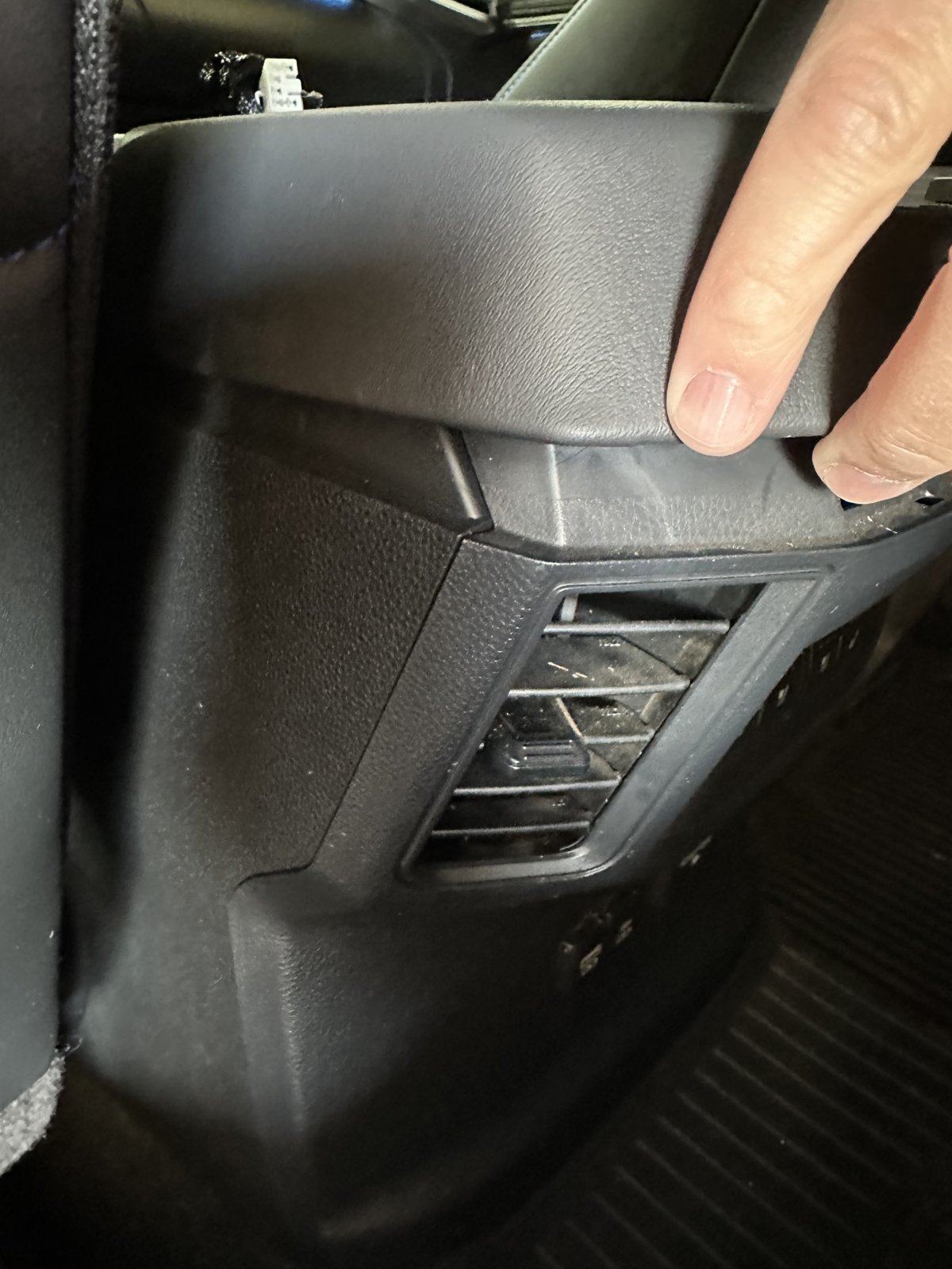

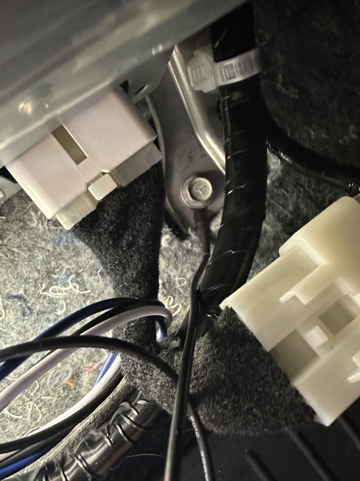

  10. Nov 18, 2023 at 10:37 AM
    #70
    Tundra23PNW
    Tundra23PNW New Member
    Jan 14, 2023
    #90225
    5
    Brian
    23 Tundra Platinum
    3-1" Wescott Lift (temporary) RRW RR5-H 17X8.5 0 offset HYBRID BEADLOCK Toyo Open Country RT Trail 35x12.5 r17 Toyota Pro Grill CaliRaised Ditch Lights and brackets

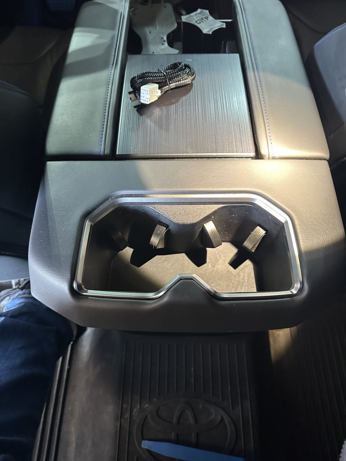

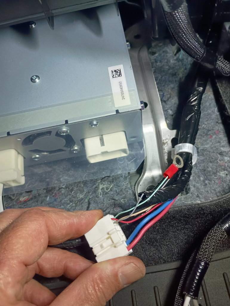

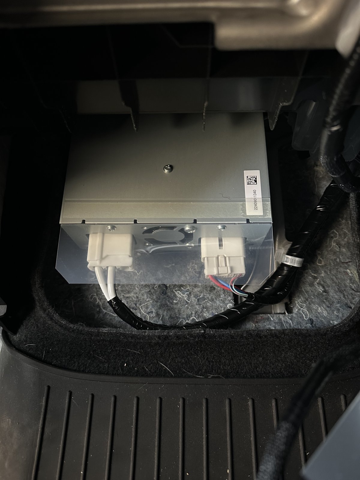

    I wanted to try the CaliRaised 400w anytime harness that they have listed for the Tacoma. I did some research and the harness and wire placement is the same as the Tundra. Just has different colors but they are the same pin locations. Got the kit in and had it installed in about 15min. The rear console cupholder pulls right up and the console cover that faces the rear seats pulls straight out. The right side has a wire harness attached so it won’t pull out very far so don’t pull to hard. I did not disconnect it and it was fine. You have tons of room to access the harness from the inverter. Plug the new harness into the factory harness and connect the wire with the eyelet to a ground and slap it back together. Tested it with my cooler in the back and it stays on and runs now when driving. Hope this helps anyone looking to do the mod. It was less than $40 for the kit
    IMG_1896.jpg IMG_1898.jpg IMG_1895.jpg IMG_1894.jpg IMG_1886.jpg IMG_1890.jpg IMG_1892.jpg

    I just ordered it as well and will probably install it this week. Sounds like nobody has had issues so far.

    Installed mine about 4 weeks ago, running strong with about 260W peak draw in the bed (60W fridge + 200W charging a portable battery).
    Got my kit from https://caliraisedled.com/products/400w-anytime-wiring-harness
    Other shops don't seem to have stock anymore.
    I wanted to make my own harness but turns out the connectors are a bit hard to source & expensive, (The part# are mentioned in the tacoma thread https://www.tacomaworld.com/threads...tap-400-watts-3-33-amps-mod-connector.732423/) and I didn't want to tap the oem wiring :rolleyes:. Plus I'd have to get new crimping tools for that, the $45 harness started to look like a good deal.
    Installation was a bit tricky for me maybe just on my truck. The wiring in the console are very snug, I had to unplug the temp sensor (?) which itself was a huge pain.
    Also I had difficulty accessing the bolt on the inverter rack because the DC input wire was too snug and was in the way. I connect the ground terminal directly to the inverter casing at the end, with the screw on one corner of the fan.

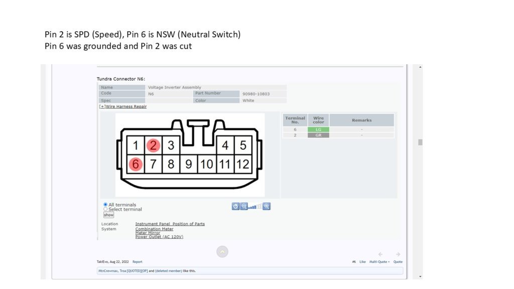

    I can not confirm that this is the fix .... but this is how I read it

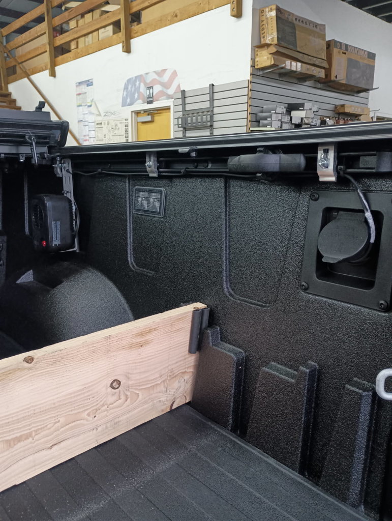

    I went for it.
    Grounded the inverter side of the light green wire #6
    and cut the grey wire #2.
    The inverter is working but I didn't test the output.
    I mounted a small 200w 120v heater to keep my ski gear a bit warmer during the drive up.
    (nothing worse than putting on ice cold ski boots and your feet stay cold all day)
    It's working initially but we'll see how it goes.

    For some reason the 200w heater is turning off. I'll need to see if it's truck related or the heater is just a $18 turd.
    So the jury is still out on whether or not this mod works.
