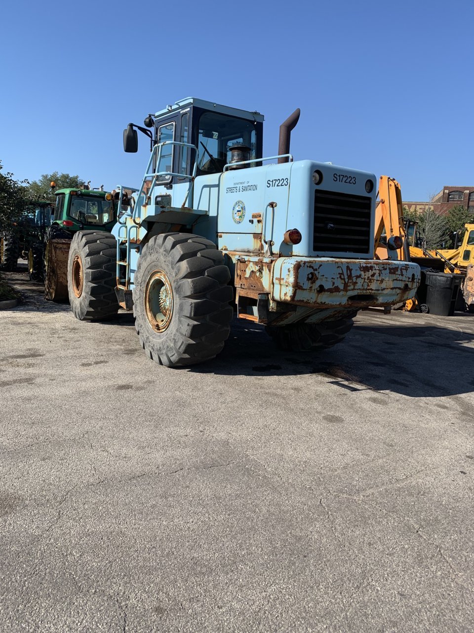

    That’s what I work on now not as complicated as cars but everything super heavy and dirty and so much fun to drive it’s like I’m little kid again super excited about my new career I guess you can say
