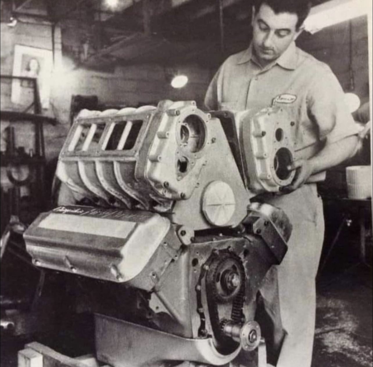

    2 under driven m90's might be better than an overdriven m90.
    Run 4 literbike throttlebodies through each blower, ethenol or methenol spray in the plenum to help cool the hot side. And slightly tweaked rocker arms to open one of the intake valves right before the other to induce swirl.
    widening the lobe separation angle usually flattens the torque curve (or maybe opposite) but a wide flat torque curve would do good with an auto trans and towing. Yea, a turbo would be better, but if you use 2 different blowers (or the blowers with different pulleys) it would have a warble. And that would be cool to flutter through a cars & coffee.
