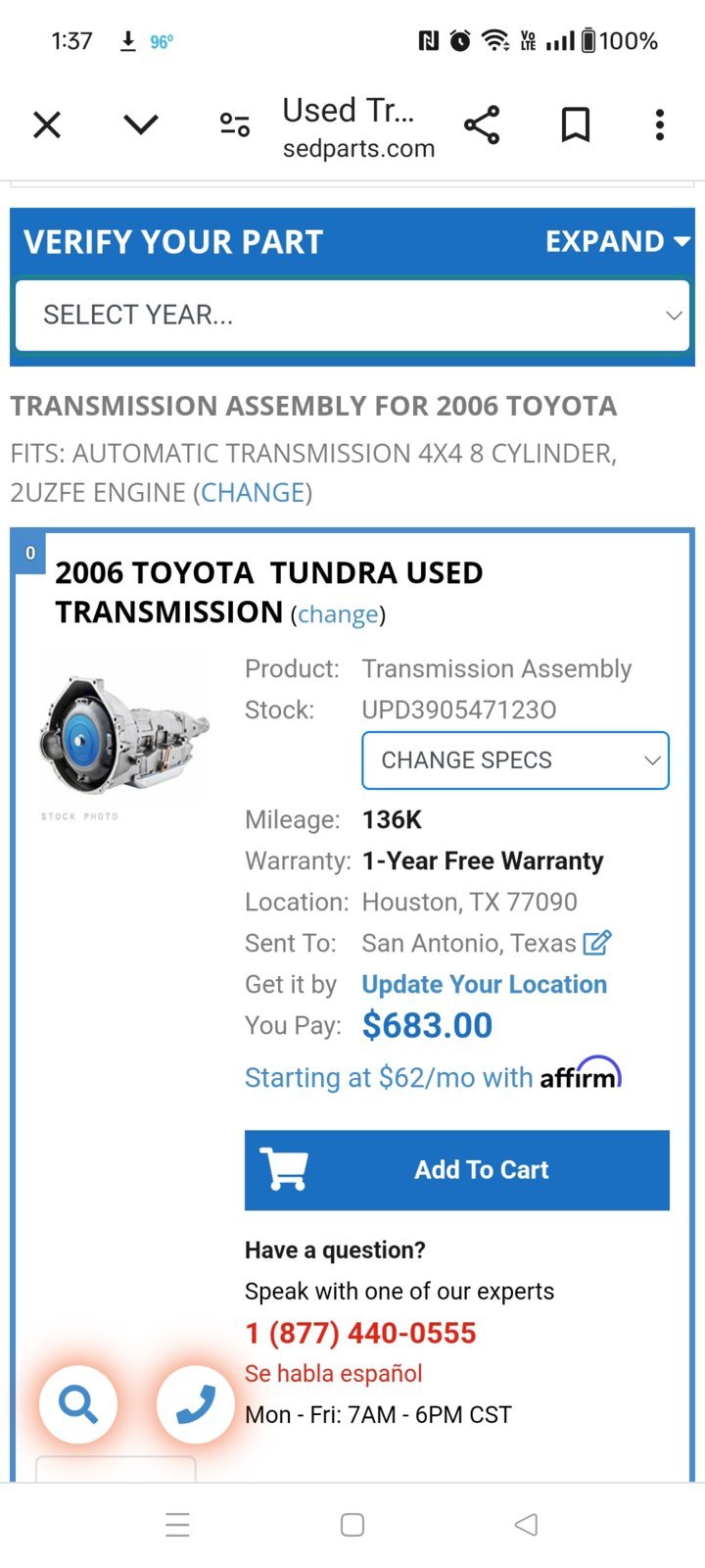

    It will bolt up with a ls430 bellhousing and a 4.6l tundra transmission. Ecu is a different question

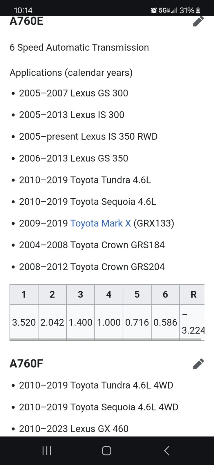

    Yea. Bellhousing can unbolt. The LS430 used the a760 in its final years. The 4.6l 2nd gen tundras use the a760 in 4x4 form. So take the bell from the ls430 and the transmission from a 2nd gen 4.6 tundra and you have a transmission that should mostly bolt up (unkown on the mount situation) technically with some fuckery and a LS430 engine harness an ls430 ecu could run the whole setup. What this gains you is a transmission with these same 1-5 as the a750. But an extra overdrive for 6th

    What I think he's saying is the 4.6's use the a760f and not the e. Or visa versa. Whichever is the 4x4 trans. It's either E or F
    not that they were all 4x4 but they used the corresponding trans for it.

    E is 2wd, F is 4wd
    What you're saying makes it sound like the 4.6 Tundras had a different Aisin trans altogether, if they were 2wd. Could be...
    But I know back in the day, Toyota would give you the same automatic transmission but for 2wd or 4wd in their trucks.
    (IE: A340E vs A340F or A750E vs A750F)

    nah. I'm saying they all used a760 F-boys
    But I just re-read it and now it seems he means to say "4.6 4x4 tundras use the a760" so that's why the LS430 bell housing fits on the a760

    Your assumption can be quickly dis-proven by googling 2WD 4.6 Tundra...
