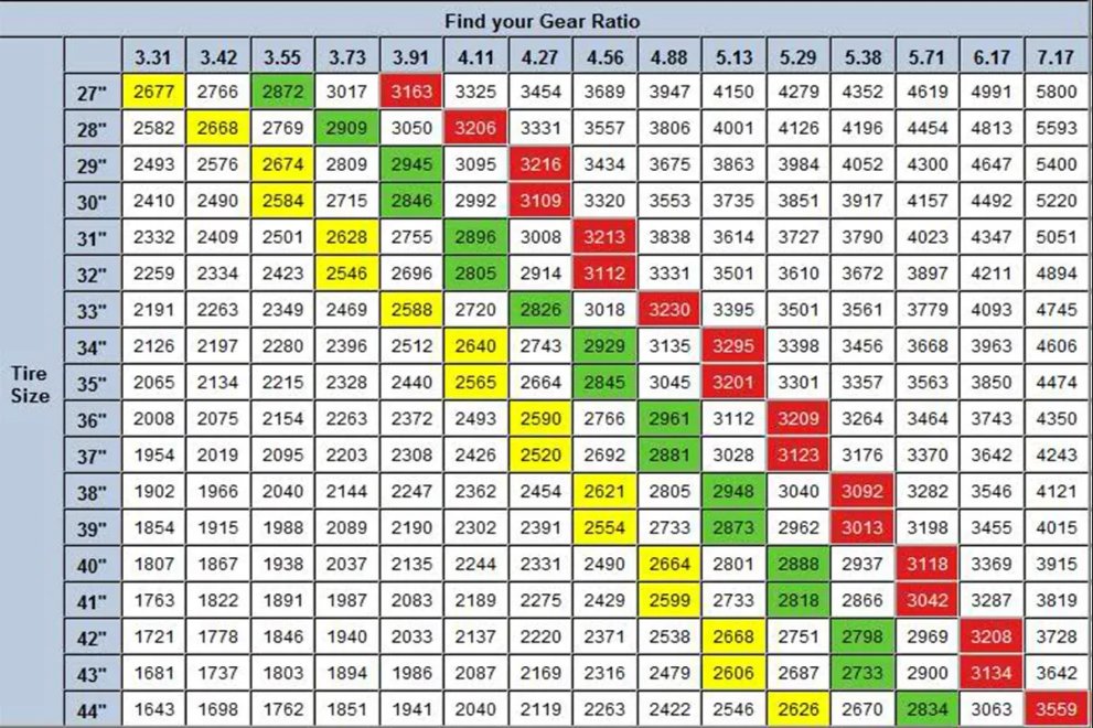

    According to this chart, you were better off with 4.10s if you were looking for optimum gas mileage.

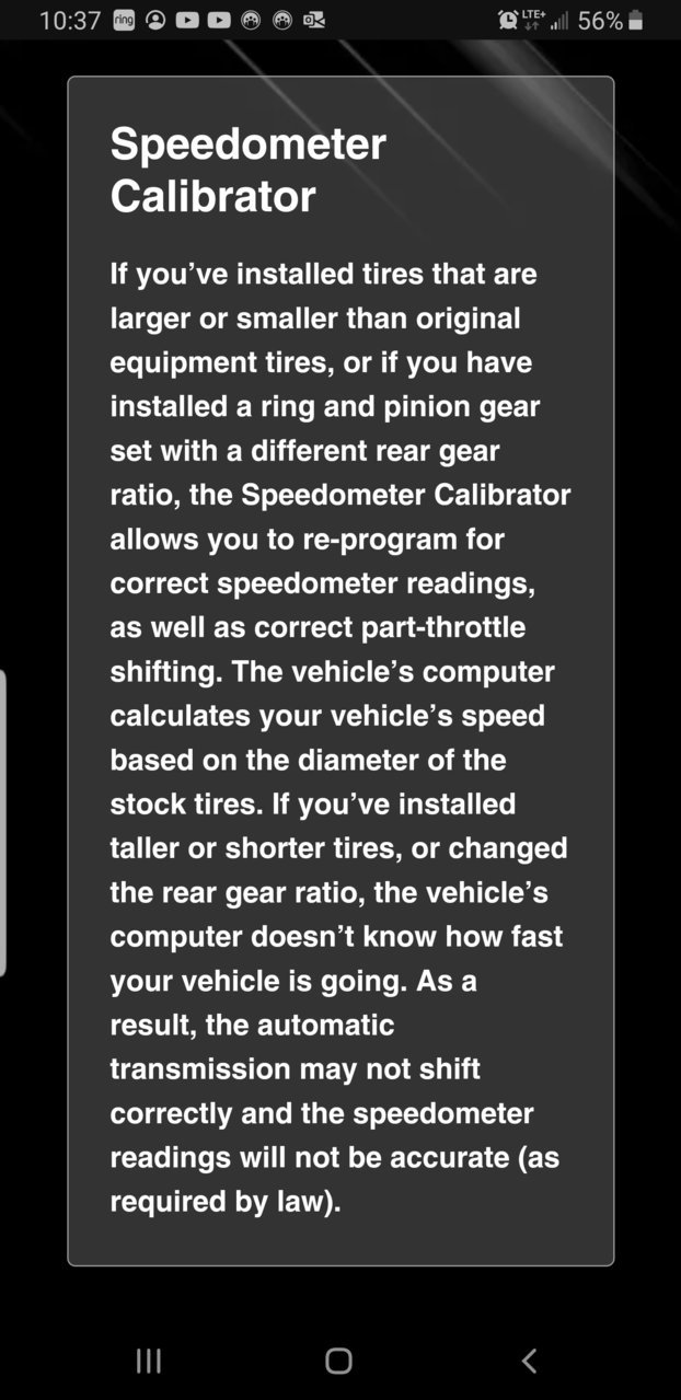

    No speedo calibrator adjusts throttle. That's a Pedal Commander sorta thing.

    This is what it says

    I'm aware of what they say as I have one, but real-world experience, I haven't felt a difference. I'm also tuned and I have a Commander (I didn't change any settings before or after the calibrator installation). The tune very well may have accommodated shift point changes.

    I went based off of the chart that was on revolution gears website and that one had 4.88 as best for daily drivers. It might need a tune as i have noticed it lingers on gears a little longer than before
