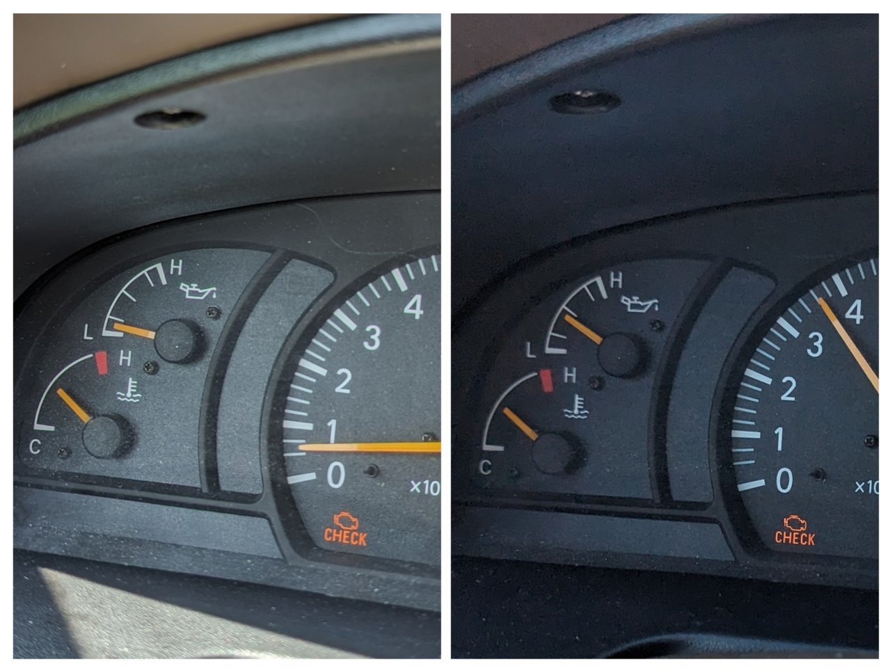

    Here is idle vs 3500rpm in my '04 w/ synthetic 5w30 oil.

    Money light is on.
    Mustanley[QUOTED] likes this.

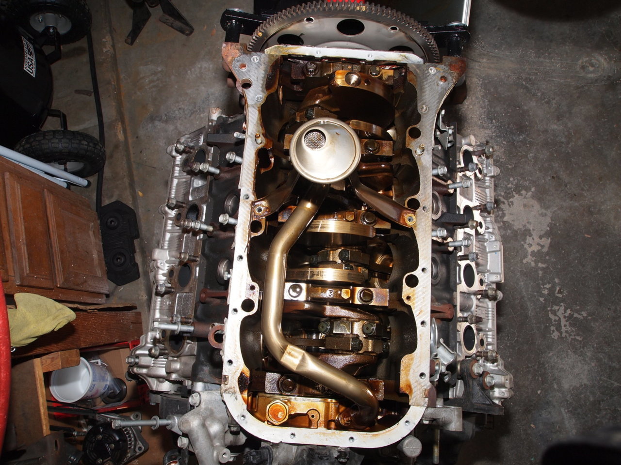

    Lack of noise is the only reason I'm not thinking anything is clogged. If you had oil attrition, I'd expect extra chatter. It's not exclusive but I think it's a telling sign, no noise is good news.
    Generally speaking, a lot of (if not most?) modern engines use a pickup tube system. My favorite, the GenIII GM small blocks, and your V8 2UZ-FE are no different.
    If you are really, truly concerned there is no oil uptake happening, I guess the first thing I'd do is proactively get whatever gaskets were needed to pop the oil pan off, so you can get access to look at and potentially clear the oil pickup tube. The pickup tube usually has some form of screen in it. That screen can - theoretically - get clogged up. Here's what I mean, here's a picture of a 2UZ-FE / 4.7L V8 from the underside, with the oil pan off, and the bottom-end exposed. Clearly shows the pickup tube that sumps oil out of the pan. Maybe you have a slew of sludge down there, or, say, someone had something plastic get broken up and it's clogging the screen? This isn't to discount any number of other ports and crap that could get clogged in the block and heads. But ... this is the one you can easily get to and check. Note from the pickup, with the screen that could potentially be clogged, the pip then routes off at 7 o'clock, to pump oil up into the top-end. And actually, now that I look at it, I'm not 100% sure you can get to the pickup just by removing the oil pan. Let me find an exploded diagram. (EDIT : Indeed, I don't think you can, see my next reply)

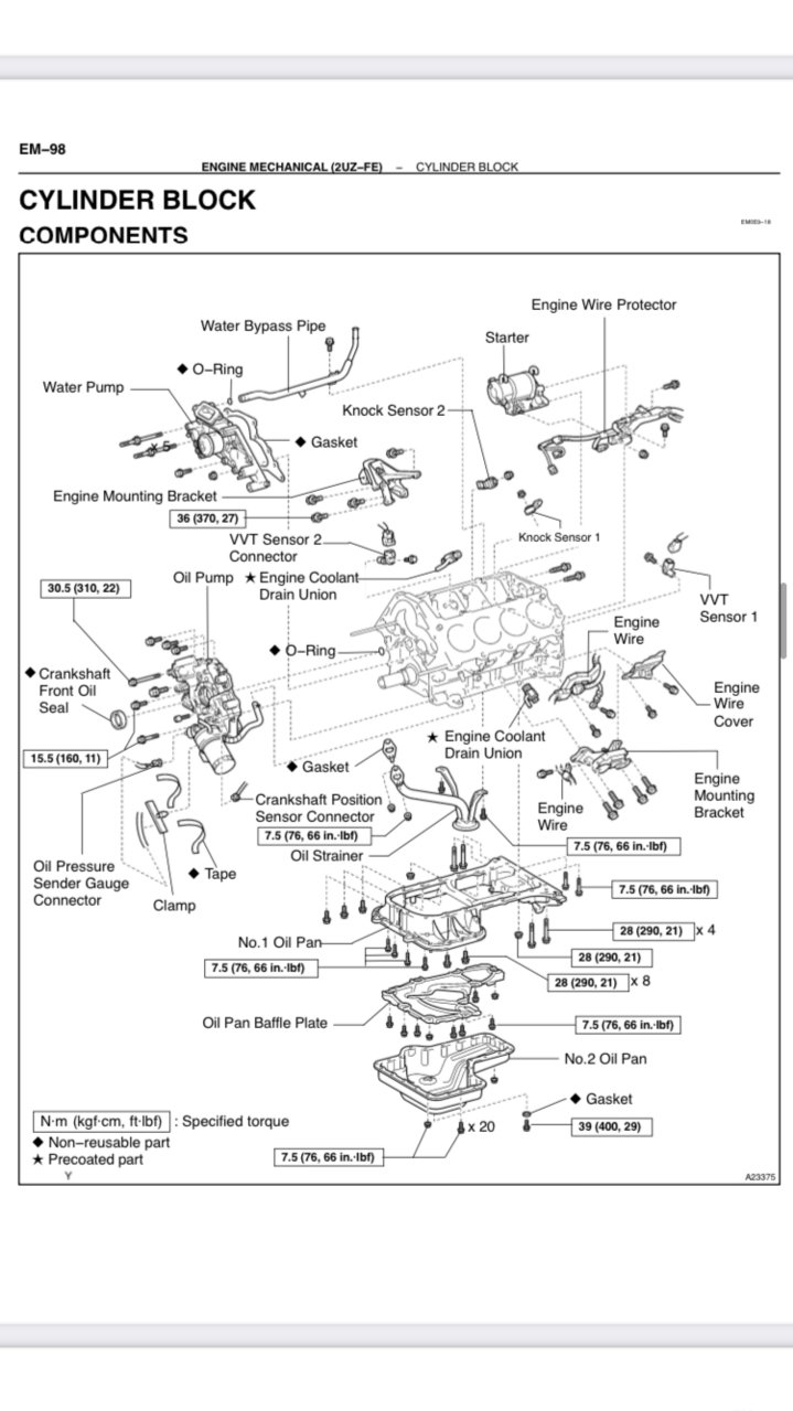

    Yeah, looks like you may not had access to the pickup tube just by removing "oil pain #2"

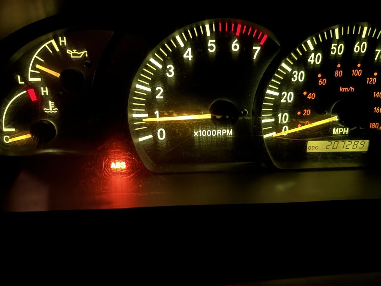

    In an ongoing quest to see good oil pressure, after one oil change with a quality oil and quality filter, the gauge does work. However, after driving a while the pressure drops and at idle it shows nothing. This photo added is 1st start, 6:00am, 56 degrees outside.
    I'm starting to wonder if this engine has an oil pump issue? Or if the engine just doesn't put out due to age?
    I have seen oil pumps and bearings slowly wearing out on american V8s showing that cause low oil pressure.

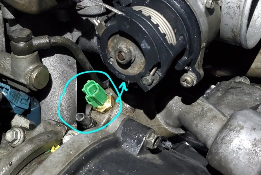

    Unless it’s early brain wise, the bottom gauge showing nothing is your coolant temp. The one above it is your Oil gauge, which has what I view as normal reading at idle.
    IMHO you have a ECT(engine coolant temp) senor circuit issue.
    For 2000....
    W 3(grey connector) Water Temp. Sender....for idiot gauge
    E 2(green connector) Engine Coolant Temp. Sensor....input to ECM

    I believe he is following up trying to show that the oil pressure gauge is working after a cold start but then stated that after warmup it drops to nothing at idle.

    Perhaps but at idle @900 RPM means engine is warm, he has nothing for water temp….not normal, simply another issue to address.

    That's at a cold start with 56 degrees ambient temp.

    Yes I am aware of that but with that temp, engine RPM would be muchhh higher, not a idle RPM reading.
    Perhaps @usedpartsprince can clarify and despense with speculation

    -i wouldn’t trust a oil pressure gauge with a mechanical sender in any vehicle. The pressure lines are very well know to fatigue and rupture. When they do it’s a HUGE mess. And that huge mess means you’re loosing oil fast. An electrical sending unit is waaaay more safe.
    -i don’t think having air inside the oil pressure sending line is that big of a deal. Yes, it would be in a hydraulic brake lines where it’s around 1500 psi, but if you’re engine has around 60psi, i wouldn’t think it would sway the results very much. At least it didn’t when i had a mechanical gauge in my old ford. Drive the truck around for a while and the air will work its way out of the line.
    -your tundra’s oil pressure gauge reading look normal to me. It’s the exact same as mine, and it sounds like it’s the exact same as others.
    -a simple fix for your Henny Penny sky is falling concern would be to remove the gauge cluster, remove the stock oil pressure gauge from the back, carefully pry the needle off its post, then reposition it an additional 1/4 of the way up further on the post...

    I'm a gear head for many years now by the way, this is at first startup, no temp reading at that point.
    Just not sure what would keep oil pressure from reading better all the time?
    Oil pressure is better after an oil change, and seems to run well.
    I'm not liking the gauge not showing better pressure all the time.

    I don't find it confidence inspiring either. I can only assume that that's how our Tundra oil pressure gauges are from the factory? Or perhaps the gauge just wears out over time? If the concern is there, maybe just do a preliminary oil pressure test with a brand name high quality oil pressure gauge. Compare that reading to the OEM gauge and make a mental note of where it's at on the oil pressure scale. I guess there's nothing wrong with the ubiquitous 2-1/16" triple gauge mount that gets screwed under the dash.
