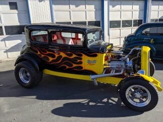

    I mentioned that my neighbor who was going to advise me as I did the timing belt, etc., was a classic hot rod builder and I have a few pics of his current projects. I hope no one objects to me uploading them here.
