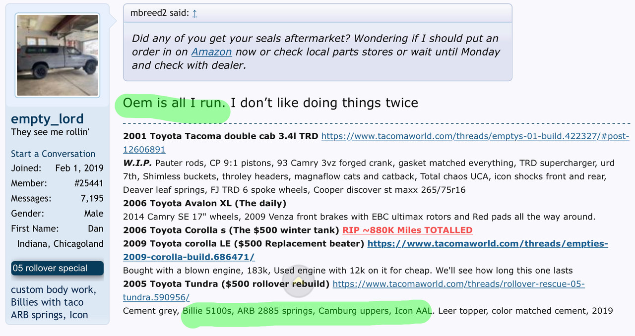

    Context is everything. EL is always pretty big on recommending and using OEM for engine stuff. There are very few people (I'm one of them) who run full-OEM on everything, and even I can't say "everything", I couldn't tolerate OEM rear view mirror and sound system. But as far as engine? Will stay OEM. Tranny? OEM. Wheels? May keep OEM. Suspension? I may upgrade it for something better, we'll see. But generally speaking, OEM OEM OEM, even if it's not for my specific make/model.

    I'm an OEM kinda guy as well - I even say so right under my name. Go ahead, look! :thumbsup:
    I did upgrade my rearview mirror with one to work with a backup camera but otherwise I'm pretty sure I'm all OEM (as I think thru it).
    Ah, I have Husky floor liners but that's it...unless you count the GTA car kit that connects to my OEM head unit.
    Well crap, this is depressing...I'm a poser :(

    Nothing ive done has been oem. For 20 years ive either upgraded or swapped in the cheapness. But i guess jy parts are oem, so im a poser, too.

    I mean, trying to source good OEM floor mats is damn near impossible, Toyota discontinued. In fact, a lot of OEM non-critical parts are being discontinued.
    I missed out on a nice set of black Access Cab floor mats several months ago on eBay, they closed around $70. I saw the seller re-listed the exact same set not long after - guess that wasn't enough $$ for their taste - and they re-sold north of $120 if I recall.
    But yeah, I dunno if I'd call anyone a poser over keeping things fashionably stock. The upgrades you've done added functionality to what is practically the most perfect truck ever made. It's the size of a Taco with a V8, comfortable, and well-optioned. Don't make em like this anymore!

    Oem for engine related or bearings and the such. Aftermarket for shocks, springs, etc is fine..
    What was being quoted was about axle seals if i remember right, I’ve had some really shitty aftermarkets that didn’t seal for more than a couple miles

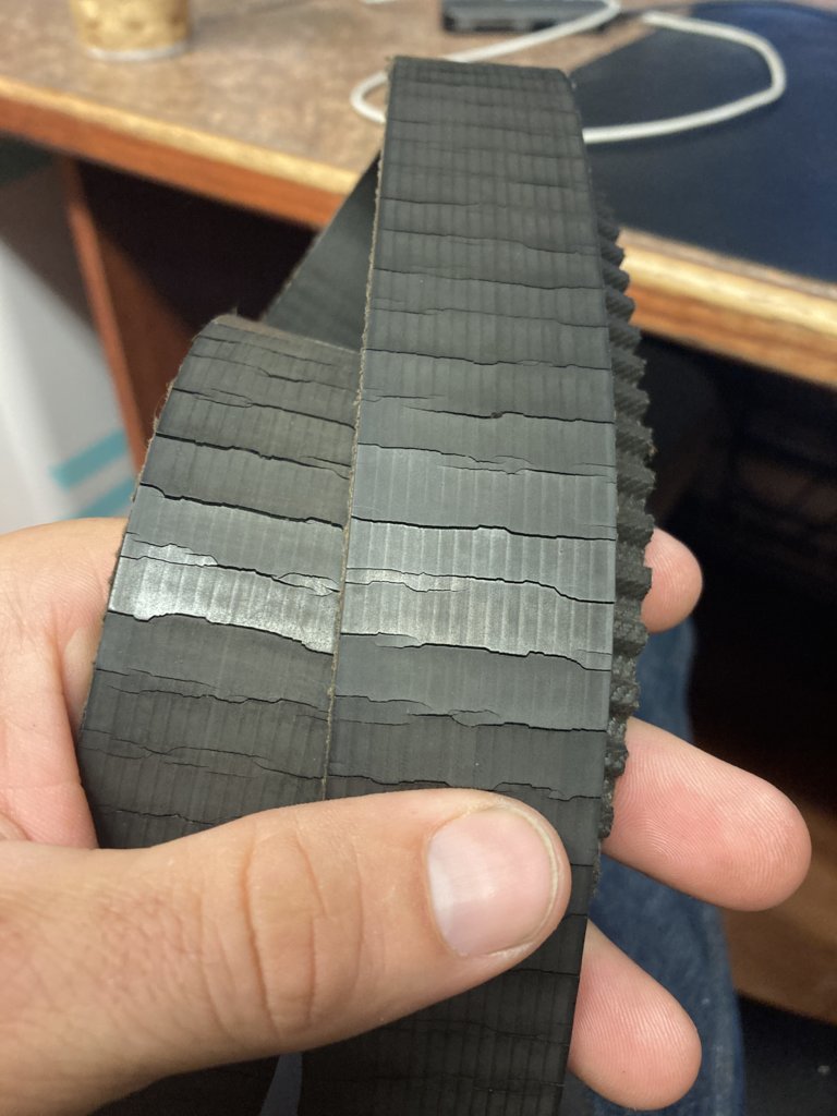

    This is my 2004 4.7 original timing belt after 212,xxx miles (had not broken). Just in case anyone is curious about lifespan. I'm glad I changed it :D

    #297
    bmf4069
    bmf4069 Captain wtf
    Sep 1, 2018
    #18880
    9,984
    Beau
    TX
    02 AC sr5 4wd v8
    Eh, it coulda gone another 100k.
    J/K, good save dude. That's pretty bad.
    Edit: And in a T4R no less! We need pics. We like pics.

    shifty`
    Jun 20, 2020
    #48239
    31,487
    ATL
    '06 AC Limited V8/4WD
    Here I was prepared to say, "hell yeah, that's a testament to OEM quality right there!", and maybe it is, but brother, looking at that belt, I think you need to go buy a few lotter tickets cause you're a lucky SOB.
    (If you win, please help pay off my house, I've only got a couple years left on the mortgage :rofl: )
