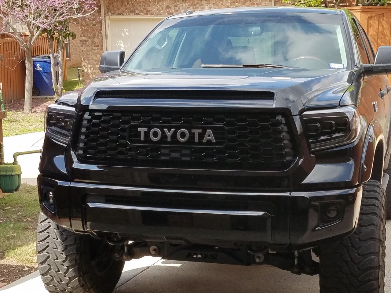

    I'm a fan of the BDS 7" lift. On my 2012 Tundra I ran 35" tires and with my 2016 I'm running a 7" BDS lift with 37" tires with the body mount cutout. Neither have had regears. One thing that really helped on my 2016 is adding the Pedal Commander. I'm getting about 13.0 mpg (indicated) with daily commutes at 70-75mph with the PC set to City +2.

    That BDS 7 inch lift looks great and I am surprised you get 13 mpg. Do you Gus think Kings coilers are worth the money? I keep reading great things about them.

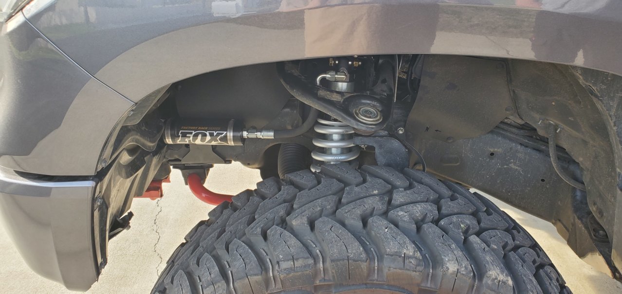

    Not sure about the bds 4.5 inch but the bds 7 used a new spindle to keeps your stock uca at a stock height so you don't need new uca if you don't want to. My alignment was all within specs. Now later I had the fox coilovers turned up and added coachbuilder shim and shackle kit for an additional 1.5 inch up front and 2 inch in rear so I could fit 38s and now I need new uca as my castor alignment is out of spec but you should be good with the bds 7.
    Here is a picture of my uca as it sits today. Still less of an angle as people running a 3-4 inch lift due to the new spindle that comes with lift
    Do t mind the rub on The body mount in th pic. That was why I lifted it higher. That has since been taken care of..

    Your Tundra looks pretty sick. Have you had problems with your BDS. I have read about people having problems. So what size tire do you have on your truck now?

    Thanks Man! And only issue I had was I didn't have the fox coilovers put on right when I got the lift. Couldn't afford them at the time so the stock coilovers with the spacers they put on the bottom squeaked like a mo fo just had to spray lube it. Then I upgraded to fox and problem solved. Second issue the rear brake lines were touching rear leaf springs but a quick bend of the very flimsy sock brake line bracket and that problem was resolved as well. So really nothing major and I've beat the crap out of it.
    Tire size is 38 13.5 20 on -18 offset

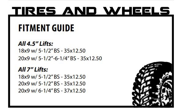

    Getmeacoors does mention the offset then mentions the Methods. The wheels will have to have an offset (BS or backspacing in their instuctions) for sure. From the BDS web page.

    Not necessarily. My offset is way to far negative according to there website and my rims are 10 wide instead of 9 . There website is for no trimming so you are right in that aspect. But if you don't mind some trimming and a bmc that opens up a lot more options :sawzall:
    But yes you are correct there website does have good guidelines to reference

    Good info. I'm not sure what my offset is but I do have the BMC.
