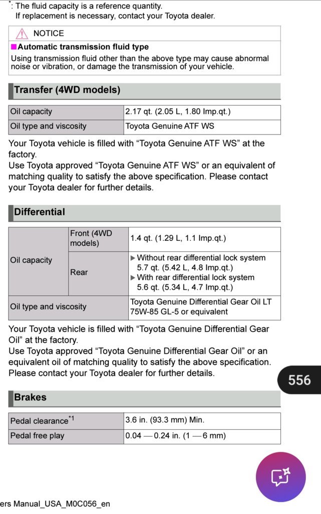

    What diff fluid do the 3rd gen Tundras use, at what mileage (service interval) and how much fluid to fill. In all my older 2.5 Gen Tundras I used Royal Purple in the rear and Mobil 1 in front and transfer case.
    What diff fluid to use for 3rd Gen 2022 and up models in both 4x4 and 2WD models please. Do the 3rd Gen Tundras require friction modifiers? I know the older Tundras didn’t.

    Ok, this took me 1 minute to find in owners manual. Your welcome. By the way, if you dont have an OM, you can download it easily & free. Makes it quick & easy to answer many questions. Screenshot_20241126_213403_Adobe Acrobat.jpg

    Thank you for picture. I have owners manual. I made a quick post as I was wanting more specifics *if everyone still likes to use Royal Purple etc. Things the owners manual isn’t as personable on. Also was hoping that this will help people in the future decide what diff fluid to go with as well as how much and how often change should be done. So they can see it on this forum through a search and save them from having to go outside to their vehicle and thumbing through their owners manual. Still helpful information and I appreciate the info and picture you posted.
