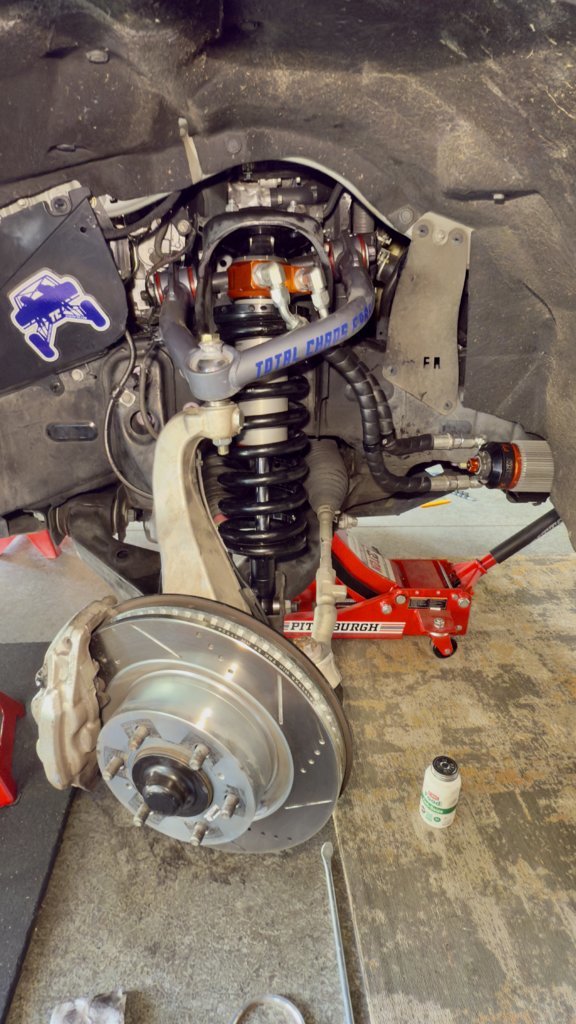

    Confirmed they do fit but you do have to angle and move the hoses as close as possible to the coils. There’s like 1/4” on each side of the hose crimp between the coil and the UCAs @TOTAL CHAOS

    Good to know, thanks! Looks good!
