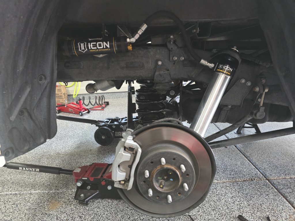

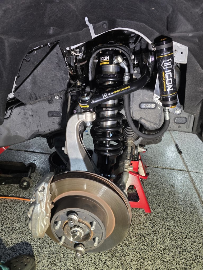

    3inch dobinsons ims struts w/Rough Country 1.5inch spring/M1 shocks in the rear— Icon Uca — Hostile maniac 20inch w/general grabber atx tires — Perry parts front bumps - alpharex luxx headlights— swapped many parts with trd body components— race off-road trd grill etc
    do you have any grease bleeding coming from the upper control arm bushings?

    Quite a bit as I grease them often given the amount of dust they see.

    ok right on it’s my first time having to do maintenance on bushings so wasn’t sure what I should be looking for. Thank you!

    what grease do you use for the uca bushings. Do you have to loosen the uca to grease? I only ask because it takes some convincing to get grease to go in for me. But than again it could be the grease gun that I’m using. Ball joint I have no issues it’s just the bushings

    It's a low demand application, anything will work. I use Lucas red cause that what I've got the most of. I've had bushings that won't take grease, if it's not a clogged zirk then it's just too tightly to accept grease. Seems unlikely with the bushings icon uses but possible

    Yeah you should always loosen the UCA bushing when pressing grease in. It can actually damage/bulge the bushing if grease is forced in with pressure on them. You should loosen the nut which will relax the pressure on the bushings. Then, press in grease until you see the bushing ends begin to move. That is enough grease.
    Those bushings aren't something that require greasing every day as @AZxp has alluded to so it's not as if they'll need it every oil change!

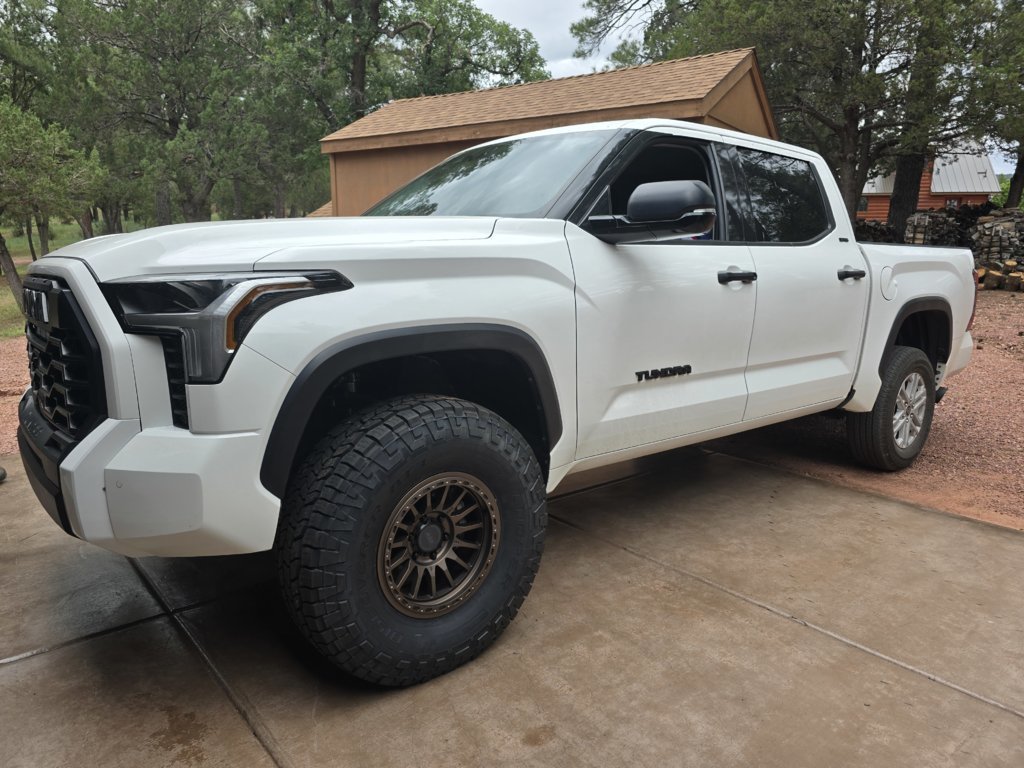

    I finally bit the bullet and ordered new wheels and tires, I went with 17" Method 703's wrapped in 35 x 12.5 BFG KOs. I've been waiting to lift the truck since May of last year (was waiting on the TRD lift) I abandoned that idea back in November and ordered the Icon stage 5 3.5" lift, but that has been on hold while I've been waiting for the passenger side red axle (on back order from Toyota). But the dealer says my axle will ship in a few weeks. I'm really looking forward to finally having the truck looking more my style instead of an old man truck.

    Looks great! I cant tell from the pics, but what is the offset on those RRW Wheels? and what size are the Coopers?
    I have some 295/10/18 on my TRD pro wheels however I ordered the RRW RS7 wheels 18x8.5 +25 offset.

    37 cooper's. Rrw are 17s with 0 offset
