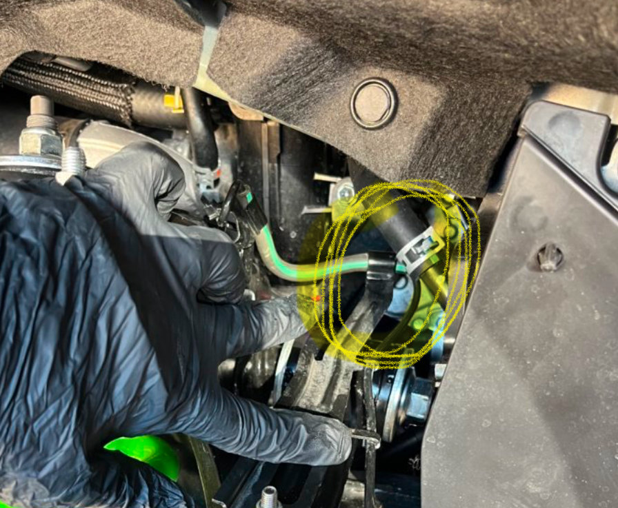

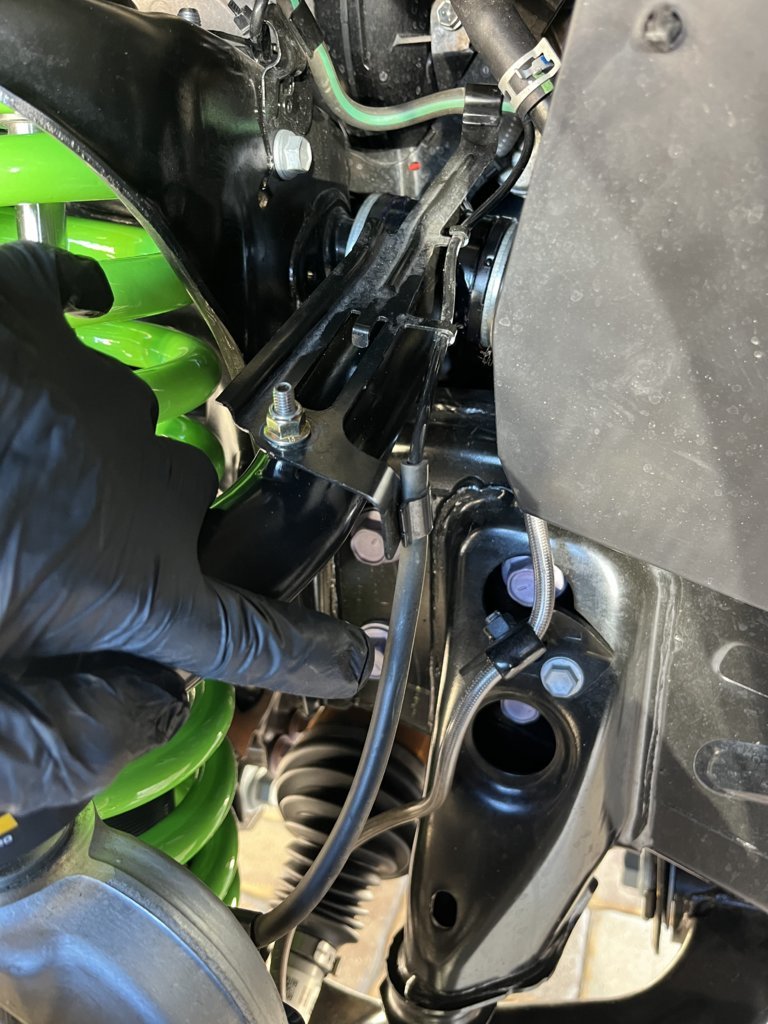

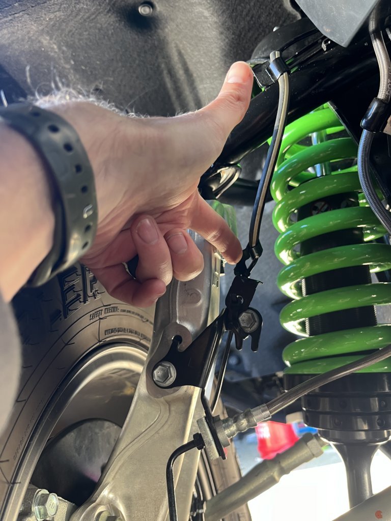

    #1833
    slcsez2000
    slcsez2000 New Member
    Oct 8, 2024

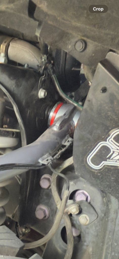

    #123982
    53
    touché - that actually crossed my mind an hour or so after this.

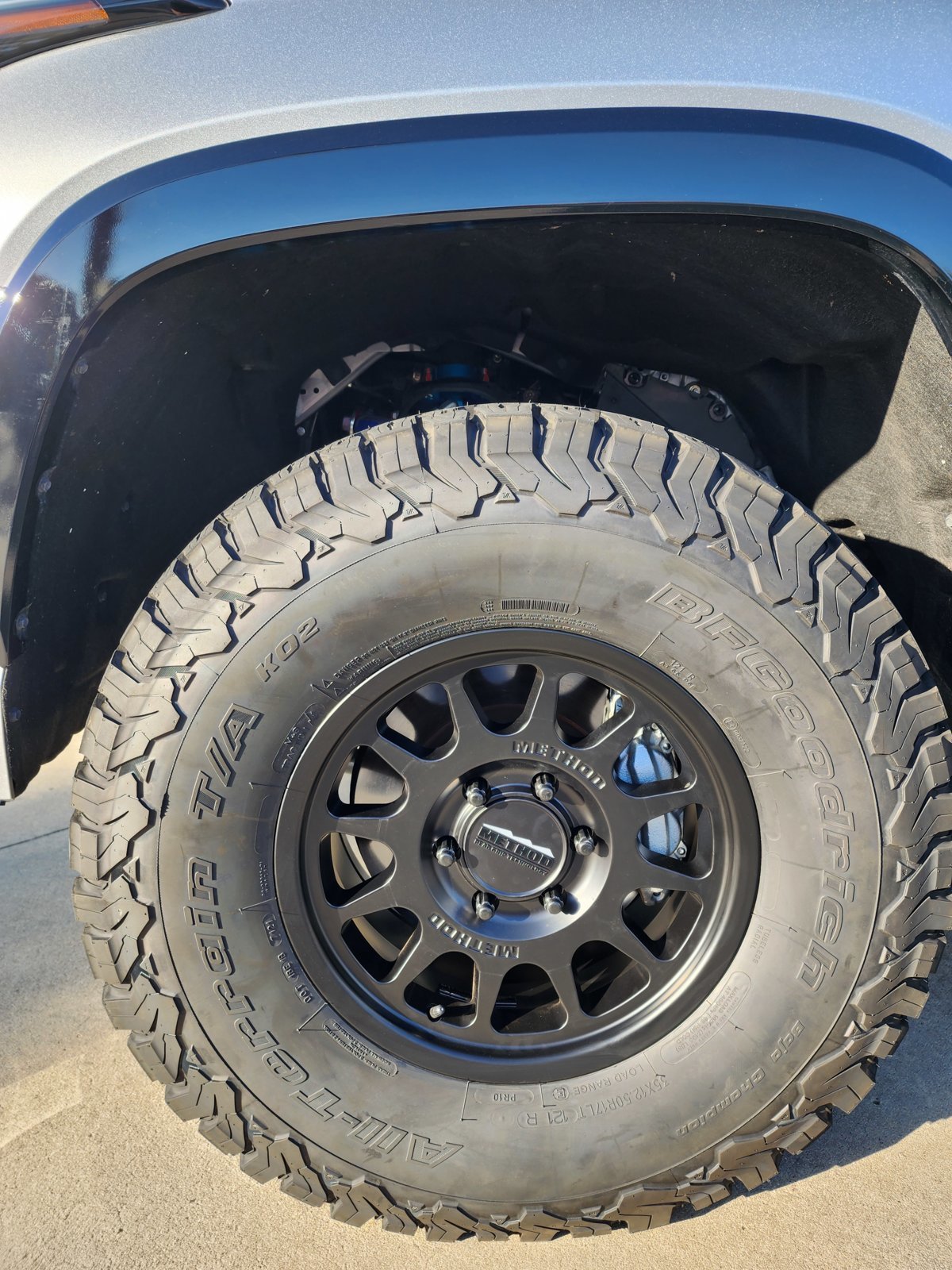

  14. Dec 14, 2024 at 2:04 PM
    #1844
    ToysRus
    ToysRus New Member
    May 28, 2024
    #117559
    3

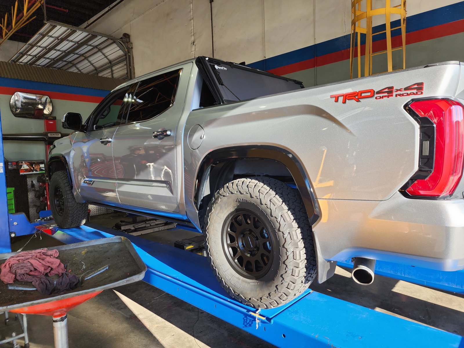

    Donovan
    NE Nevada
    2023 Limited TRD
    Crappy pic but here’s my 2023 limited crewmax with the Icon 2.25” spacer and 35x12.5x17 KO2s on Method 318 17x8.5 with 25mm offset. Got about 3.5” front lift out of the spacer. More than I wanted. Sits level without a load (1/8” high in the rear). Rear is sagging a little in the pic because of weight in the bed. This lift is temporary as I needed tires and can’t afford the setup I want until January. Overall, ride in the front is better than stock. Rear feels squishy now. Haven’t taken it off road much but it’s an improvement over stock. On road is a lot better. Gas mileage dropped to about 13 mpg average. IMG_5218.jpg
    BabyMoose and CrayCray like this.

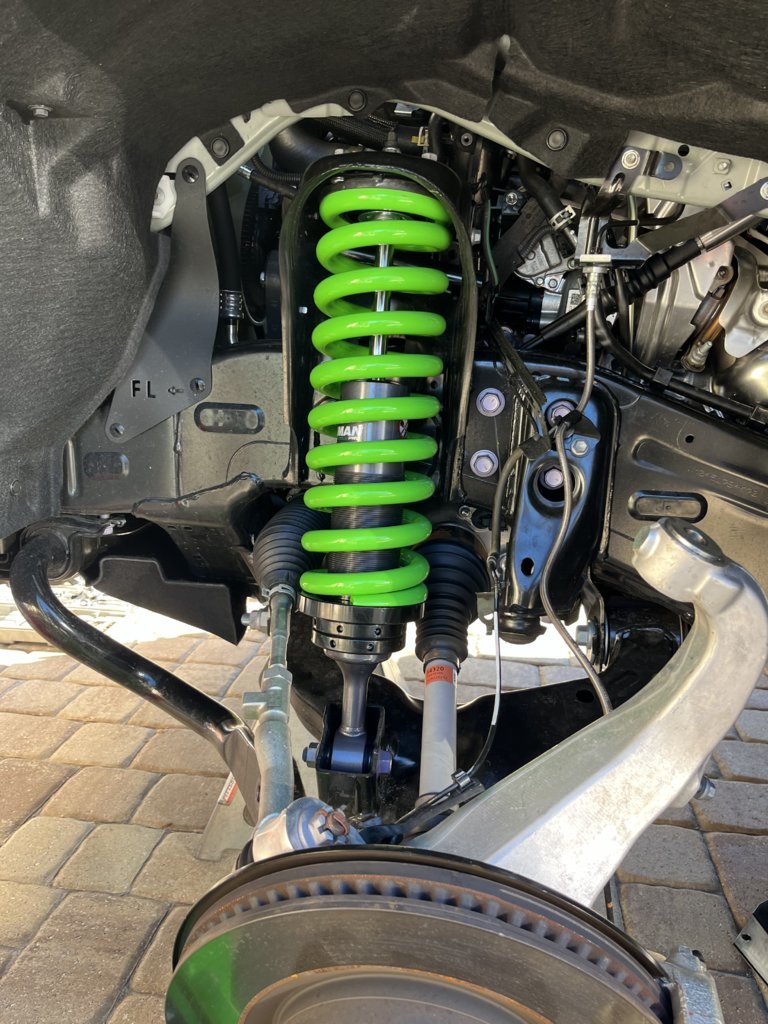

  23. Jan 8, 2025 at 6:42 PM
    #1853
    slcsez2000
    Oct 8, 2024
    #123982

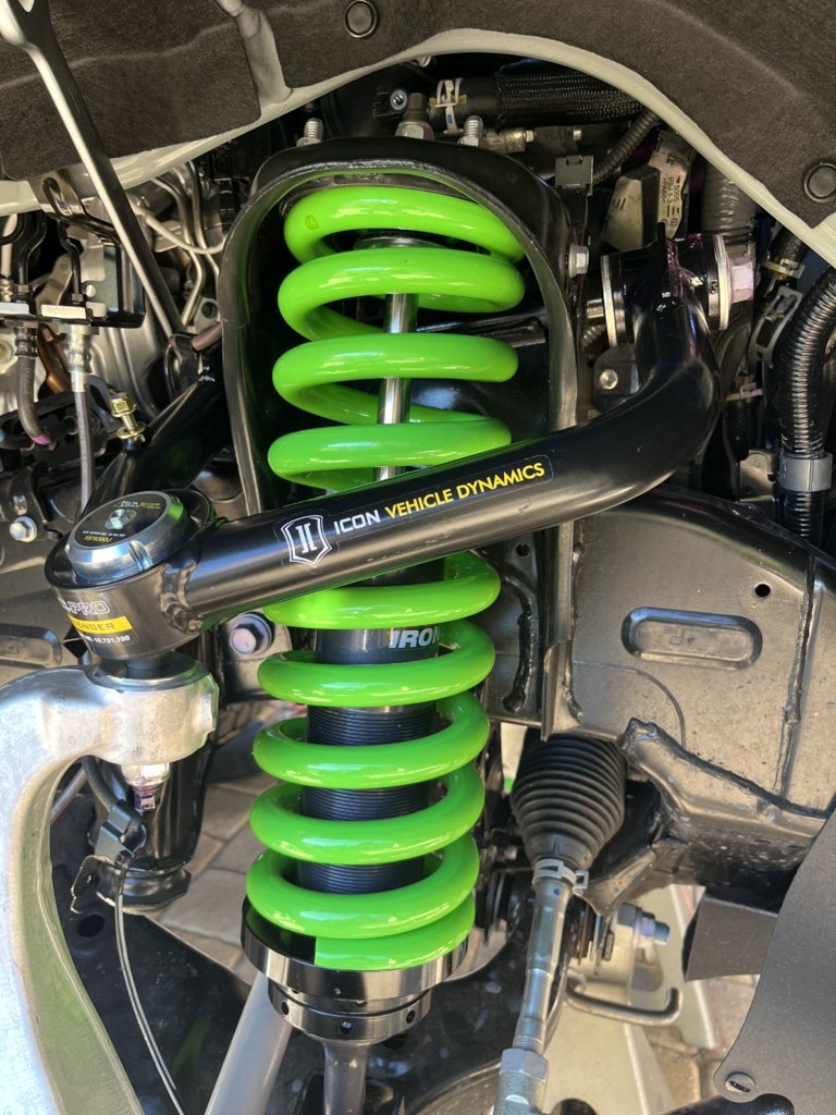

    53
    Had a little time today so got my front done with the Ironman 4x4 3” lift with heavy duty coils. Hope to get some time to get to the back sometime soon in the next couple days.
    Just a few pics
    SWFL23TRDOR and BabyMoose like this.

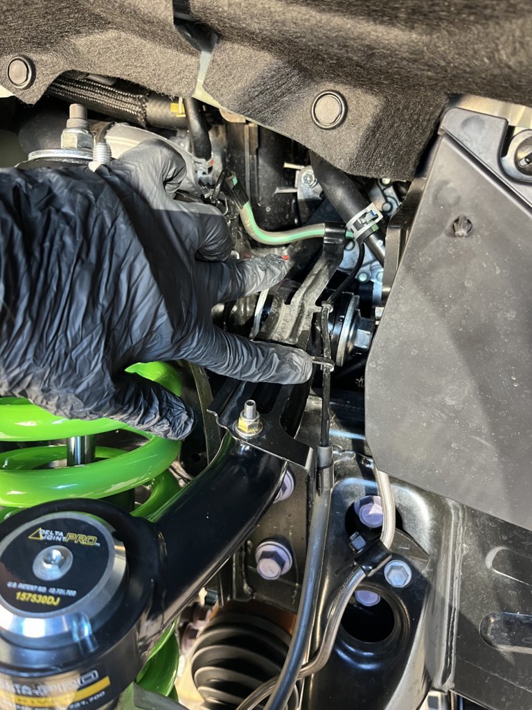

    Oct 8, 2024
    #123982
    53
    Question for you guys.
    I think this is the ABS line (correct me if wrong) but doesn’t matter
    either way. Are y’all having to somehow extend this to have some slack? Or what are yall doing?
    I went up 3” lift and don’t even have enough slack to reconnect it with the bolt back to the bracket…. Zipped tied for now until I hear something.
    extended my brake lines all the way around but this is the other line.
    thanks.

    Washington, PNW
    Something is not adding up here, take a picture further away.
    That ABS line has slack up along the upper side of the UCA

    #80197
    328
    Washington, PNW
    Take it out of the circled clamp and get your slack from there

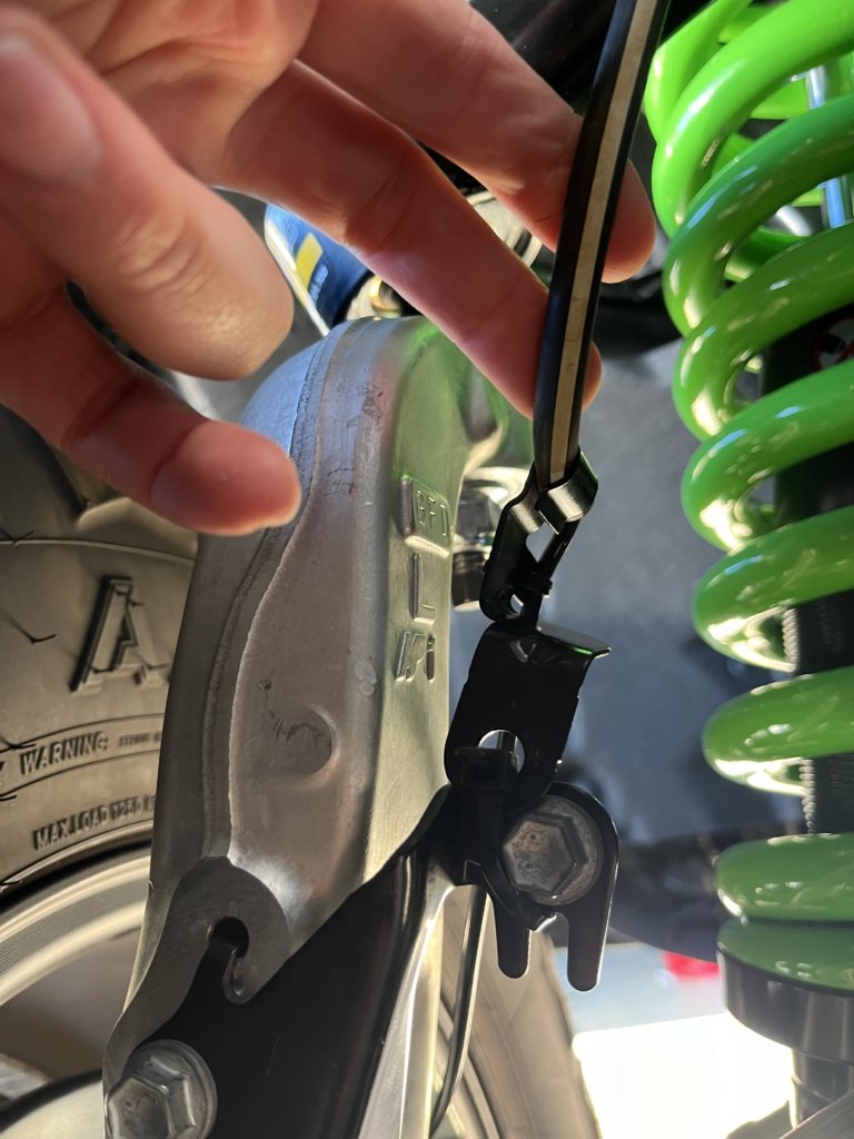

    Oct 8, 2024
    #123982
    53
    can’t really tell from that angle
    Is it just removed from the clamp like he mentioned above?
  30. Jan 9, 2025 at 12:59 PM
    #1860
    AND
    AND New Member
    Jul 2, 2022
    #80197
    328
    Washington, PNW
    Yes the whole clamp is gone and TotalChaos UCA have tabs to zip tie the line to it
