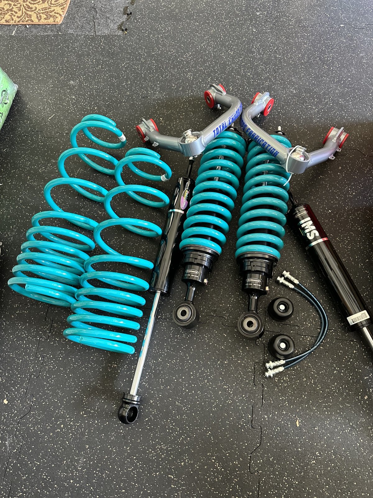

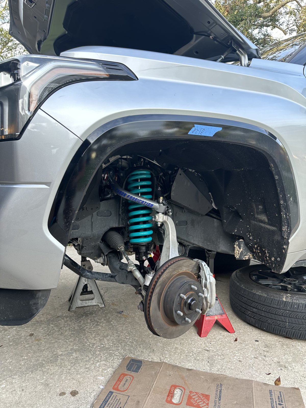

    Put in my dobinson IMS 3/2 today with DuroBumps, UCA, and some extended brake lines. Waiting on Dr. kdss trac bar correction kit and icon sway bar drop kit for the front.
    what are y’all’s thoughts on the need for extended rear sway bar links?512ACE5F-A07A-4CA0-A3E2-DA6ACDC97EC5.jpg157F3C73-CFB9-4383-83A2-CA5E6DAEACB2.jpg

    Very nice. Can’t wait to see if all mounted up.
    Where did you get your extended brake lines from?

    yotamafia. Nice guys but they are far from having the business side of things running well. I’d order from elsewhere if you can. High likelihood you’ll never see your order short of 20 calls and 10 emails only to get it weeks later.

    You buy your fronts assembled? Asking because my fronts have 6-7 threads. Got mine un assembled and put them together myself per the instructions

    I got mine un unassembled and did 6.75” measurement instead of 6.87” from center of thru bolt to top of rubber notch on the ring which gave me 2.6” of lift. I didn’t want the full 3”. Hopefully they don’t bind. We’ll see. Have you installed yours yet?

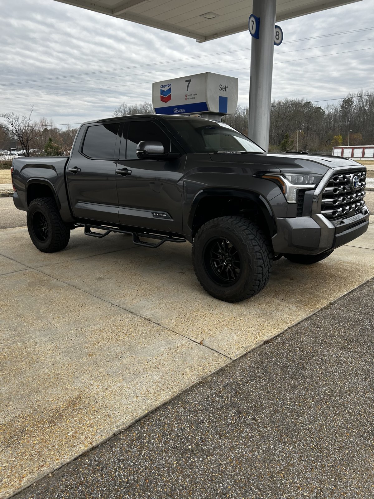

    These trucks were made to be lifted! Haha! Obligatory shot of filling her up! The 37’s like the fossil fuel. Good thing that’s what I do for a living. Job security!!

    Man you’re making me regret ordering 35’s. That looks so so good…
