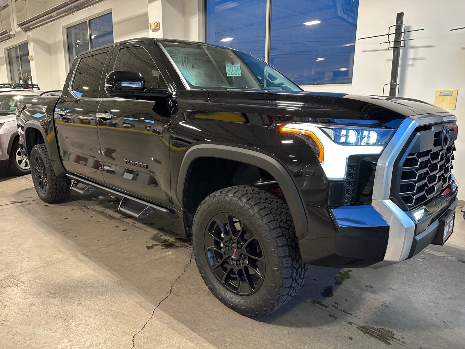

    2023 Tundra Limited TRD Off Road
    Newly installed TRD Lift.
    ***UPDATE TO BELOW***
    First, the dealership cut the TRD Skid Plate and it looks great. Hardly noticeable. Second, the dealership installed 1" spacers to eliminate the rubbing. All around, very happy with how the truck is handling and eager to take it off road. Cheers.
    Pros:
    • Even with somewhat smaller tires (33.5" - 285/60R20/10 Toyo Open Country AT III), it looks great. The stance and profile look right now.
    • Mileage so far seems to have taken only a minor hit. I credit the slightly smaller tires.
    • Strong handling, even better than factory. I credit the improved hardware in the kit.
    Cons:
    • Working with the dealership on a fix for the TRD Skid Plate. I want it back on even if the sway bar is on the outside. I would probably prefer a cut to spacers.
    • Surprisingly, I'm getting rubbing on the sway bar even with the 33.5" tires when I crank the steering wheel in either direction. Working with the dealership here too.
    • I'll update the post this coming week after the dealership foreman takes another look.
    • Early, but getting up to highway speeds (70+) isn't as smooth as I remember with factory. A bit of a shimmy / bounce that definitely feels new.

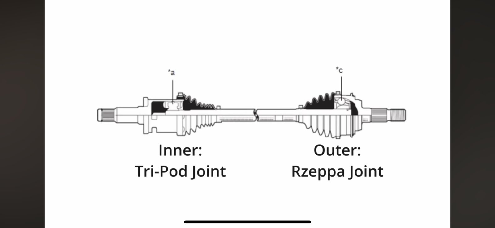

    Now that “Tinkerer’s Adventure” (YouTube channel) has disclosed the differences in the black, red, silver axles, has anyone seen or heard of anyone damaging a black axle due to lifting or wheeling?
    Black axle
    Red and silver axle

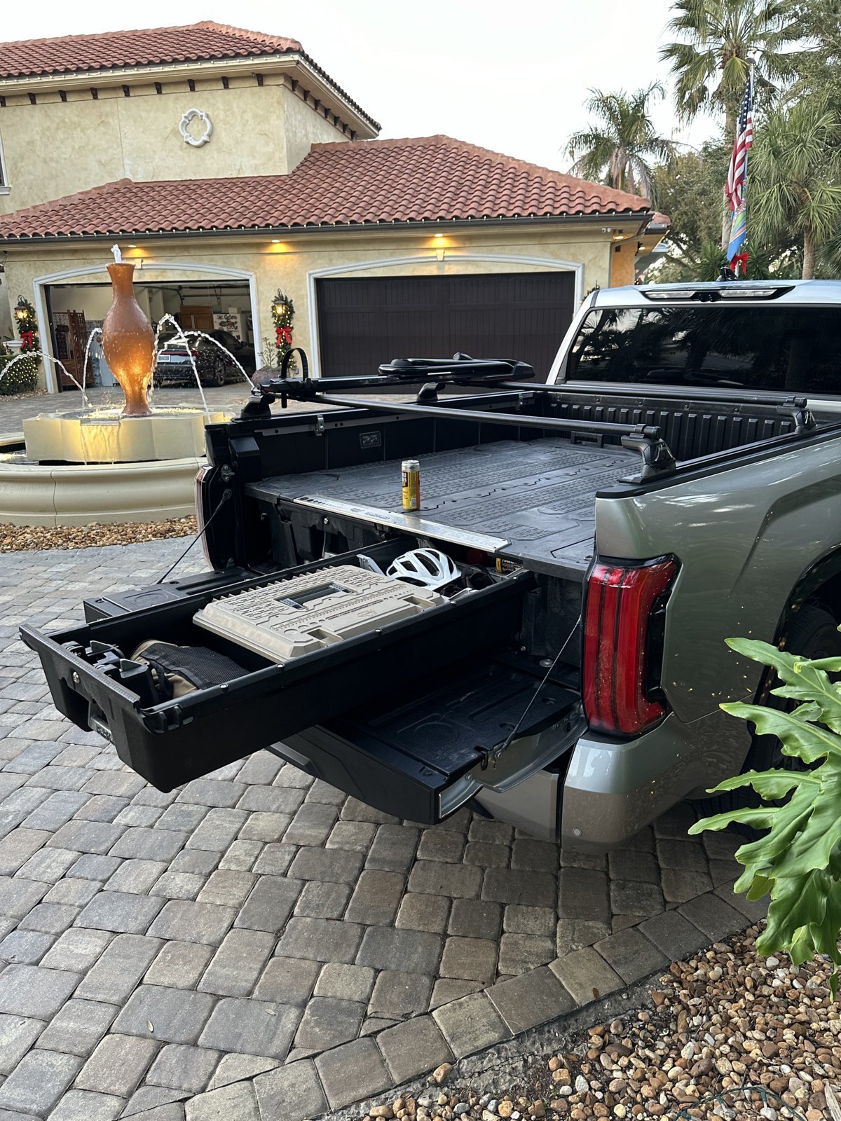

    I’ve posted on here before but posts get buried quickly and I saw a couple pages back questions around OME springs. I shifted from OME 2864 to 2866 and like the latter better for the progressive rate. I load up and unload my truck for off road. I also added the pan bar relocation by Dr KDSS and fit a 35” spare in the rear. The truck just looks right on 37’s.

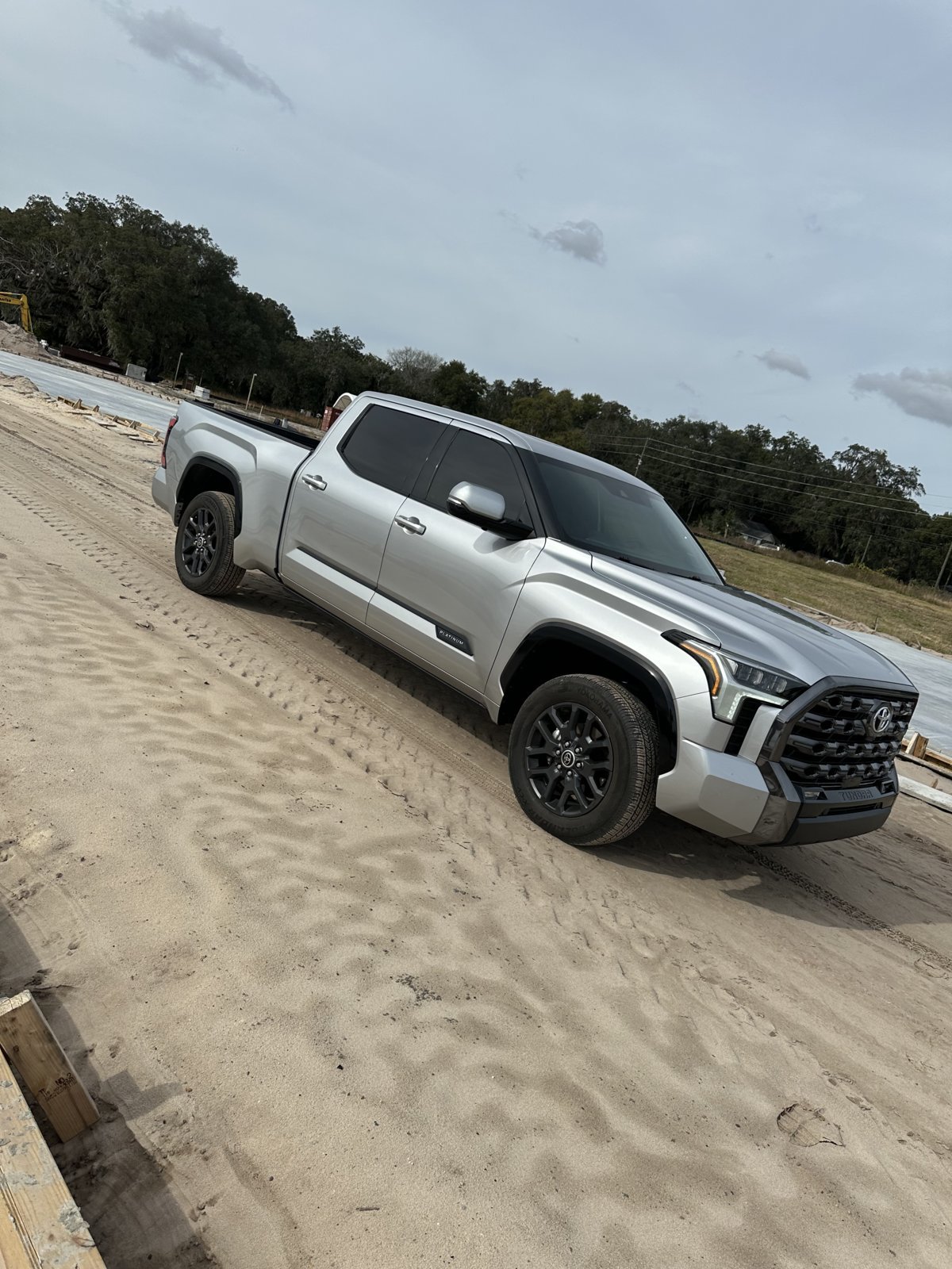

    Got the TRD lift installed yesterday on my 23 Platinum CM with 6.5' bed. I definitely think a lift is mandatory with the CM 6.5 bed. Got the parts on the Black Friday deal for $2140 otd but had to pick up from a dealer 3 hrs away. Had a closer dealer, 2 hrs away, do the labor for $2009 otd. Total cost $4149.
    Before:
    After:
    I did have an issue after getting home with one of the new rear brake lines leaking. Had to loosen then retighten the nut to reseat the flare and it seems fine now. Hopefully don't have to drive 4 hrs to the dealer and back again. Prolly need to bleed the brakes again to be safe.
