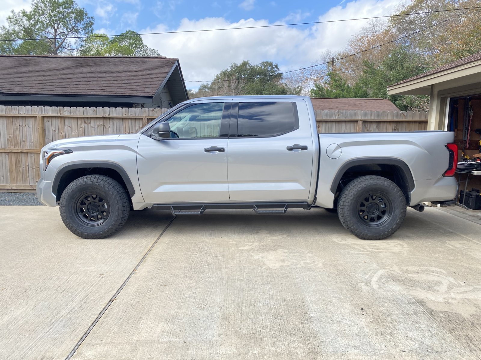

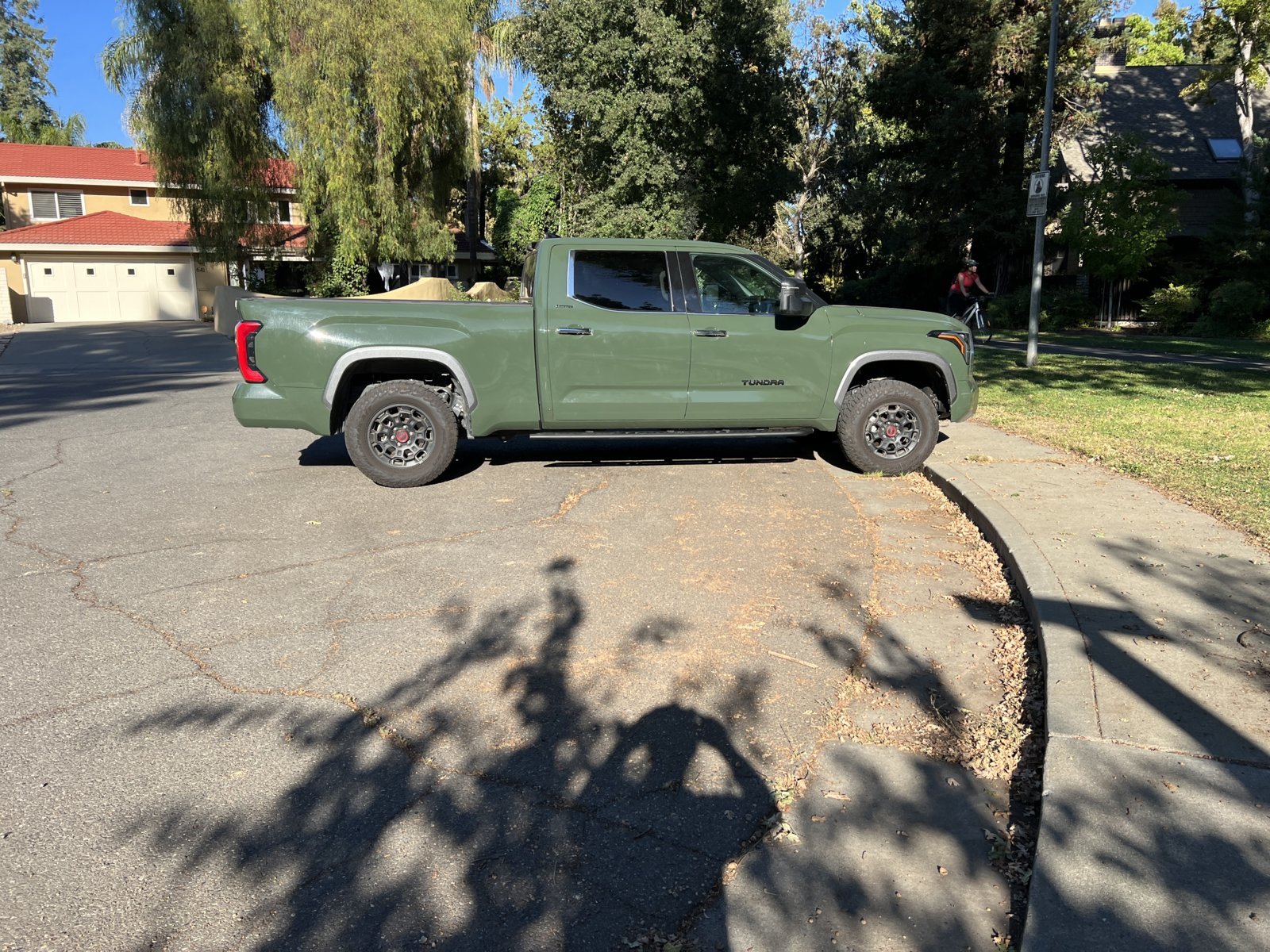

    TOMMYBOY1
    TOMMYBOY1 New Member
    Sep 11, 2020
    #52085
    48
    Tom
    2023 Toyota Tundra Trd Sport Crewmax

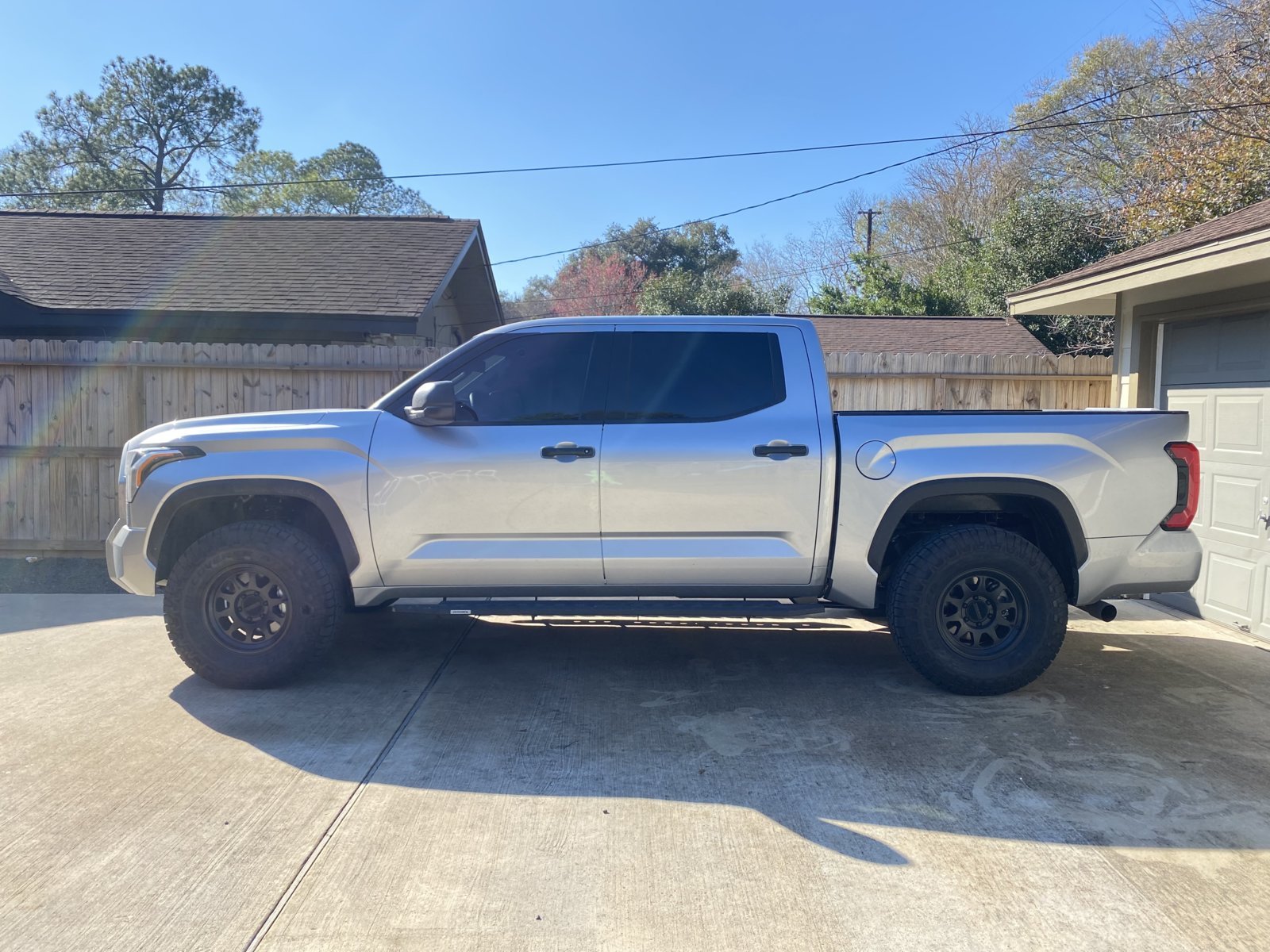

  9. Oct 5, 2023 at 7:27 PM
    #1449
    TOMMYBOY1
    Sep 11, 2020
    #52085
    48
    Tom
    This group is great for info and I like to give feedback as well for others to maybe help them or save them time and money. With the Dobinson IMS 2/1 lift I gained a lot in the Rear, about 2 inches so I need a pan hard bar (trac bar) adjustment. Also I had put Dobinson front shims on top of coil overs to gain about 1/2 inch more of lift but keep preload as suggested by dobinson(seat height at 175MM) but it was a little too soft for my liking so I Took out the shims and adjusted the preload to 181MM which is 4 turns (1/4inch) which gained the 1/2 inch of height the shims gave. The ride is still nice but more stiff and controlled with less bounce, just right for my liking. Either way dobinson are a nice setup

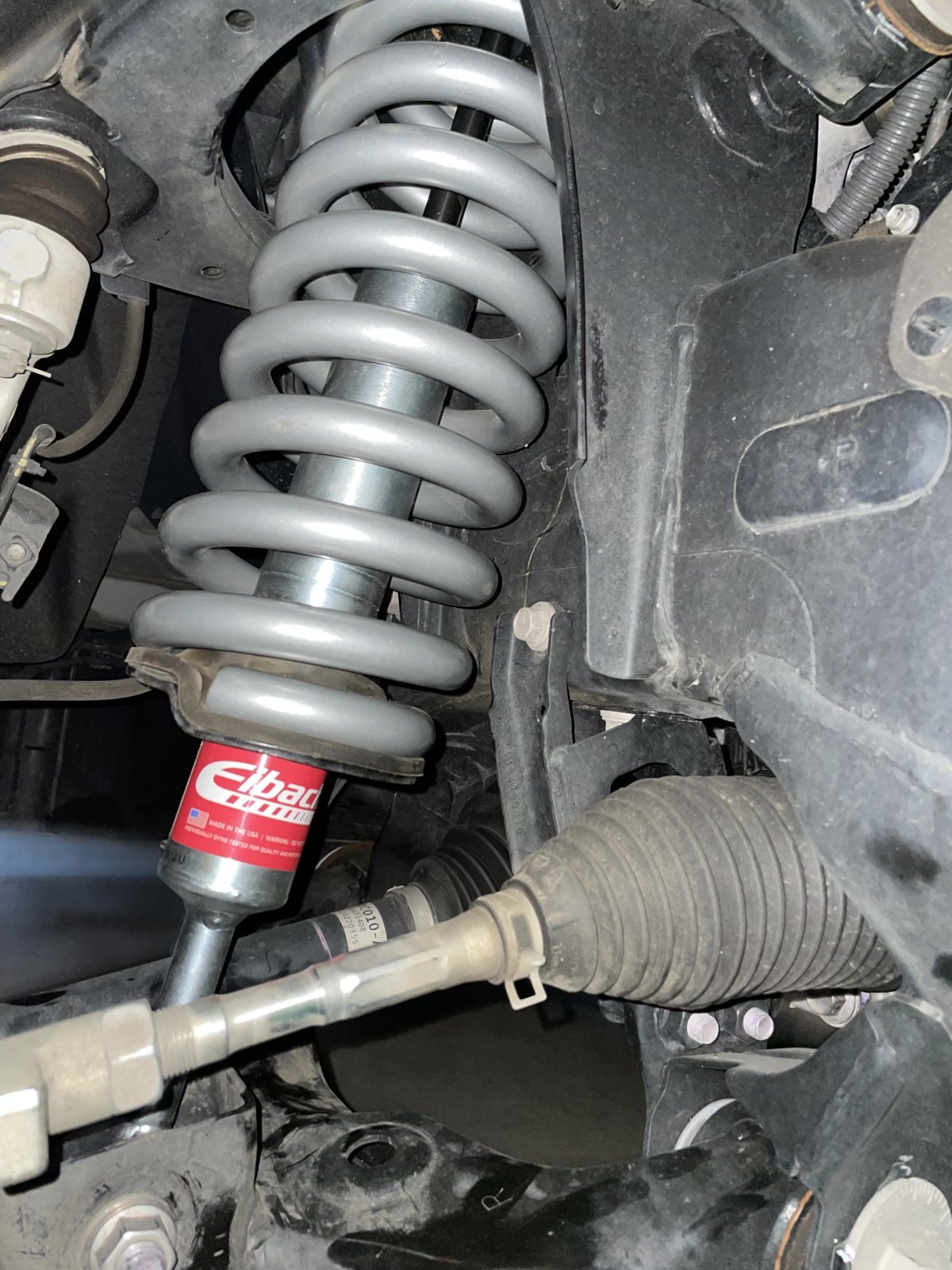

    Eibach pro truck stage 1. Got the fronts installed. 3 hours in my garage and turned out great. Netted about 2.75” and should settle a little. Next up is the rear.
    Siblue, 4mm, iiawah808 and 2 others like this.

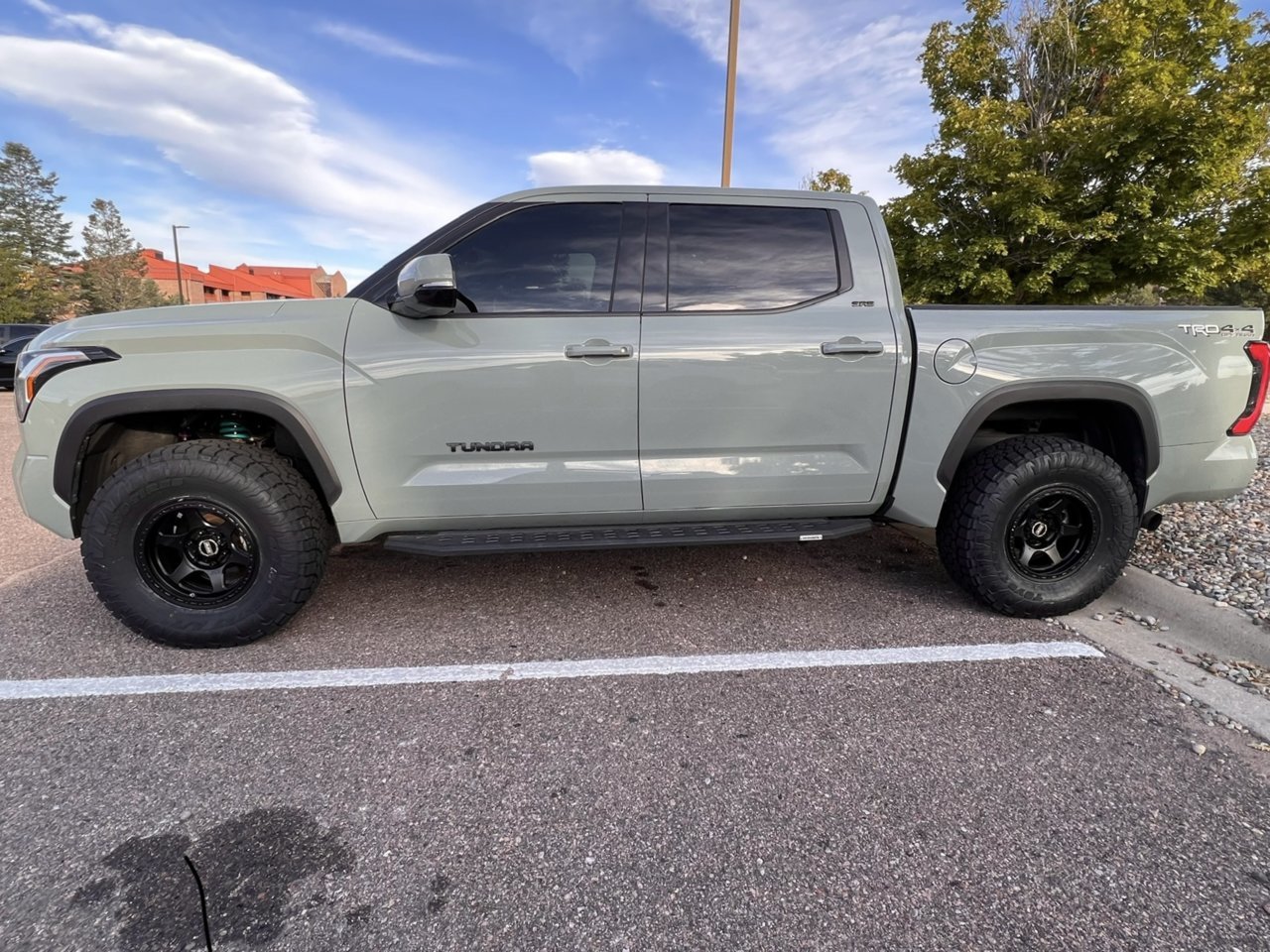

    315/70/17 coopers at3
