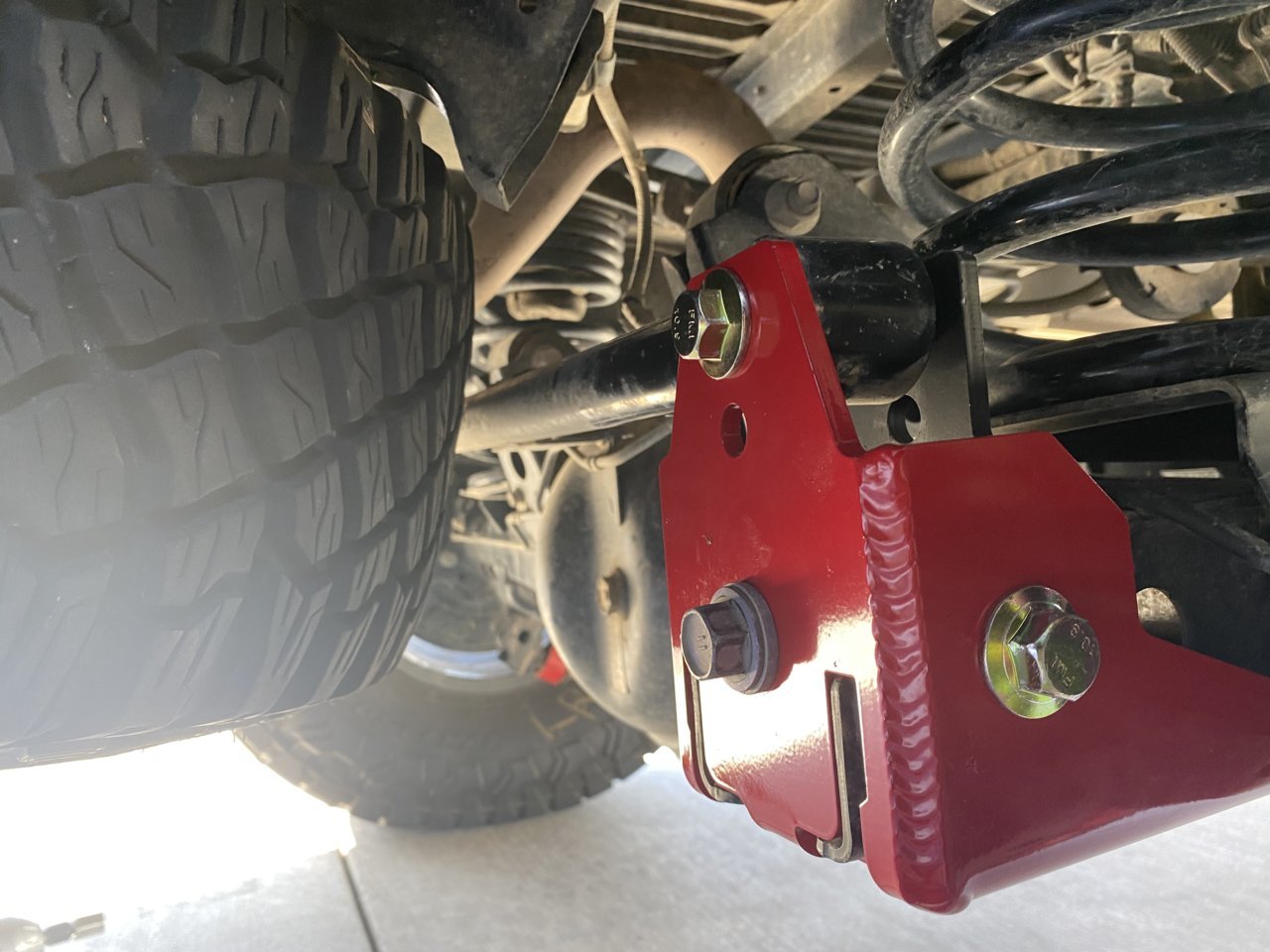

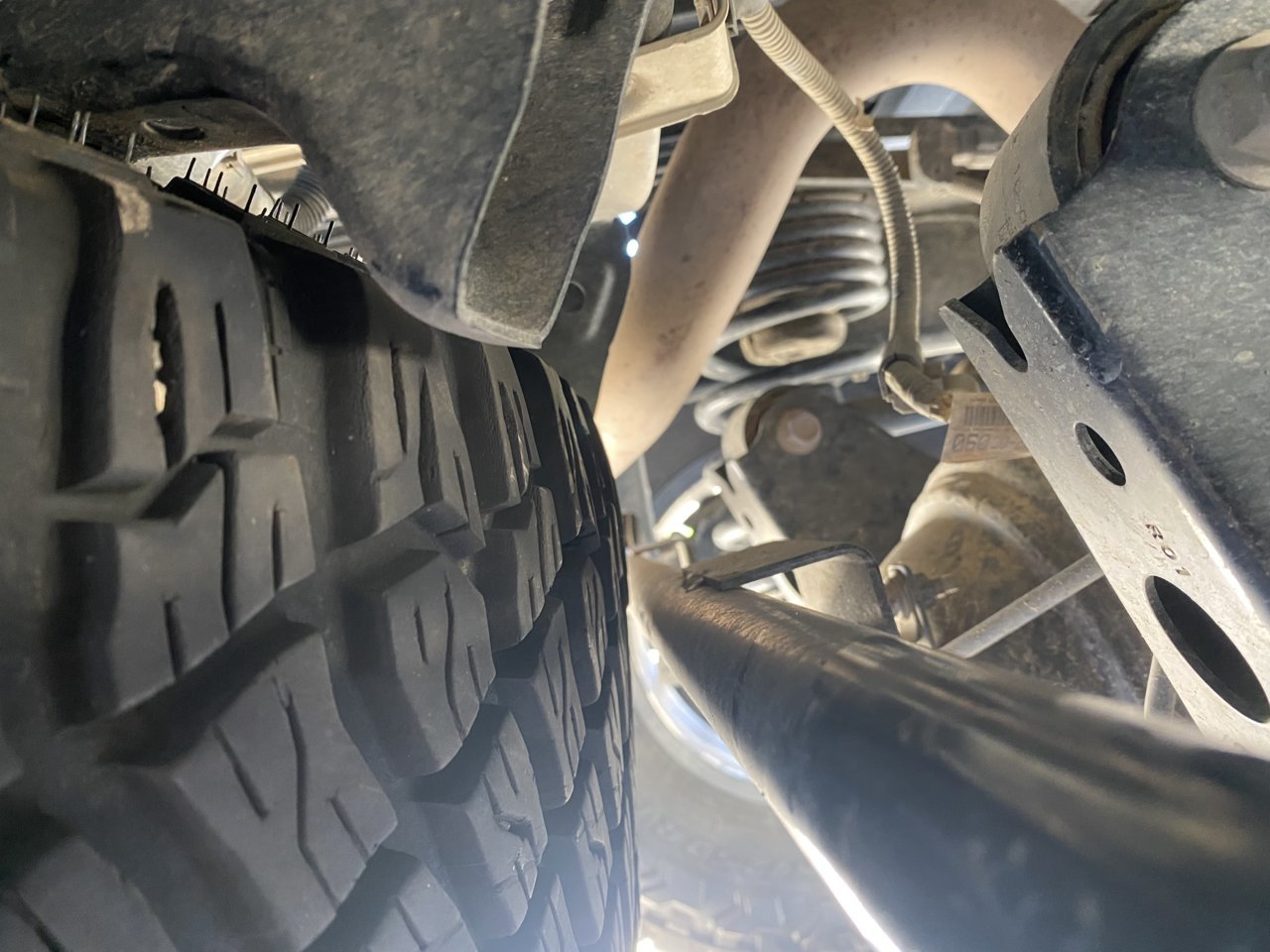

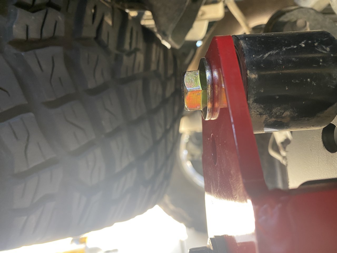

  26. Sep 13, 2023 at 3:06 PM
    #1376
    PapaDave418
    PapaDave418 A Dude who knows a Dude
    Feb 7, 2022
    #74248
    950
    Dave
    North Idaho
    3rd Gen Limited TRD
    37’s—PullKitchen--KB Voodoo Rack & Full Ext Cargo Tray
    Today I installed the Dr KDSS track bar relocation kit. It was pretty easy and straightforward. I did have to jack up the axle on the passenger side in order to get the track bar to locate correctly for the top bolt. I extended the axle full droop and it’s still not pulling on my brake lines, I have stock shocks and links.
    My sway bar is basically level now so hopefully it will reduce any bump steer. I recently put a 35 underneath as my spare so I’m watching the clearance. I’m going to keep an eye on it to see if it touches.
    ADB09FA9-34C8-4D9C-A810-8A36A2412C74.jpg 0180E52D-2164-426C-845F-0E00B9EC4179.jpg 2DB6798E-B620-4119-994C-26361B3FCE3C.jpg A120AB5B-61B9-4BA0-92AB-AD52D1FE3B8D.jpg
  27. Sep 13, 2023 at 3:12 PM
    #1377
    KroppDuster
    KroppDuster [OP] A normal guy trying to survive this crazy world
    Dec 7, 2021
    #71535
    2,005
    Here. There. Everywhere.
    2021 SR5 TRD Off Road - Cavalry Blue
    Bilstein 5100s
    Have you measured the axle for center yet? I need to adjust my Icon trackbar some more. I'm still about 3/4" long on one side.
