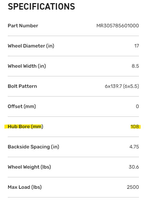

    Good gravy, no wonder why I work on houses and not cars. I would have not considered that bore issue. So if the bore is too big, it would create some rotation/vibration issues I assume? So we have to pick a wheel with the correct bore size or get a ring that will correct that issue.
    I was looking at purchasing the following Method Wheels. Since the bore on that rim is 108mm and not the 95mm you suggested, I need to get a bore ring to make sure it's correct? Thanks.

    So there’s people who will say you don’t need the ring since the lugs center the wheel but it’s very cheap insurance to add the ring so the wheel is actually in contact with the hub like Toyota intended.

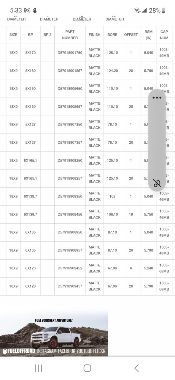

    It looks like my Vectors are 106.10. My offset is +19.

    Okay, so in the same boat as Bird Dog. If hub's are 106.10, what do we need to get them to the 95? Thanks,

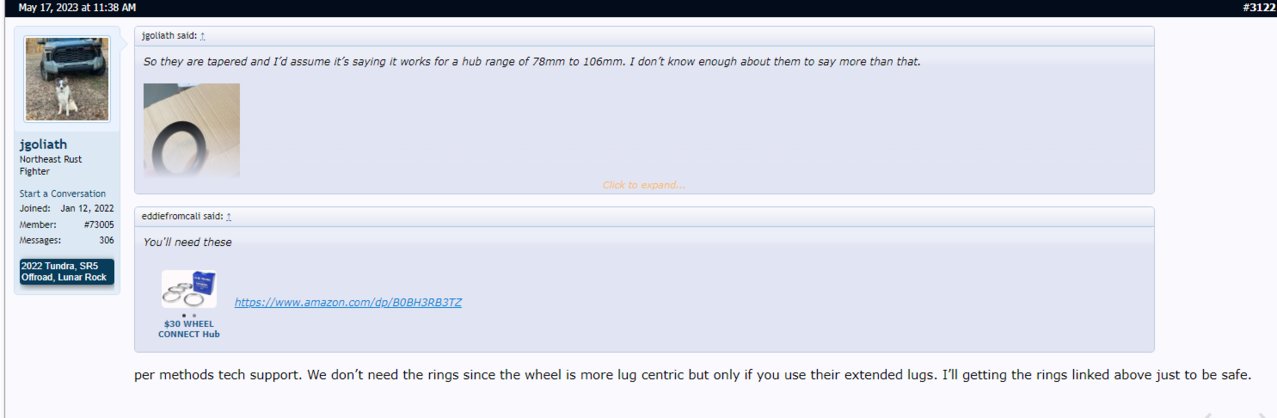

    I found this after some searching.
