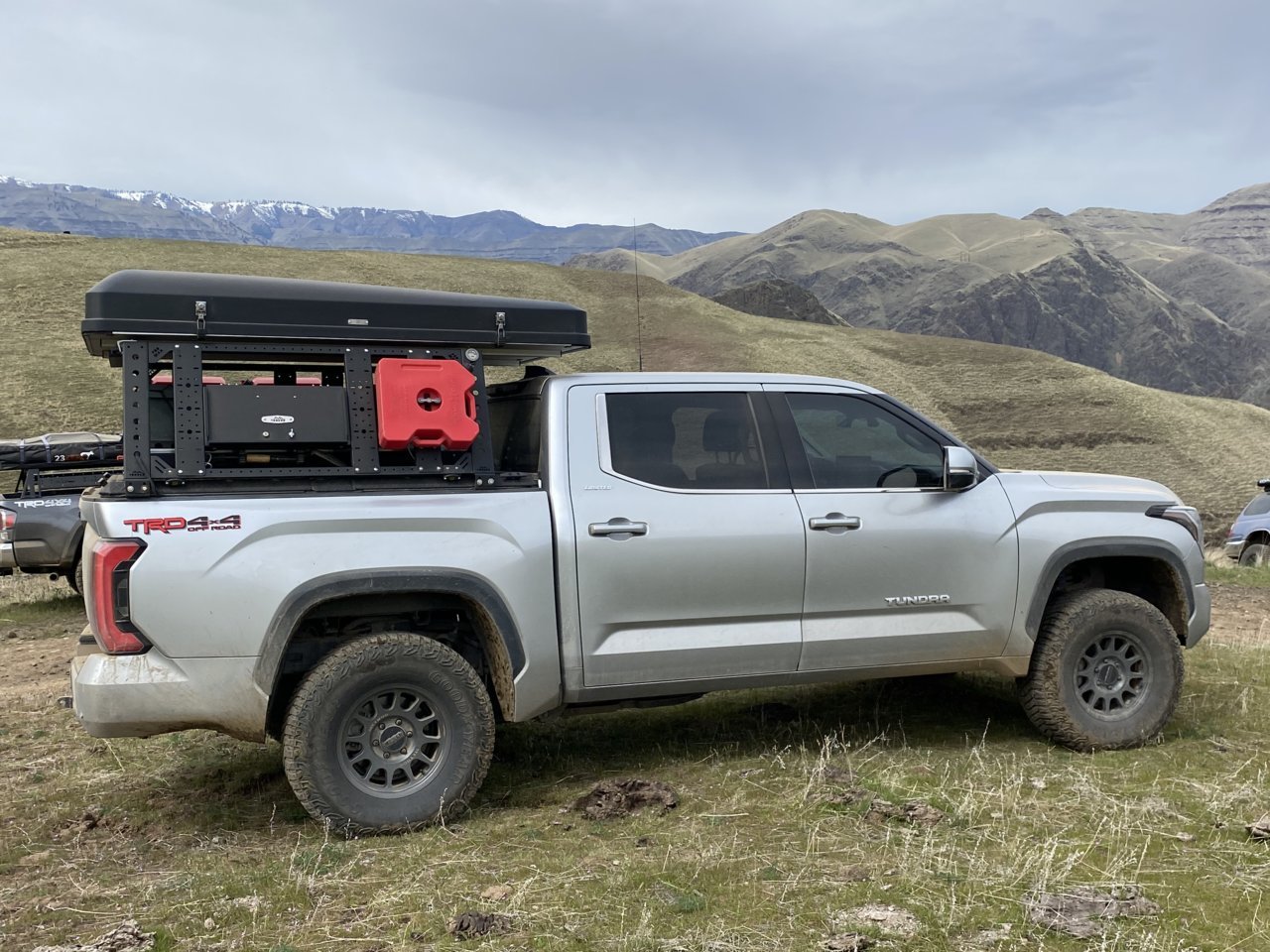

    37’s—PullKitchen--KB Voodoo Rack & Full Ext Cargo Tray
    I put in OME 2864’s and those are definitely big boy springs for something constantly heavy like a camper. I can’t remember how the 2866’s (progressive) springs have worked out for load and rear height? I need to pop those in as they’ve been in my garage for far too long. I probably have like 3-4” lift in the rear.
    I am fully loaded here and the 2864’s are like “you are?” The rear rebound is harsh and I’ve got Westcotts 3” up front
    05FABBF8-B9C8-4732-8876-E4F3BBCC8FE8.jpg 98F7BCAB-FE0F-43D2-8C29-8DC8FEA7B07E.jpg

    Retrax. Uptop AFS bed rack. Condor XL. Dobinson rear springs. BFG 35/12.5/r18. BD light bar and ditch lights. Prinsu roof rack. Diode dynamics fog upgrade.
    I got a similar set up with you, but have a TRD PRO with stock suspension. Getting Dobinsons installed on rear rated for 250-400 lbs of weight and a 1” lift. Hoping that takes away the sag. Will report back with what it does.

    I’d be interested in your before and after, and fully loaded
    I don’t have any measurements prior or loaded. But can tell you with all our gear we had a good amount of squat. Getting 35” tires helped hide some of it but will def let you know if it leveled out afterwards. I’m thinking it should level out for daily use, and adding water, food, fridge and battery and gazebo will sag a touch. Just didn’t want to jump to the next tension level and have too harsh a ride.

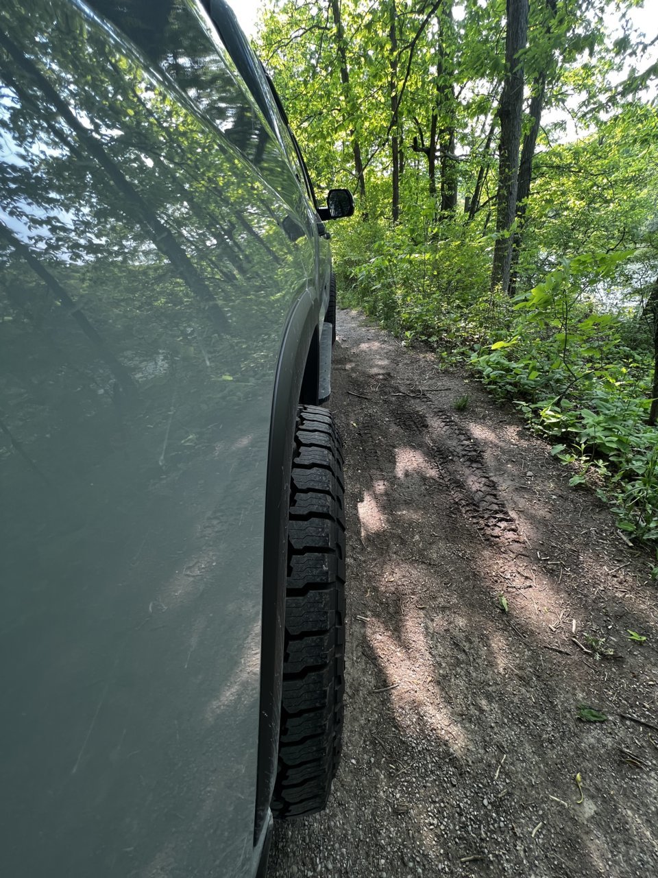

    KING 2.5 suspension all around w/ Westcott rear arms. 35” Toyo Open Country AT3 Method 18” 305NV Black on Black ICON Billet UCA’s TRD Filters Diode Dynamics SS6 Amber Fog Lights
    Getting some rubbing with the Westcott lift and ICON Billet UCA’s (35” tires) still here (see photo)I think that’s the body mount chop I would want to do but not sure. I am going to get a better alignment done which will likely fix the rubbing but thinking about preemptively doing this chop anyways as I will end up converting over from Westcott to a full suspension (likely ICON). Have been holding out for them to develop something for us with the Platinum AVS/Air Ride setup but it’s not looking likely so I’ll probably just bypass it all together. Anybody know of companies with plates made for this chop already?

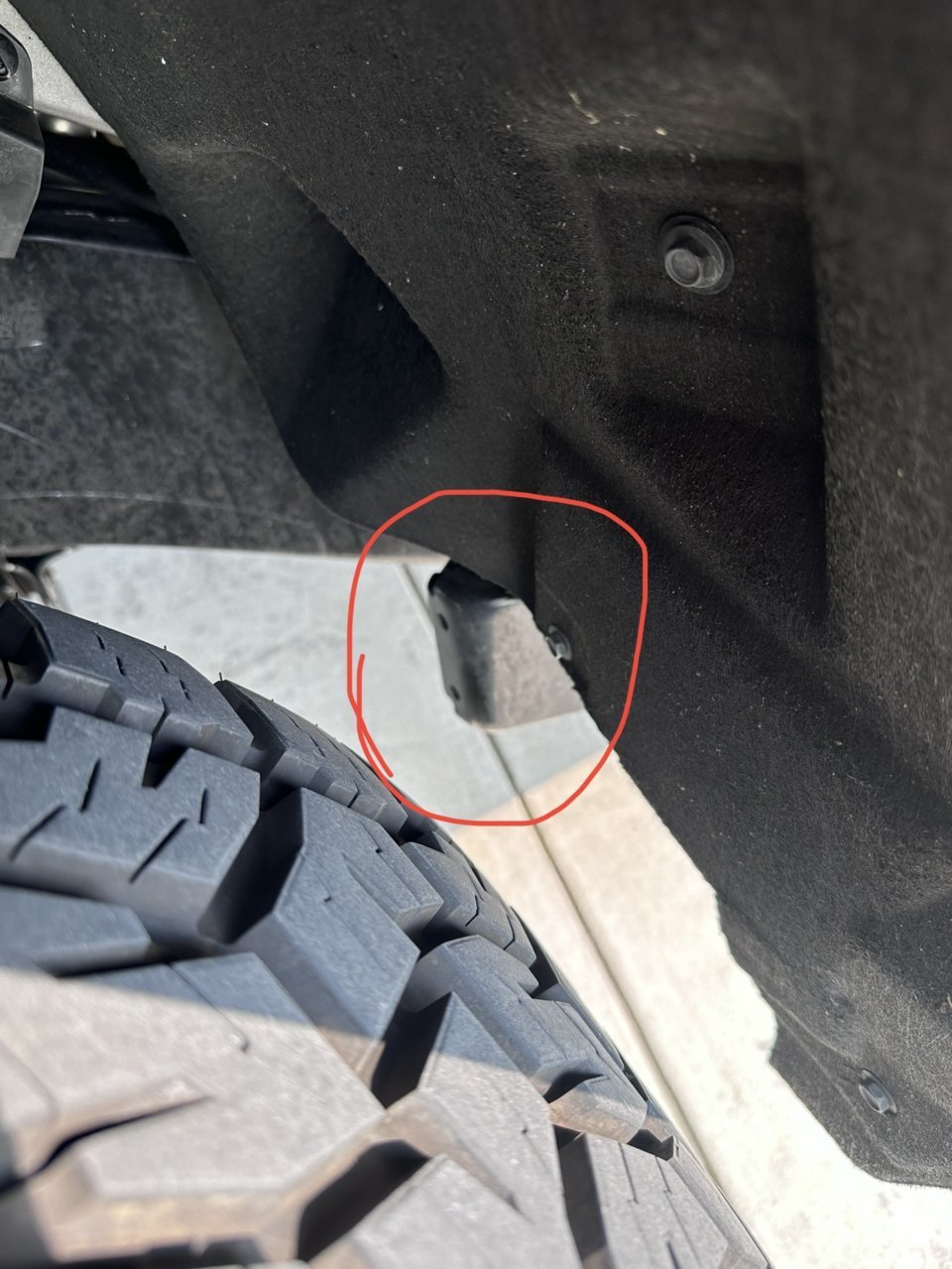

    You don’t need a plate. You can cut it off. Grind back the edges flush with the rest of the cab mount. I guess. Plate welded into the spot could look “cleaner” but it’s not like the cab mount chop on other Toyotas.
    pic of it chopped with no plate.

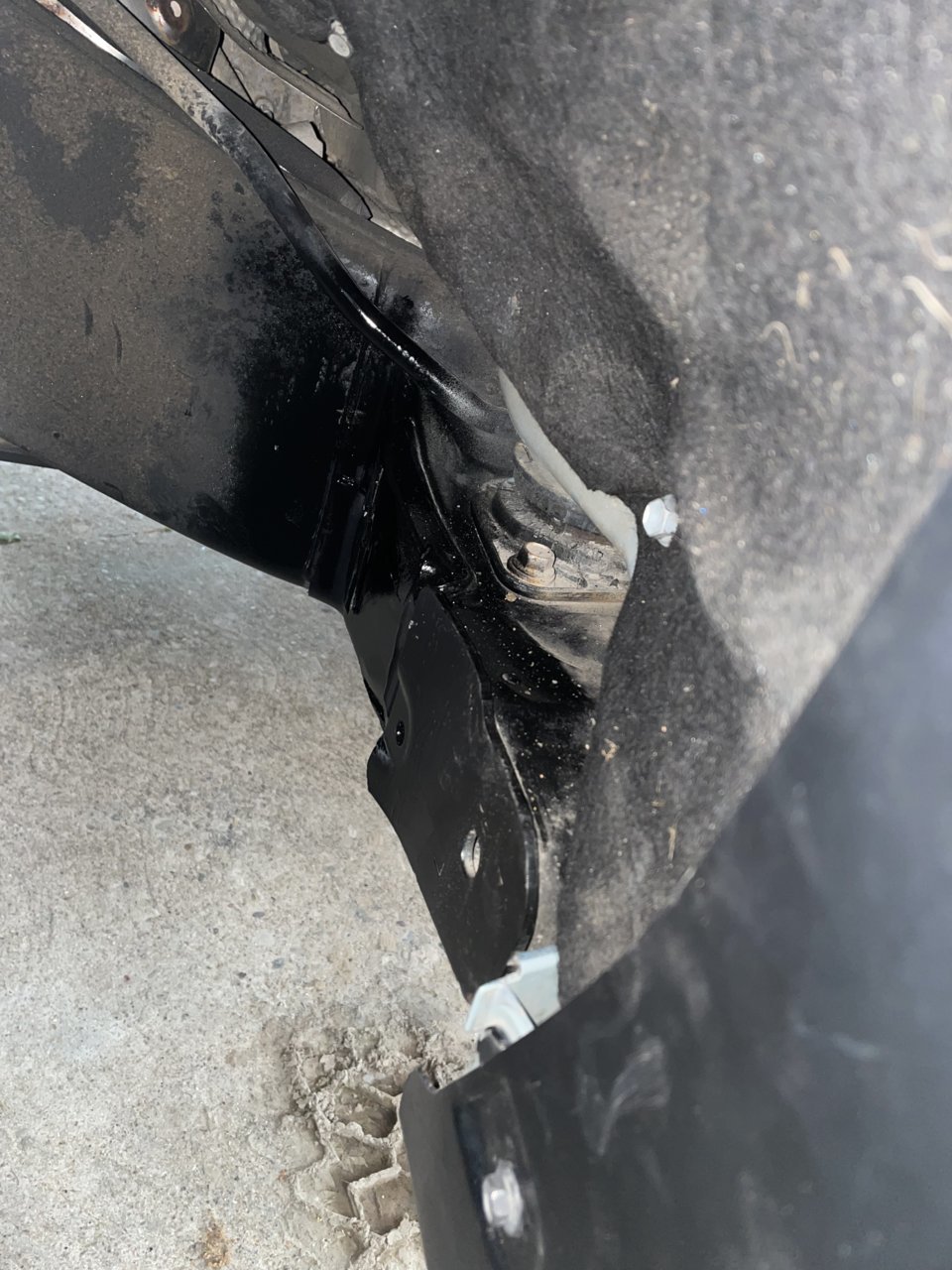

    After my lift and 35's I had to remove the mud flaps because both sides rubbed at full lock. Tried cutting the mud flap but had to cut so much there wasn't a lot of support on the inside mount. Is there mud flaps that will work with 35's?

    Can’t you just unbolt that mount?
    Took mine off a long time ago, don’t remember what it looks like.

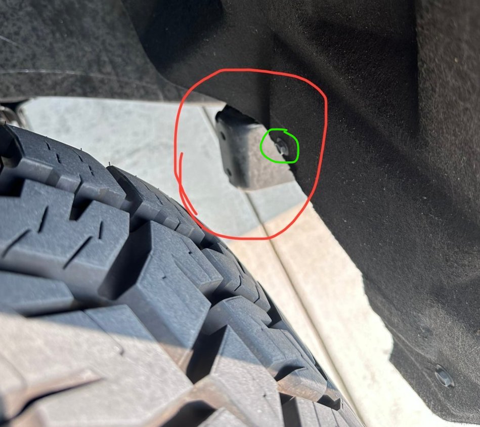

    The piece circled in red is the "body mount" the needs to be chopped off. The liner screw (circled in green) goes to the bracket that can be unbolted, allowing for the liner to be tucked back even more.
