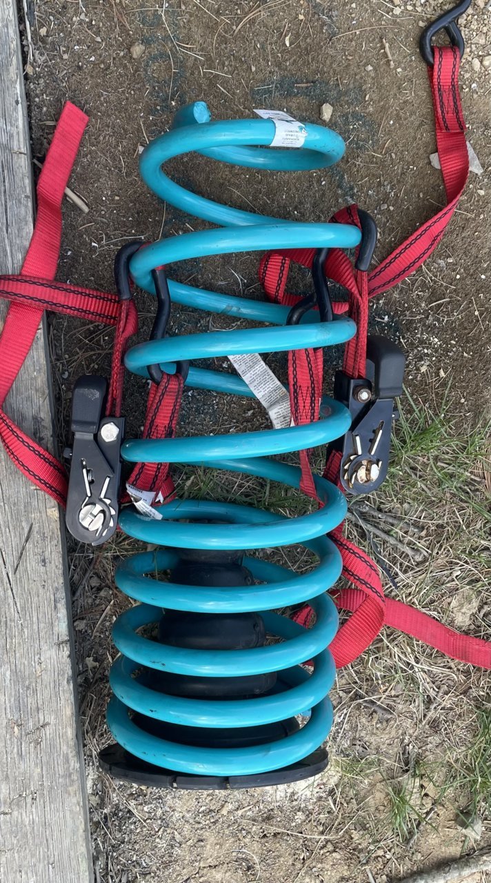

    357
    2022 Tundra, SR5 Offroad, Lunar Rock
    I do not condone the actions in the following picture nor will I hold any liability for broken face parts or other appendages but this worked to get the C59-843Vs in when I couldn’t get them to fit.
    SC4333, Kap1, osu1978 and 2 others like this.

    I tried but my spring compressors had no clearance to take them off.
    I’m sure i need to loosen the upper control arms and trackbar to get the coil in. I was running out of time so just wrapped it up for the time being.

  7. May 17, 2023 at 6:52 PM
    #1147
    iiawah808
    iiawah808 New Member
    Apr 22, 2022
    #77470
    471
    Oahu, HI
    2022 iForce Tundra Limited TRD Offroad
    Currently Searching....
    I definitely won’t do this. But I will lol.

    disconnecting the upper links will let the rear drop a little more.

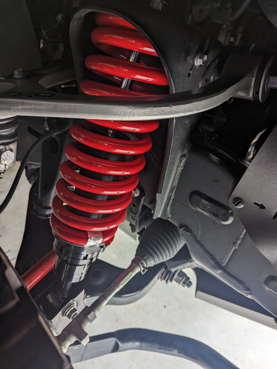

    Dobinsons has both front and rear coils available in red. Here are pics of my dobinsons 3/2 suspension.

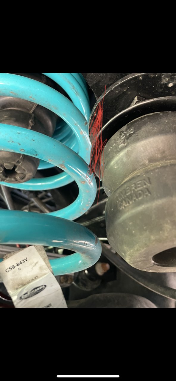

    jgoliath
    jgoliath Northeast Rust Fighter
    Jan 12, 2022
    #73005
    357

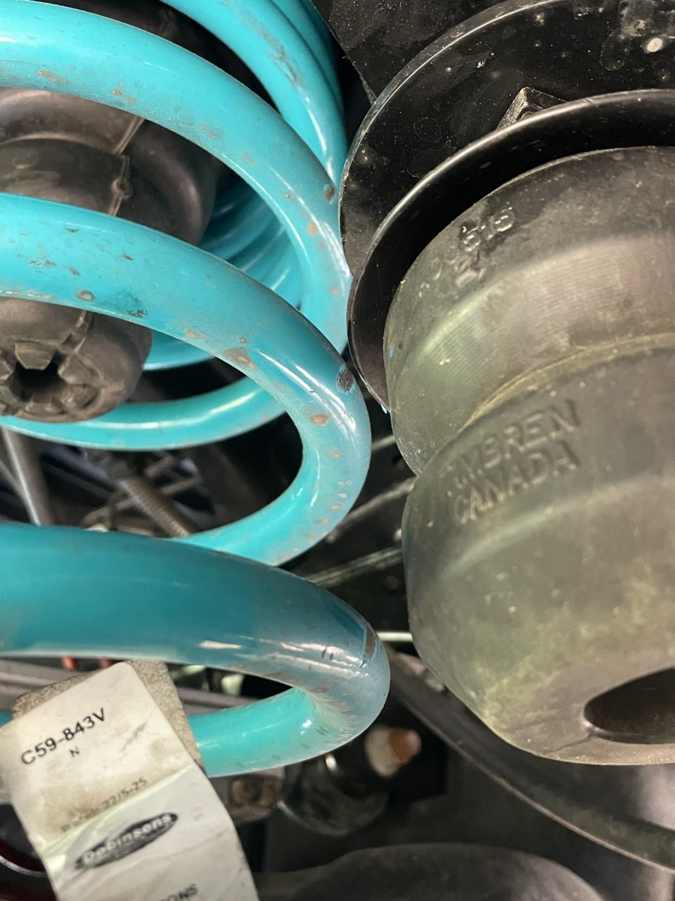

    I was messing around with some up travel limiting on the rear and found out the dobinson coils are making contact with the Timbren bump stops. So unless you’re willing to chop and modify stuff, don’t pair these two together upload_2023-5-21_16-38-3.jpg

    I’m not sure if I’d recommend timbren rear bump stops to anyone… Mine arrived rusty and bare metal in some areas
    Not a big deal but just an FYI
