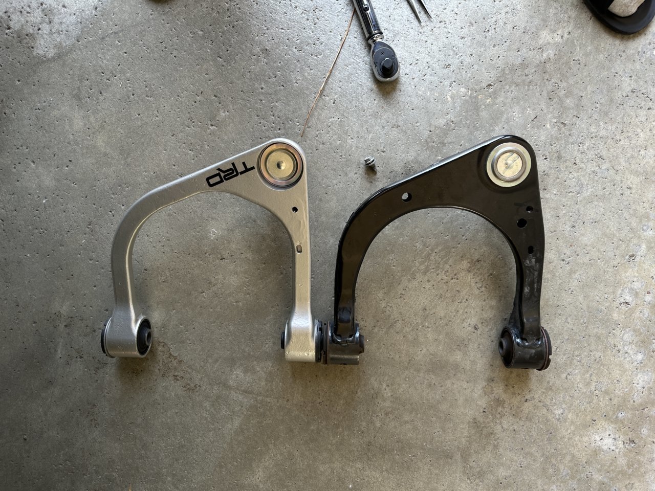

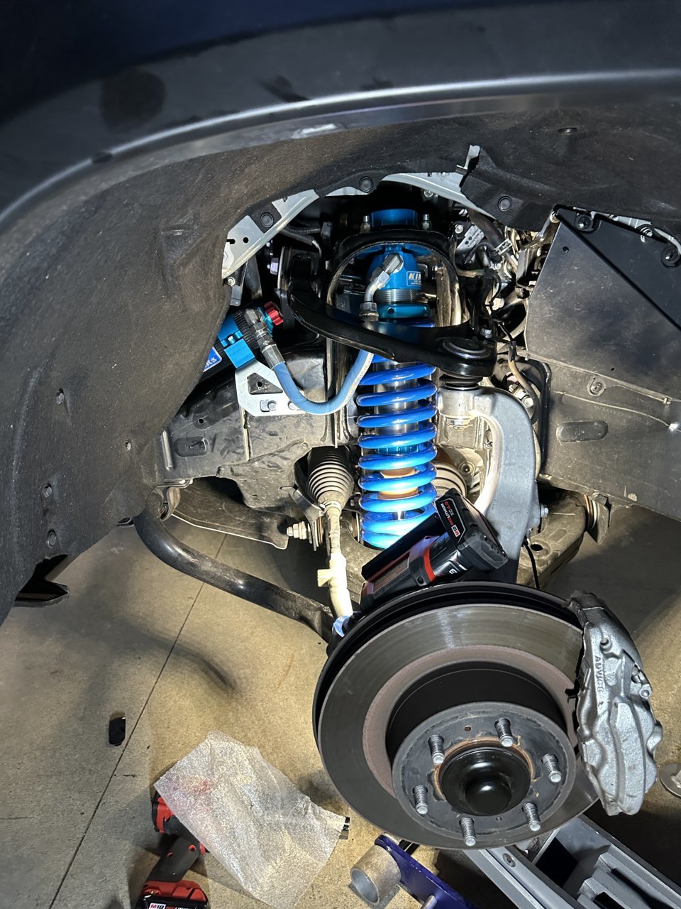

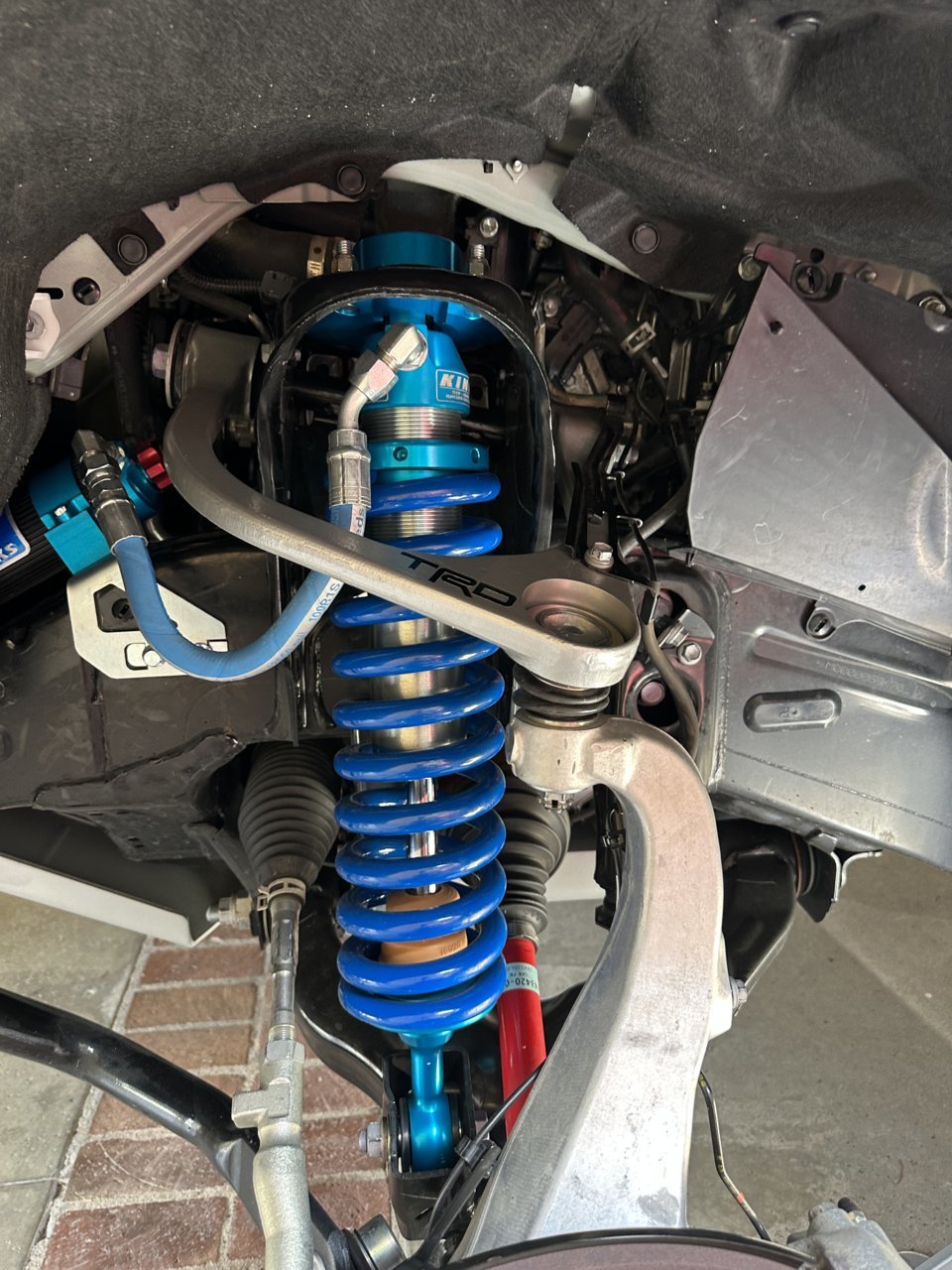

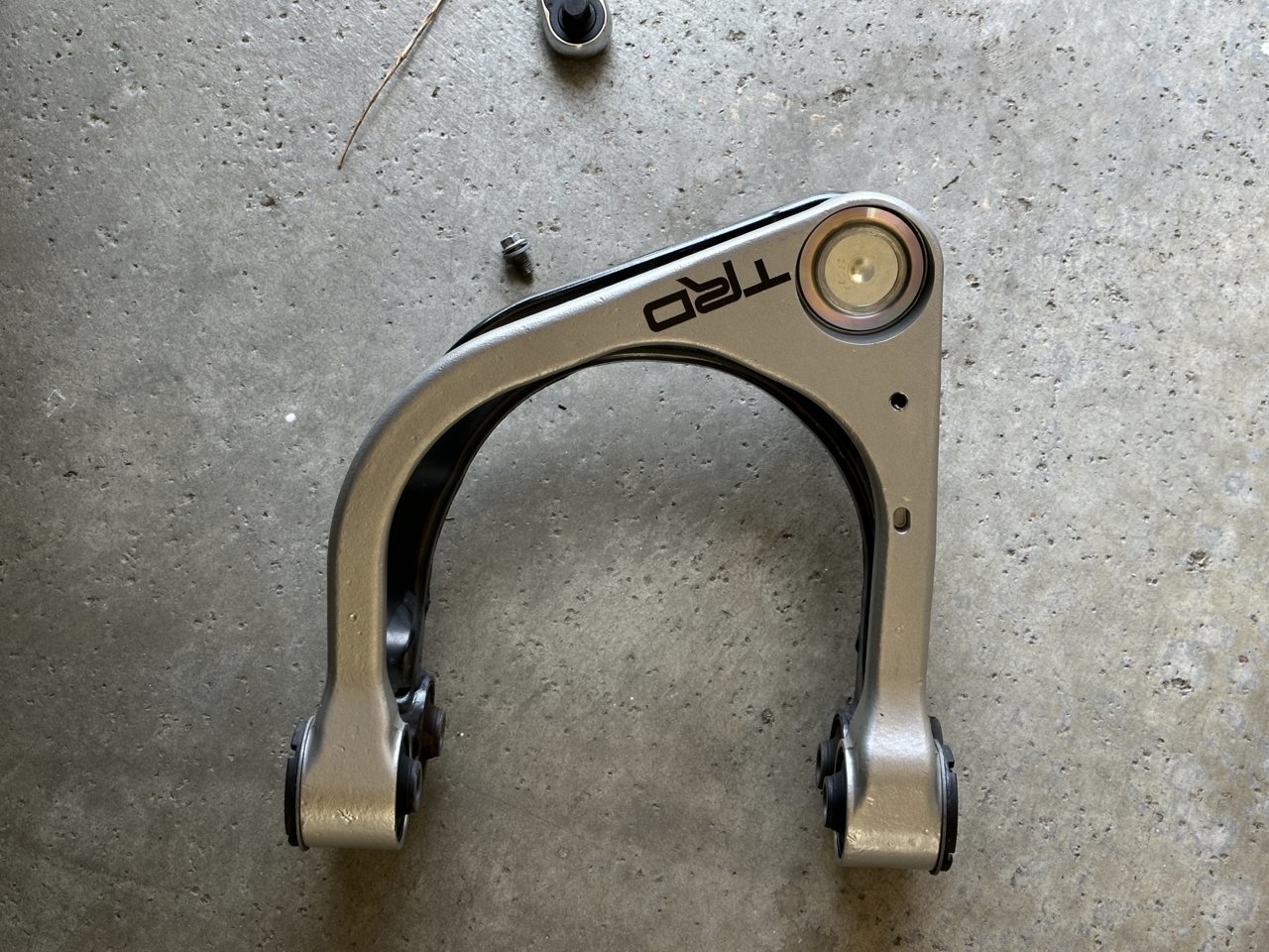

    Since my original King suspension install, I wanted to give an update.
    The original UCA was articulating fine, aligning fine and was clearing the resi hose for the King. However, it was rubbing and scruffing the hose at full droop.
    I ended up swapping the UCAs to the TRD UCAs. Problem solved. These cost me $350 for the pair. I couldn’t justify a reason to go for aftermarket expensive options. These work great.
    After driving a bit and alignment it seems these UCAs actually correct the geometry by adding caster, which also gave me about more lift.
    Caster was 2 with original UCA, with TRD it is now 4, which is the spec.
    Also gained 0.3” of more height, now 2.25” of total lift with the Kings (with 1 3/4 turns more preload).

    So you got an increase on 1/2” just by swapping the arms? With no adjustment on the kings?
    Putting my trd arms on soon!

    I’m not sure if it is a true height gain. I worked on the suspension, lifted it, etc. It may need to settle the next few days. I will report back.
    iiawah808[QUOTED] likes this.

    Zero reason you would get ride height increase just from installing UCAs.
    Yaboy likes this.

    Nice setup! Great price on the UCAs too compared to aftermarket.

    An update since I installed the TRD UCAs, drove several days and did alignment again.
    There was actually geometry change and height gain.
    Caster went from 2 to 4, which is the actual spec. Also gained 0.3” of height.
    The height gain is definitely there. With King coilovers and 1 3/4 turns of extra preload, I got only 1.95” ride height increase with OE UCAs. That seemed not to match what King was telling me. Now with TRD UCAs, the overall heigh gain is 2.25” over stock, which is in line.
    The only thing I can think of is the caster geometry change.
