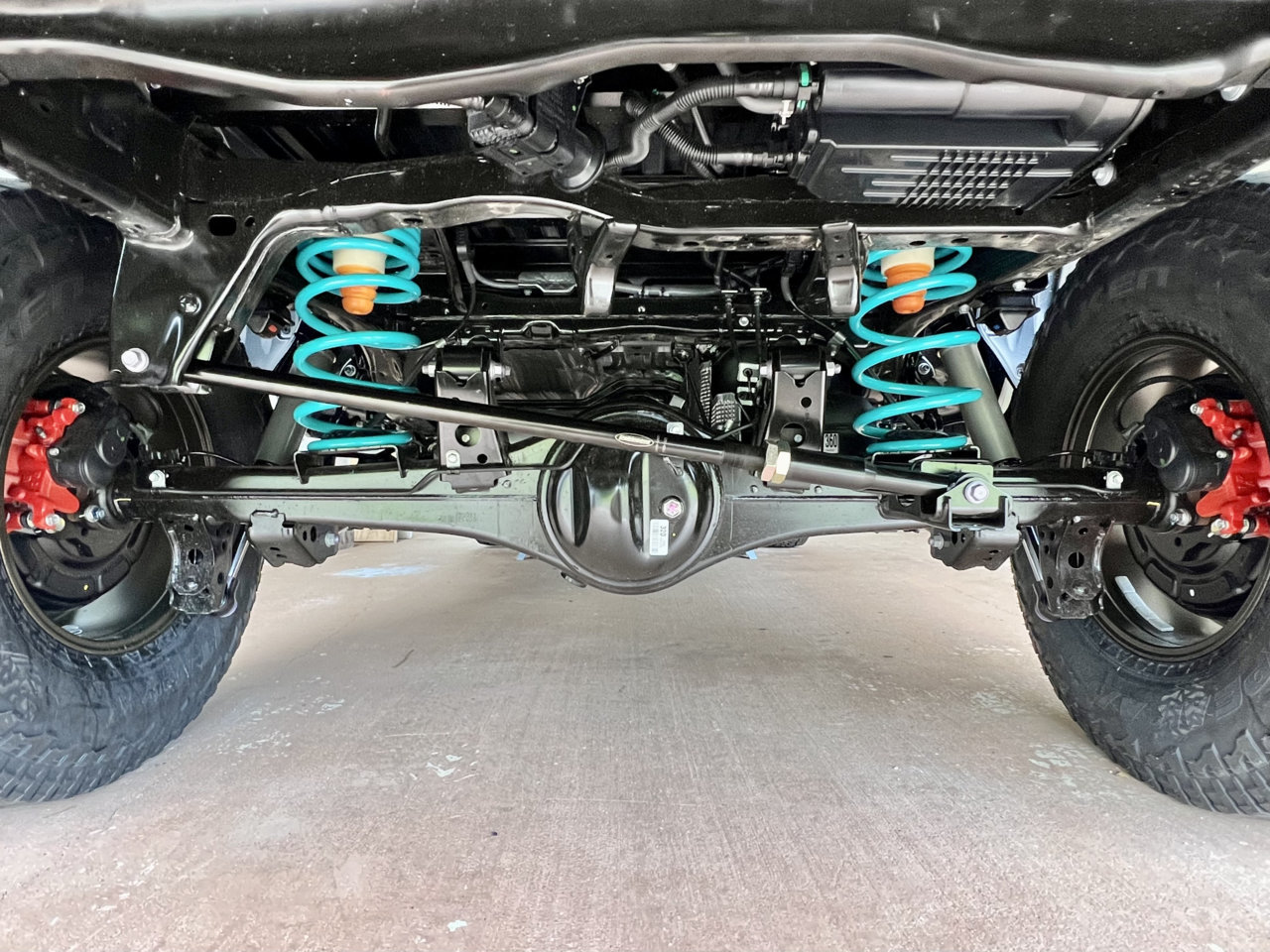

    Here’s a pic of the Dobinson’s adjustable track bar, for anyone interested. I lifted the rear 2” with Dobinson’s springs. The vehicle shifted approx. 7/8” to the driver's side. I adjusted the bar to move the vehicle back toward the passenger's side by ~3/8”. The track is now sitting evenly.
    Dobinson's track bar is super heavy duty. It makes the hollow OEM bar feel flimsy. I may consider getting their other link bars.

  15. Apr 12, 2023 at 3:21 PM
    #1035
    jgoliath
    jgoliath Northeast Rust Fighter
    Jan 12, 2022
    #73005
    357
    2022 Tundra, SR5 Offroad, Lunar Rock
    Red calipers? Why not dobinson green (or teal?)?
  16. Apr 12, 2023 at 3:27 PM
    #1036
    T-MAC
    T-MAC New Member
    Apr 4, 2023
    #94960
    98
    Westernesse
    2023 Tundra
    Icon stage 7, Dobisons rear springs and track bar, Icon Rebound Pro wheels, MT Baja Legend 40s, JB4, Pedal Commander, AFE intakes and hot pipes
    Actually, I ordered black springs, but they sent me teal ones. Being impatient, I installed them anyway. They're growing on me. As for the calipers, the color is just cosmetic but I've always had a thing for red calipers. Flashy but not garish. Teal calipers would be a bit much for me!

  19. Apr 12, 2023 at 4:03 PM
    #1039
    T-MAC
    T-MAC New Member
    Apr 4, 2023
    #94960
    98
    Westernesse
    2023 Tundra
    Adjust it by adding half the length that your truck shifted.
    So, if after lifting your truck it shifted to the left 1", then you should adjust the track bar to be 1/2" longer than the OEM track bar. Get your measurements from eyelet center to eyelet center.

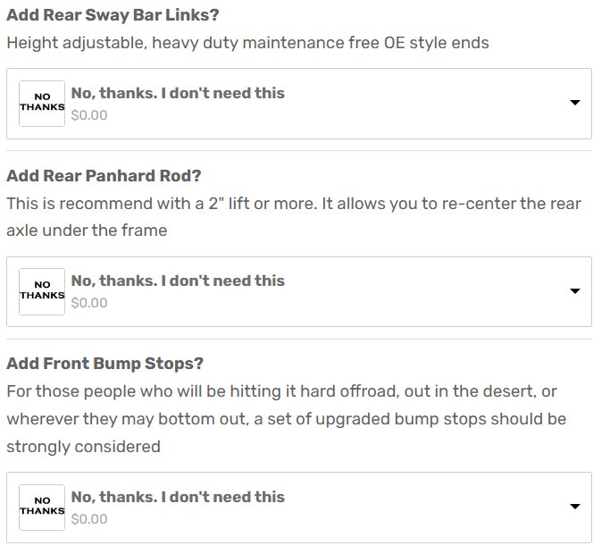

    just got my dobinson's kit in the mail, with C59-841V 2" rear coil springs. i guess i'm going to need a panhard bar as well?

    Those are the exact ones that I bought/installed. If you read up, you'll see what I had to do. I'd recommend the adjustable track bar for sure.

    Yes, 2" of lift requires a panhard rod. Or your back end will be offset to one side.

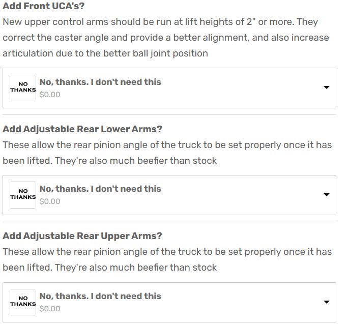

    yeah i ordered it last night. Wish they would've mentioned this on the website when i ordered the lift. just saw it as an optional item when buying my lift and figured if it was a requirement they would've included it.

    Yeah, they don't show the greatest details, unlike our website that shows why you would add all the parts.

    They don't usually make them for IFS vehicles. Dobinsons have relocation brackets on some IFS vehicles to lower the mounting point down, as it's much cheaper than new links.
