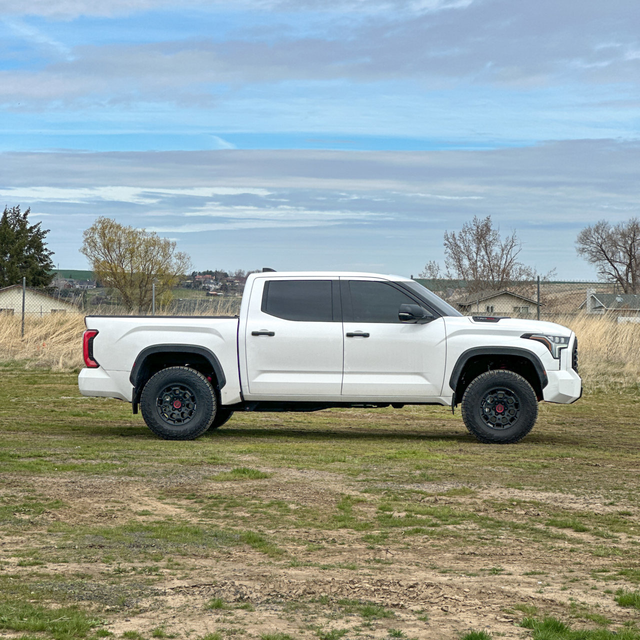

    New shoes?
  2. Apr 6, 2023 at 5:56 PM
    #992
    trailhunters
    trailhunters New Member
    Aug 13, 2022
    #81893
    104
    I don't have a full parts list, but this is what I see so far:
    • (4) Pro-Truck Lift Springs
    • (4) Pro-Truck Sport Shocks
    • Factory UCA (I supplied TRD aftermarket UCA but they didn't use)
    • Factory CV axles
    • Possibly some sway bar drop brackets
    Yep. TE37XT on 315/70/17 K02. KO2?

    Is this pic with the Eibach test kit or something else?
  4. Apr 6, 2023 at 11:47 PM
    #994
    trailhunters
    Aug 13, 2022
    #81893
    104
    Yes it has the Pro-Truck kit installed in the picture.

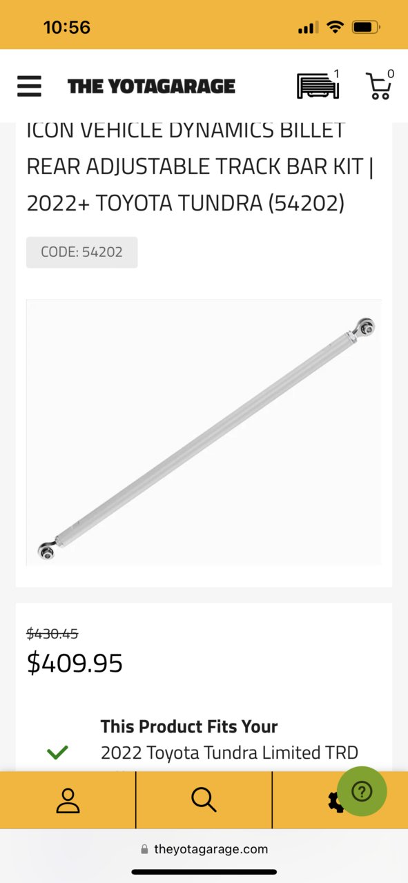

    Hello everyone,
    I'm new here. Came from the Tacoma World, but just bought a Tundra.
    I recently installed Dobinsons C59-841V rear springs in my 2023 Tundra. The spring specs are 2" Rear Lift, Stock Weight, 0-110 lbs. I will rarely carry heavy weight in the bed but I will tow a trailer once or twice a week (I'm running Icons up front with 3" of lift. I like a slight rake.)
    Anyway, due to the added 2" of rear lift, the rear axle has shifted to the left about 3/8". Can anyone tell me if this going to impede ride quality or suspension performance? Is the geometry of components going to be stressed over time?
    A few companies sell track bar relocation kits or adjustable track bars. I'm not sure when these items should be employed on suspension lifts. Any advice is appreciated.

    How did you measure the 3/8"?
    I see @TOTAL CHAOS has a nice kit for the rear, I wonder if they will sell their Panhard separate from the whole kit..
    T-MAC[QUOTED] likes this.

    Roughly, dropped a weighted string from a determined point on the fender above each rear tire. Measured the distance from string to wheel center.
    Total Chaos looks awesome. Still wondering if it's needed at this point.

    My experience, in working with Jeep Grand Wagoneers with a track bar in the rear, I would say yes. Back then I would see a slight shift in the rear axle to one side and I would feel one side felt more "sprung" than the other. Many wouldn't notice it but I as the driver of that vehicle did. The solution is to adjust the bracket on one side, although it helps that the Tundra has a rear sway bar to compensate.

    Call Dobinson Direct... they are more then willing to help out. My guess with the 2" lift in the rear, you will need to upgrade your Panhard rod.

    Get an adjustable pan hard bar if you want to centre it. Not the worst not to have it but that’s what you’re looking for. Dobinsons has one but this pic was faster

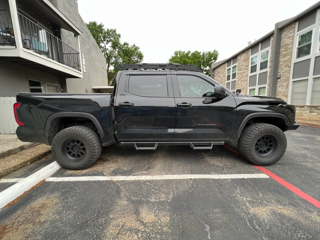

    KING 2.5 suspension all around w/ Westcott rear arms. 35” Toyo Open Country AT3 Method 18” 305NV Black on Black ICON Billet UCA’s TRD Filters Diode Dynamics SS6 Amber Fog Lights

    Been saying this forever, all y’all that are lifted need adjustable panhards! I’ve got the dobinsons one and have had it since adventure motors did my lift 24hrs after purchase!

    This is what you need to center the axle
    https://exitoffroad.com/product/dobinsons-rear-adjustable-panhard-rod-for-toyota-tundra-2022/

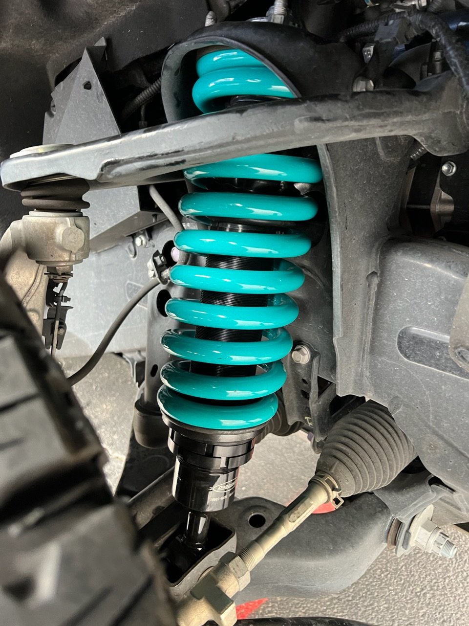

    Just ordered one too.
    Lets see your truck , I am installing the same Dobinsons IMS 2" front and rear in a couple of weeks.

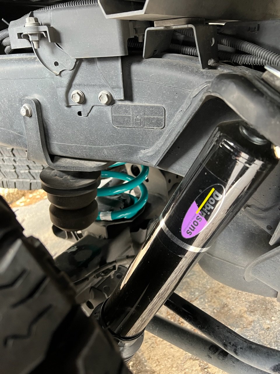

    Some more photos of my Dobinson’s IMS kit. 2” in the front, 1” in the rear D3910DA1-9842-4707-AEB5-EBEB5A419F04.jpg 5892A9A3-80F2-4370-A395-26288C004028.jpg 4FD0622E-36B4-4CF5-8C28-2A2E3C16C2A0.jpg

    Are those upgraded bumpstops in the rear?

    Yup, durobumps in the front and timbrens in the back

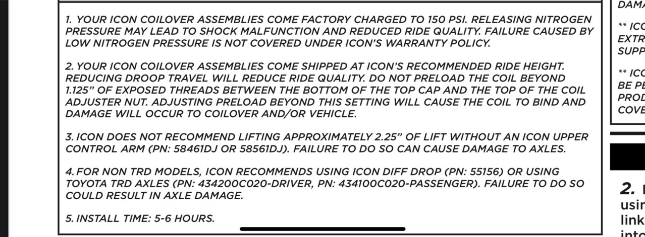

    I could be wrong but is the diff drop needed with a 3/2 lift?
    i ask because I don’t seem to hear much about it on here and it doesn’t seem like it’s something the TRD OEM kit talks about for a lift of the same height.

    Icon is including the following recommendation in the installation literate for their coilovers.
    #4 says they recommend extended axles or their diff drop.
    I’ll be maxing out my coilovers to fit 37’s and achieve a slight rake to go with the rear 2” lift. So, I want to exploit every advantage for functionality and longevity.
    bigjuice[QUOTED] likes this.
