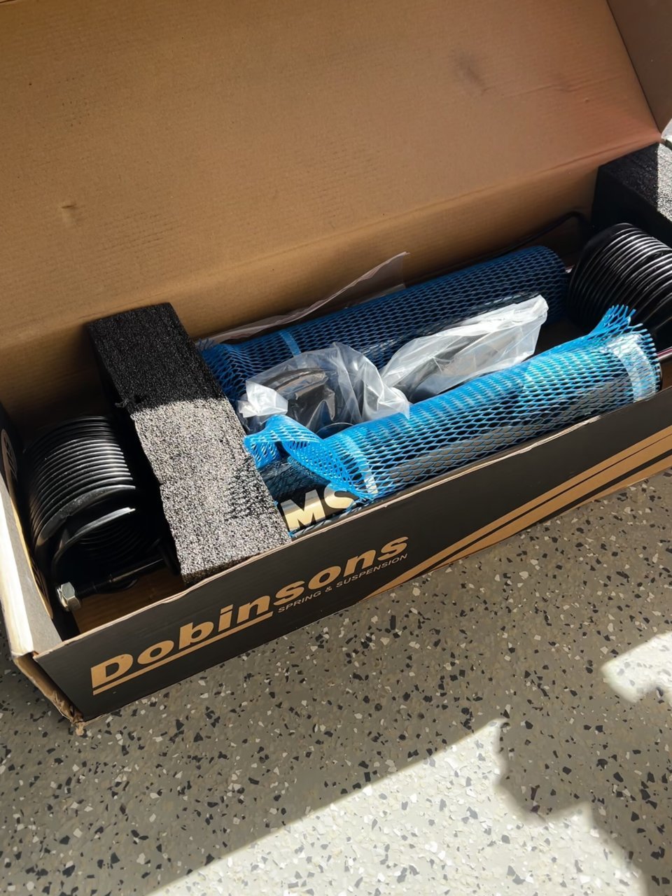

    Reading this while watching motorcycle suspension vids was a good help lol. Thanks for this.

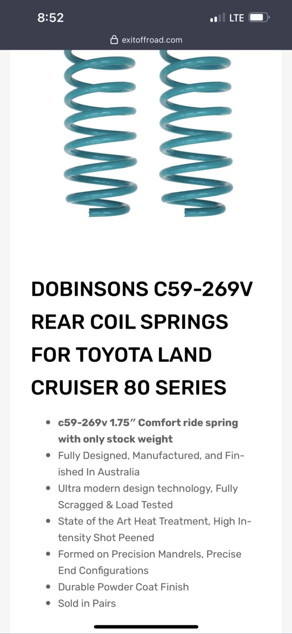

    I am a little new to this so let me know if I am overthinking it but wouldn't the drop for a 70 lbs diamond back be ~1/8" of an inch since technically you have two 250lb springs sharing the load in the rear? 70/500 lbs = roughly 1/8"? Or does the 250lb spring rate contemplate two springs already?
  5. Feb 12, 2023 at 6:48 AM
    #815
    osu1978
    osu1978 New Member
    Nov 4, 2021
    #70235
    241
    It uses the Fox springs but Toyota claims no additional lift.

  7. Feb 12, 2023 at 12:36 PM
    #817
    KroppDuster
    KroppDuster [OP] A normal guy trying to survive this crazy world
    Dec 7, 2021
    #71535
    2,005
    Here. There. Everywhere.
    2021 SR5 TRD Off Road - Cavalry Blue
    Bilstein 5100s
    You know...this is a solid question, and you're quite right. I guess the coffee hadn't kicked in when I posted that at 7:50am. lol. A 220/lb spring, as an example, would have a parallel spring rate of 440/lbs when used on the same axle.
    To your point, the drop would be an 1/8" vs 1/4".

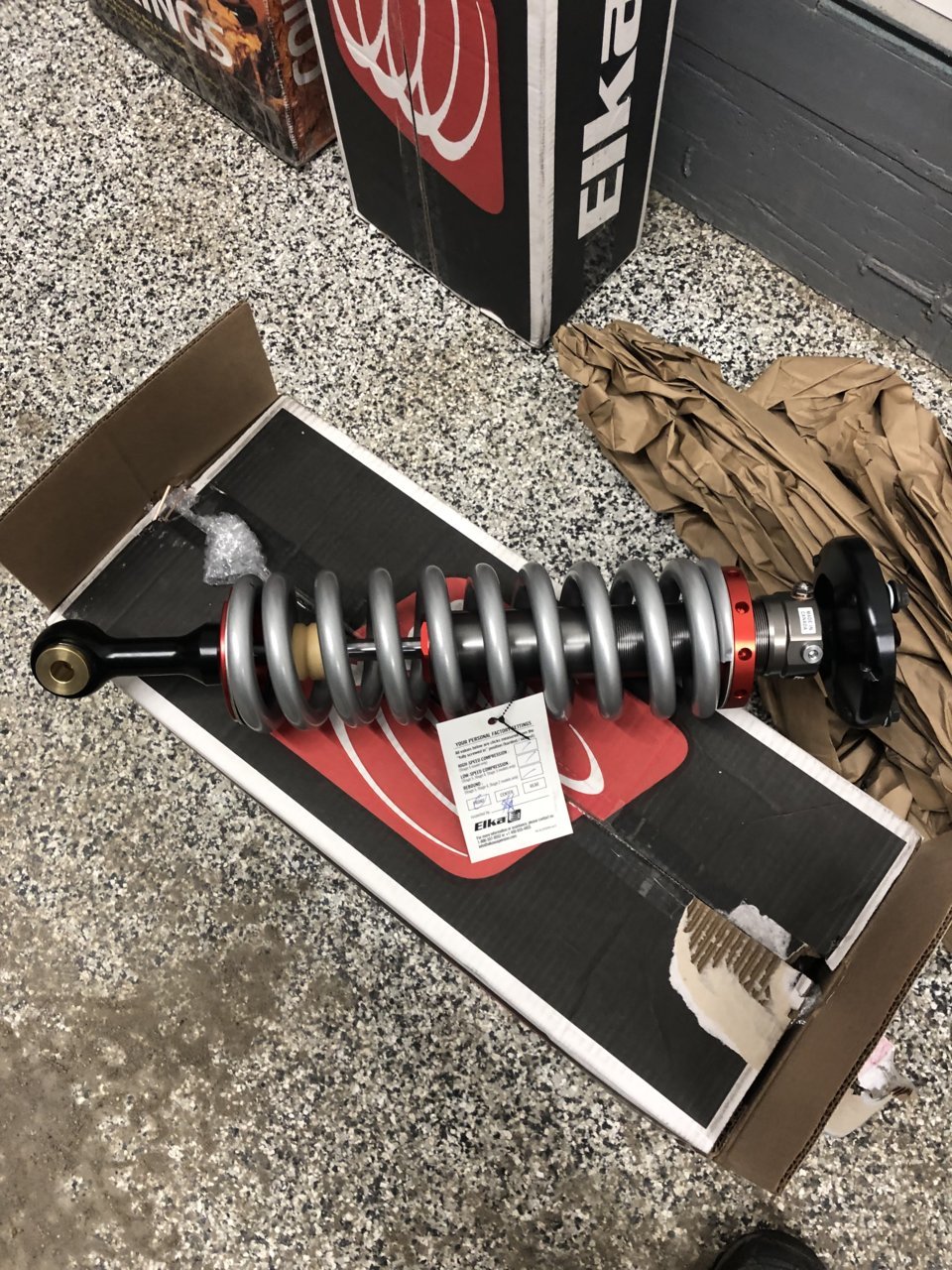

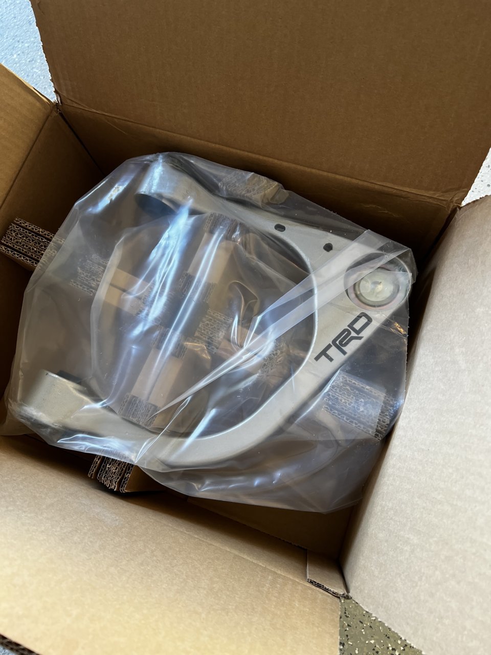

    I got my parts ready to go.
    I went Elka 2.0 in the front preset 2.75” to see how the rake is with 2” rear springs, I wanted 2.5 but it comes down to total cost for the lift plus the truck
    dobinsons IMS for the rear because they were only $200 more then the 2.0 Elkas but much cheaper then the 2.5 Elka that’s why I mixed and matched shocks
    got the TRD lift UCA it’s a good price and nice OEM part, I would have loved TC but it’s priced out for me
    I originally wanted to go with the TRD 3” lift so I’m using that 3” front 2” rear as a baseline. I like to have an adjustable front end for rake and a spring not a spacer in the rear so that’s how I came up with this setup. I have OME 2866 springs and ICON bump stops front/rear, my total cost in parts is $3900cnd

  17. Feb 15, 2023 at 10:26 PM
    #827
    Keopi
    Keopi New Member
    Feb 9, 2023
    #91732

  19. Feb 15, 2023 at 10:53 PM
    #829
    Kap1
    Kap1 New Member
    Jan 30, 2016
    #2569
    1,466
    San Francisco, CA
    2022 1794
    Wow what ya got there? I've been thinking of elka as well, tell us more
    Yaboy[QUOTED] likes this.

  21. Feb 16, 2023 at 8:42 AM
    #831
    Yaboy
    Yaboy New Member
    Mar 18, 2022
    #76004
    474
    Canada
    22 limited off-road
    I’ve edited my original post to have more info

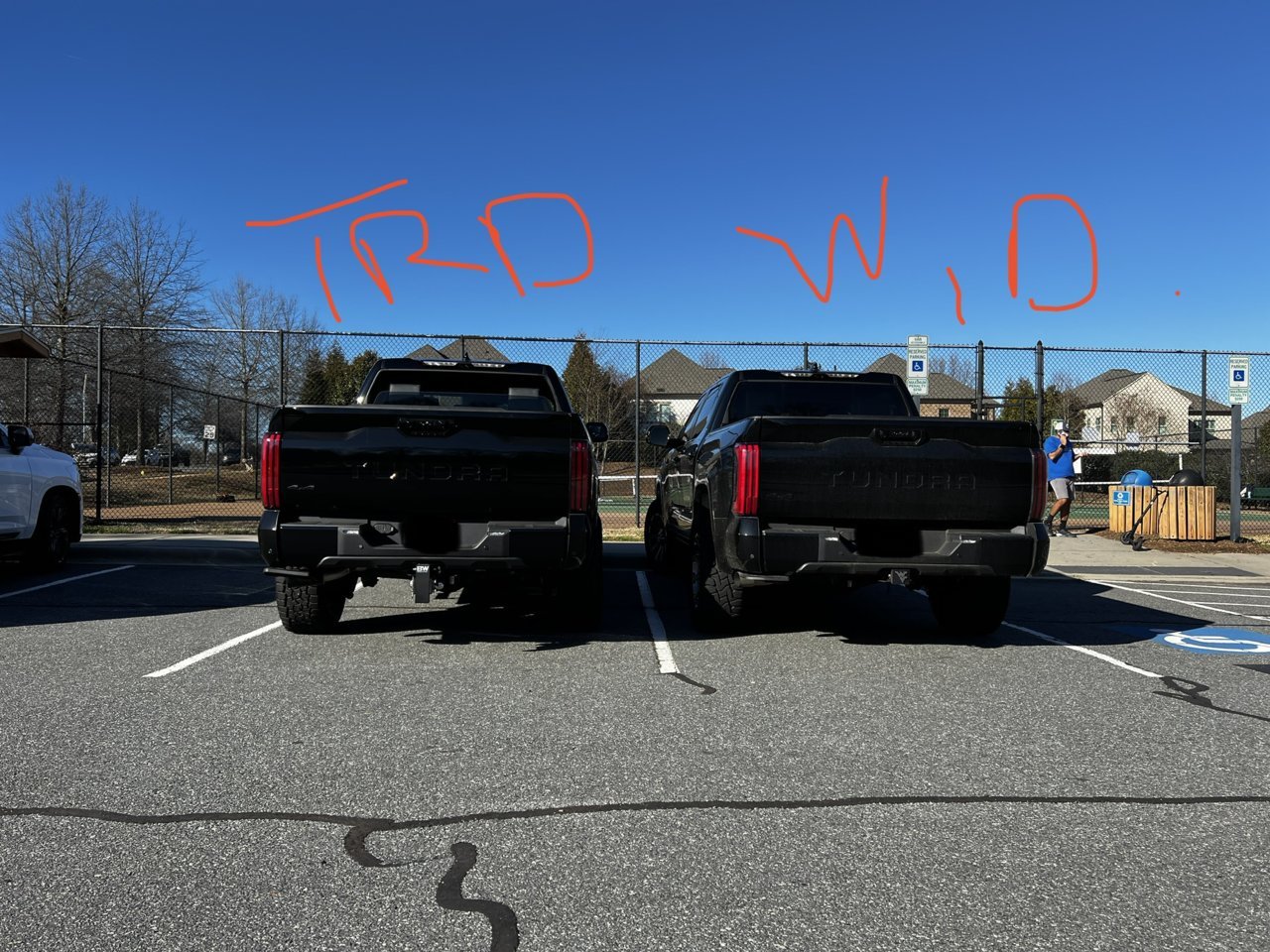

  22. Feb 19, 2023 at 5:03 AM
    #832
    clrprop
    clrprop New Member
    Aug 2, 2019
    #34037
    11
    for anyone looking for comparison..
    I have a Trd oem lift, my buddy has a Wescott 3/1. His has the AVS, mine does not. Mine sits noticeably higher in person. He’s running 20x9 on toyo rt 35 and I’m running 18x9 toyo at3 35
    look at roof lines and side mirrors.
    RookieEP, dan81, Yaboy and 2 others like this.
  23. Feb 19, 2023 at 7:09 AM
    #833
    KroppDuster
    Dec 7, 2021
    #71535
    2,005
    Bilstein 5100s
    Makes sense. The front is close but the rear is quite noticeable. The TRD kit changes the front springs to a slightly heavier spring. The WD lift is a basically a leveling kit. The TRD lift still leaves a rake for payload in the rear. That’s why the TRD lift uses a 2” spacer in the rear. The WD is only a 1” spacer in the rear.
    Oh what a difference 1” can make.
    “That’s what she said.” - Michael Scott
    Did you take any measurements?
    Justinfro and clrprop[QUOTED] like this.

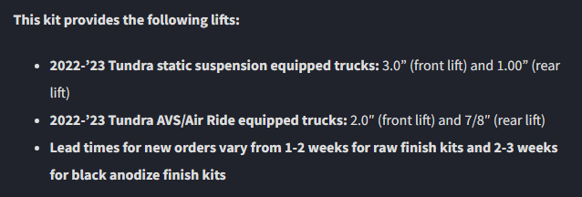

  25. Feb 19, 2023 at 11:23 AM
    #835
    clrprop
    clrprop New Member
    Aug 2, 2019
    #34037
    11
    my ride is great! Steering is stiffer than stock (which I like) I got load d tires specifically to help with the ride too. It’s a truck at the end of the day but the TRD kit feels considerably better to me than the westcott. NOT saying anything negative about their lift or design. I just personally prefer the trd kit.
    I’ve had a lot of modified vehicles. I wanted to keep as close to oem or oem supported as possible. The trd kit just fit what I wanted to accomplish. Doesn’t make it the perfect ‘one all’ kit. Just checked a lot of boxes for ME.
  26. Feb 19, 2023 at 3:21 PM
    #836
    TakiEvo
    TakiEvo New Member
    Dec 28, 2021
    #72363
    654
    Allentown, PA
    2022 SR5 TRD Sport Crewmax White
    If your buddy is AVS/air ride truck. AVS with Westcott lift is only 2 inch front and 7/8" rear according to westcott. The rear is not a spacer, just a adjustment arm cause airbag. That's why it's lower.
    Yaboy likes this.
