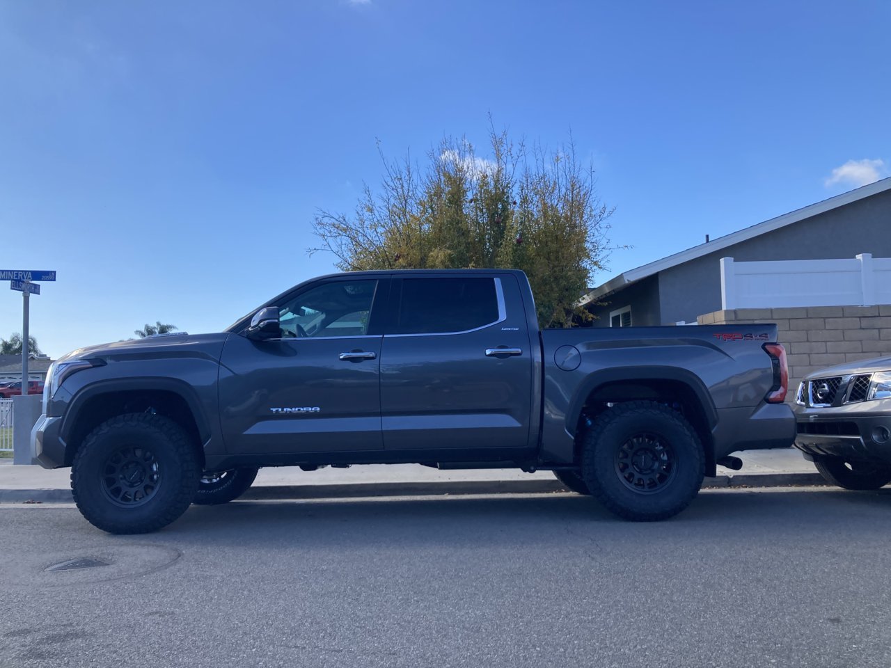

    Hey guys,
    I just finished up my truck (for now) and figure I’d add what I could to this threat. I’ve got a 23 Limited Hybrid with the TRD OR package. I went with Total Chaos’ UCAs, Links, and Kings. The truck is also sitting on Method 703’s and BFGs.
    TC’s customer service was beyond exceptional, they were able to get me on their waitlist for Kings and hit me up as soon as they had them. Pat actually held a full set of parts for me for a week while I was away dealing with a family emergency and not able to email him back immediately. Oddly enough, the suspension beat the truck to me.
    Install went pretty well, although the shop that did it did find something which required a little fab work. The OEM right rear link has a ride height sensor that the TC link couldn’t accept. ORW ended up welding a bracket onto the TC link to allow the sensor to work, neither they or TC had ran into that yet with the Tundras they’ve worked on. I’ve also sent images of what ORW did to TC, since they hadn’t mentioned it to me prior.
    *Side note: If you’re in SoCal I can’t recommend ORW Corona enough. I’ve used other ORW’s and 4WP and the Corona shop is heads above in every way.
    Below is an example of the sensor linkage.
    As far as the front, I’ve got about 11 threads showing on the coilovers and no rub I can ascertain with my wheel/tire combo. Rear is using stock coils and the truck sits pretty level.
    For wheels and tires, I’m using 17” Method 703’s with a +35 offset (6.2” backspacing) and 35x12.5 BFG KO2’s. This combination fits beautifully and tucks very well. As an aside, I was able to fit a full size spare under the bed. My BFG’s are about 34” right now and that’s as big as they could be and still fit under there without hitting the panhard bar.
    It’s close, but there’s at least .5” of room with the tire stops unmodified. The tire sits low, but still about .5-1” above the bottom of the rear diff.
    Overall, I’m exceptionally happy with the truck and build. I was not a fan of the OR suspension, the TC and Kings firmed the truck up and eliminated a lot of the roll I previously had, while still feeling comfortable compared to the Icon kits I had on my previous Tacoma.
