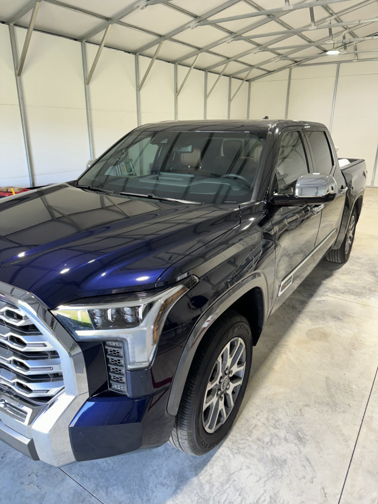

    I’ve owned a 2023 Tundra Limited since April of last year. I am sorely disappointed with the quality of paint - allover the entire vehicle the paint is orange peel, like the hood, bed, all of the doors. I am aware that there should be some stronger textured paint on the bottom of the doors, etc. and those area are the best looking spots on the truck. Without anything hitting this truck, paint has come off the flared section of bed above the tires. This paint cannot withstand high rates of speed.
    I’ve tried working with the dealership on this (i.e. trade it) and the quote I’m receiving to trade my truck is disgusting low. 3rd Gen does not hold value at all. Purchasing the 23 Tundra is proving to be an enormously expensive and disappointing life lesson. I’ve started to look at Fords. Never again Toyota.
    Has anyone else tried to work with Toyota to resolve the poor workmanship/quality of the paint?
