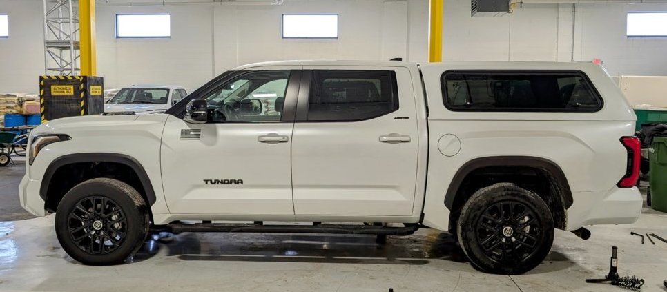

    Looks great! I have the same truck, trying to do the same thing. Did you have to do anything besides the 5100s? New UCAs and CVs? What coils did you use?

    Looks great! I have this same truck. Would you mind posting a picture outside so we can see the tire to fender well clearance a little better? Are you still happy with it?

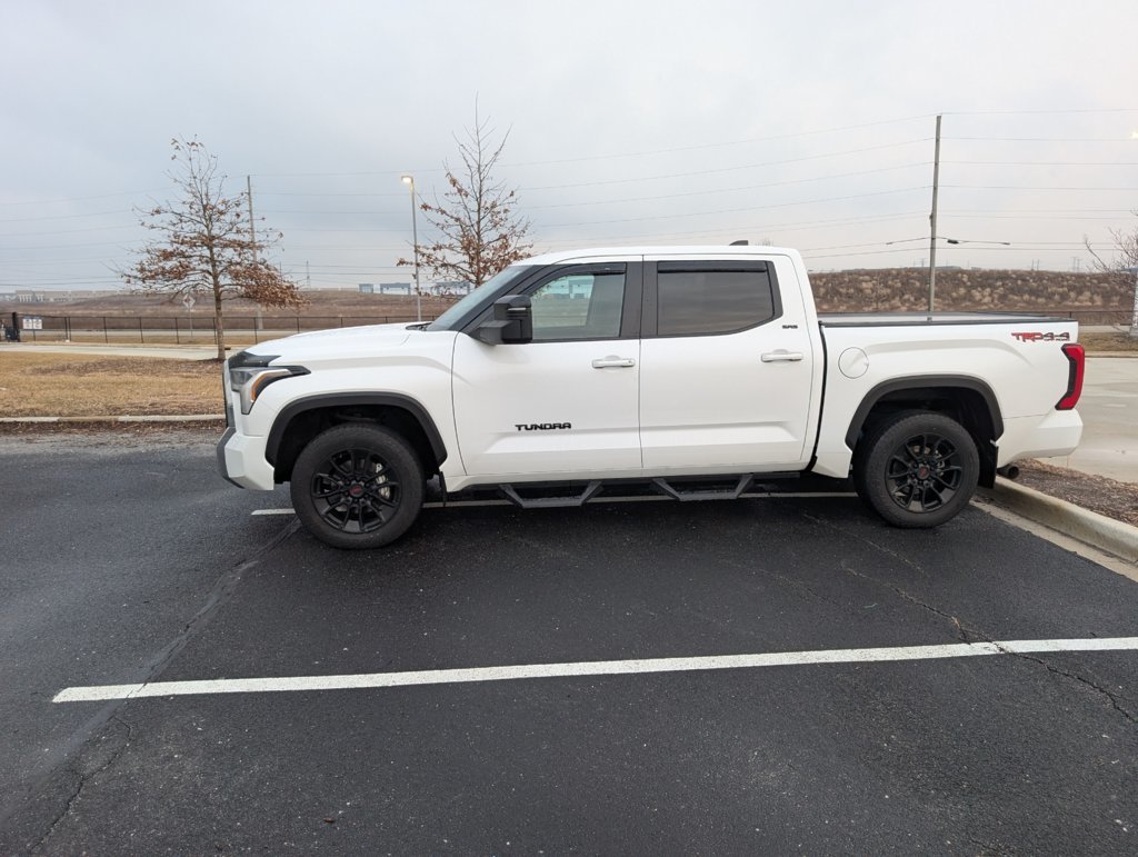

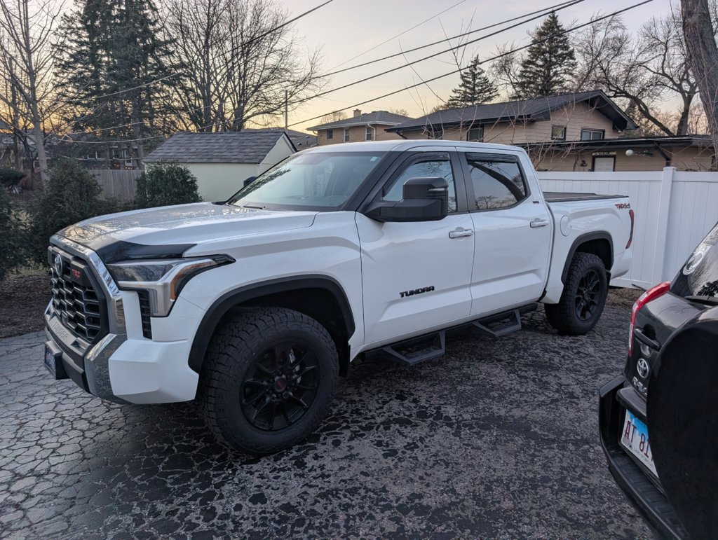

    OK, so I finally got the 1.5" Fabteck kit installed along with a 285/65R20 Falken Wildpeak AT4W. I love the look and there is zero rubbing

    Before and after

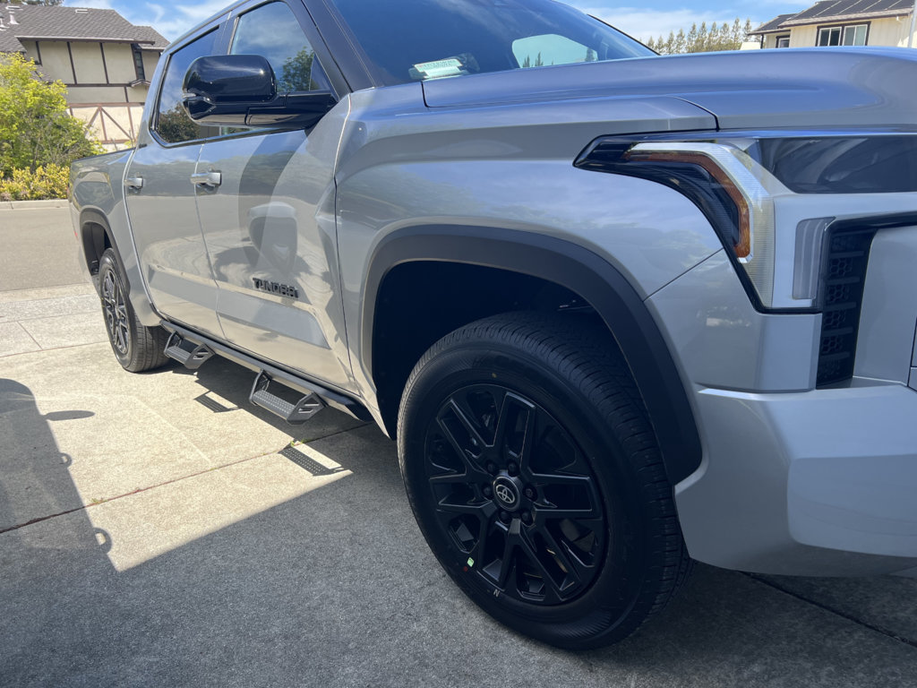

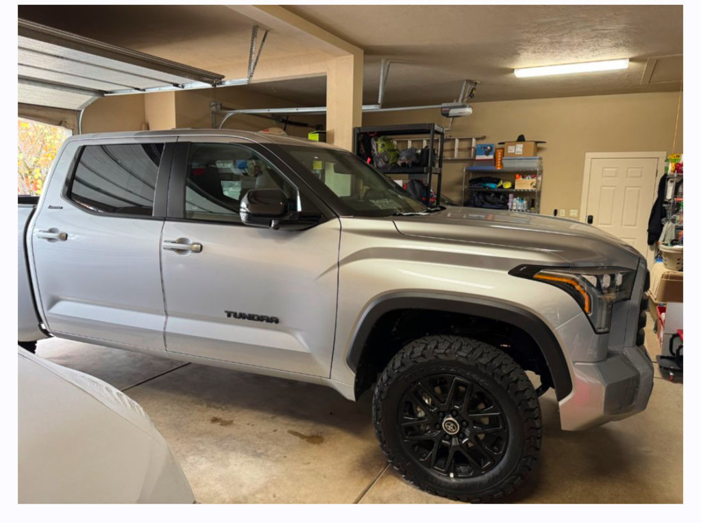

    Here’s a photo of a 2024 non TRD running a Rough Country spacer and 295/60r20 K03s I test drive before purchasing mine. It was slightly stiffer than my stock suspension 2025.

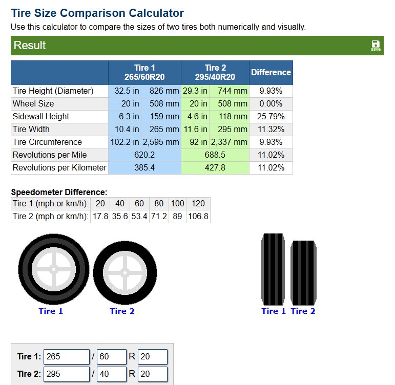

    I'm not sure if that was a typo on not, but here's a size comparison from stock to your desired size.

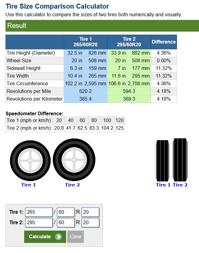

    Assuming you meant 295/60/20, which makes much more sense. Here's that comparison.
    I'm in a Limited non TRD and thought, through my research the Fab-Tech 1.5" was the perfect level.
    https://fabtechmotorsports.com/product/1-5-leveling-kit-ftl5606/
    It ended up being just a hair too high in the front, so I corrected with a Cornfed .5" rear spacer. https://cornfedsuspension.com/cornfedtundrarears/
    If I had it to do over again, Id have gone with the Cornfed 1" spacer because I didn't want to mess with the rear, initially. https://cornfedsuspension.com/cornfed2nd3rdtundrafront/
    That being said, I'm not at all unhappy with how it sits. It's completely level, and I'll eventually go to a 275/60/20, when its time to replace the factory tires.

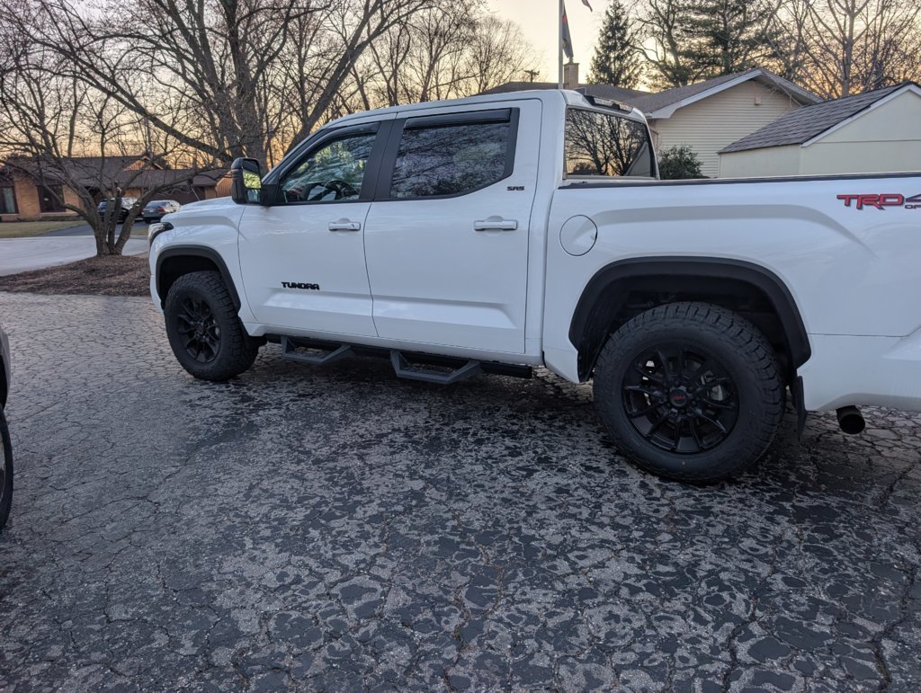

    Here's the truck leveled, front and rear on stock tires, hope this helps.
