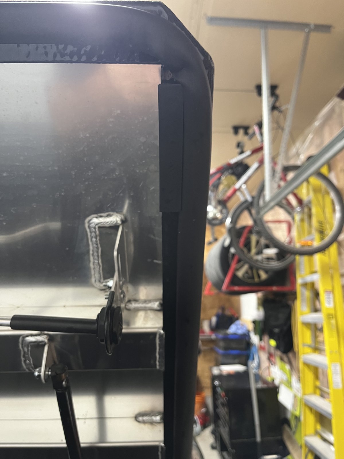

    Does everyone have/know what this little black “block” is for? It actually sits on the rail cap and prevents the gasket from being compressed fully.
    the cab panel doesn’t have this, so is it so the tailgate can open? Or is it an assembly item that was left on in error?
    not sure if it has anything to do with the leaking??

    Is that a shipping block? I don’t think I have that block.

    I have no idea. It’s on both sides, and only on the tailgate panel. I’m pretty heavy so I couldn’t figure out why the tailgate panel wouldn’t compress like the cab panel. This is why.
    it’s either not supposed to be there (unless everyone else has it) or it prevents over compressing so that the tailgate will still open?
    I’ve emailed diamondback on this.

    ^ I think I’ve found my answer. DB has an instal instructions for a “compression limiting kit”. It appears my cover has this installed. It’s to prevent binding of the tailgate if a heavy load is on top of the tailgate.

    I also have the "compression limiting kit" installed on my DiamondBack SE cover. I have no issue getting a proper seal between the weatherstripping and the bed rails.
