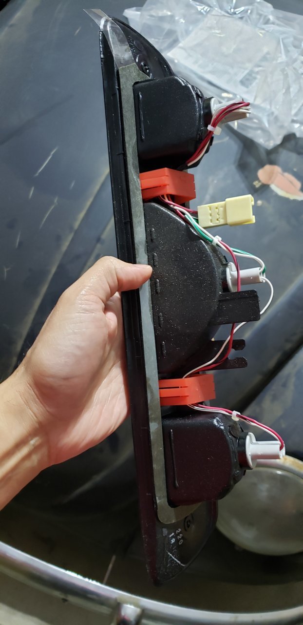

    Yes. My OEM assembly came with a new seal. It's on my build thread somewheres. Mine was not leaking, but the seal was nasty.

    Hey whaddaya know! It does! Peal and stick.

    Yup. Piel n stik

    Huh. What was it made out of? Did it seem like the door sheet adhesive? I'm not even sure what that door stuff is but I feel like I should know by now.
    I don't trust the generic Chinesium foam seals in scAmazon, foam breaks down over time and I've fought many a leak in 10+ year old vehicles because the dealer opted to use foam seals.

    It was like a foam seal as you bare describing. Mine never leaked. The only reason I changed it was because incandescent bulbs had burnt holes in the housing. If the lens gasket ever went bad that would have been a definite leak inside the cab.
    For me, I was being proactive and new housing is slightly brighter than old housing.
    Here is my build thread post. Not very many pictures, but hope it helps.
