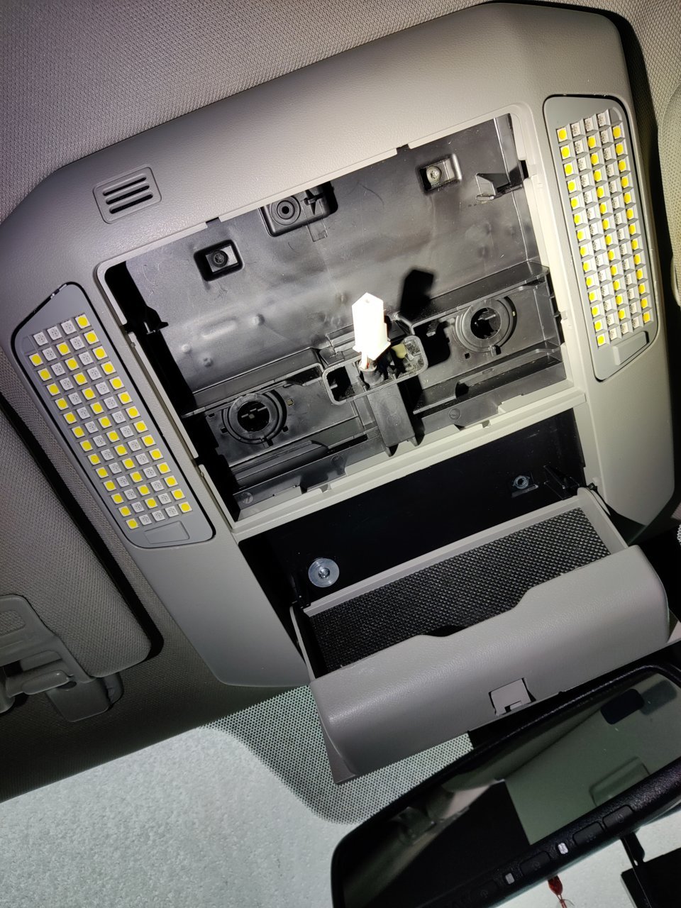

    Yeah, not hard. Take the driver side A pillar off and go from there. Couple screws and bolts. Cleaner way to route your wire IMHO. Next you'll need need a T20 screw and a screw driver for the headliner console. Pull apart the paper valet holder from the overhead console ( snaps on/snap off kinda thing) unscrew a set of screws, then open the sunglasses compartment and there's another set of screws. Comes down easy after this.
    The only one thing I found the most hardest thing to do on the truck was wiring through the fire wall. Silicone and soap is usually a must for this stuff

    Will be updating this thread soon. So far just did the cutting with a dremel and it was definitely a PITA in a cold garage. OP I think there should be a option for the envelope holder (alongside with the 8 gang panel holder) that pops off if I could make a recommendation.

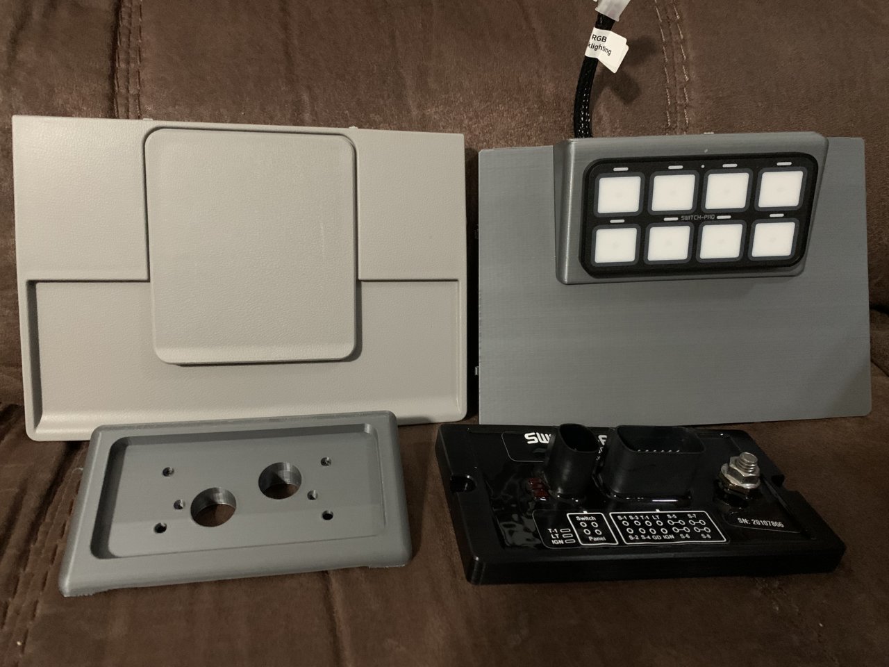

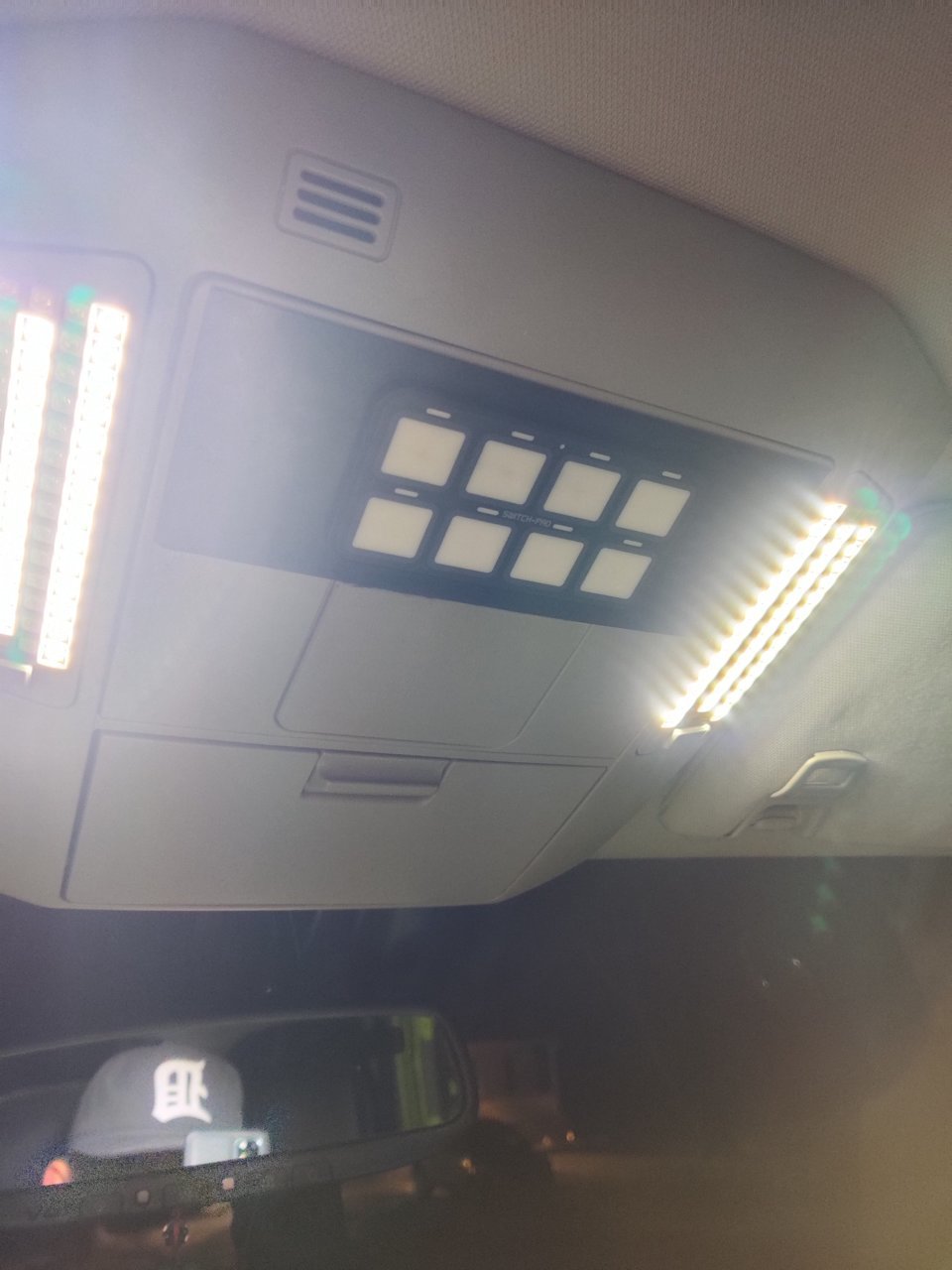

    It's finally done and installed! My lazy arse finally got to it! And the worse part about it was doing it in the freezing cold! Lol

    Nice work, clean install!

    I will mention that if you do get this. There will be some Dremel work as far as installing this. I discussed with the OP about switching the molding of the card holder or doing another toggle bracket there. I pretty much botched mine but none the less but waiting for his draft still.

    There's a couple screws behind but don't botch it like how I did. Hand tightening recommended :anonymous:

    Nothing too big. I used too much torque and drilled the screw past the plastic lol. The holes to this mounting solution was hard to gauge exactly mark it and drill pilot holes. Touch it up with epoxy and super glue to ensure the mounting solution will stay. Let's just say botching part is covered up by the mount. If I had any advice measure 10 times and cut

    Well like you said..it’s covered by the mount. It looks good.
