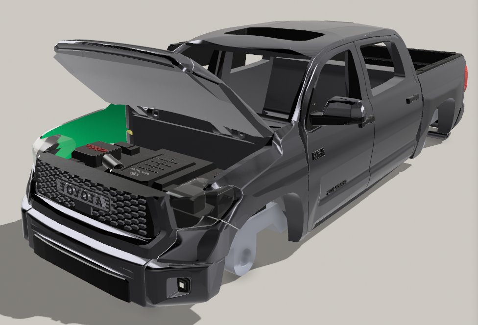

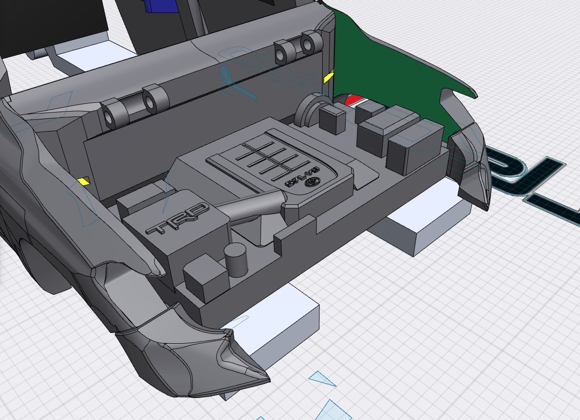

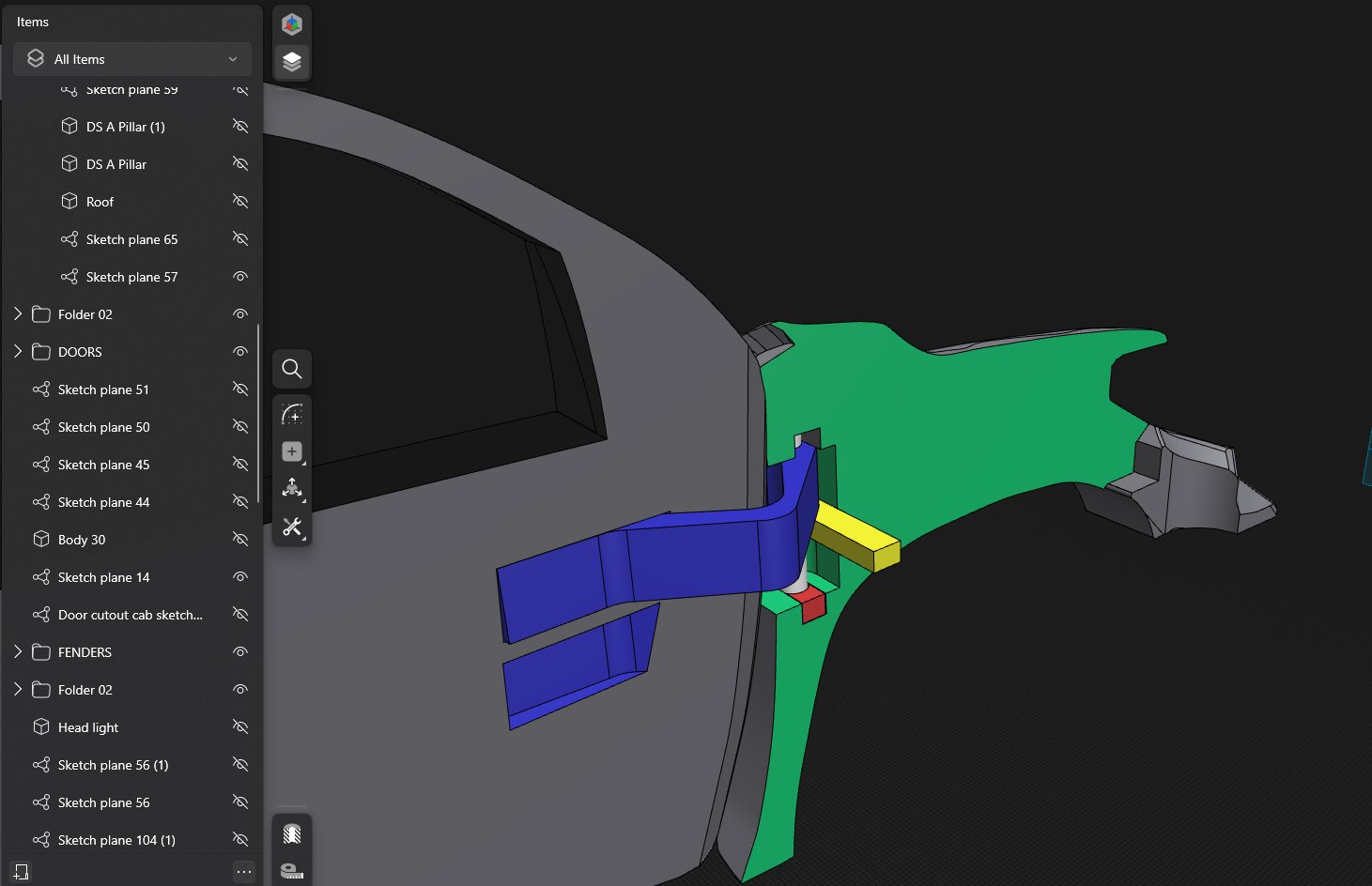

    Not so elegant door hinge solution:

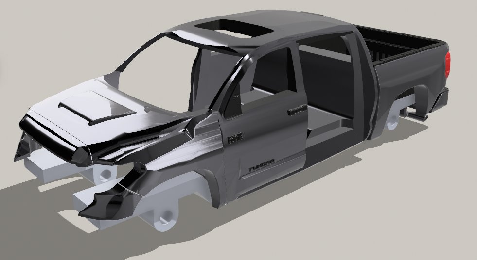

    Boys, I'd estimate we're about 90% done with the modeling. Working on smoothing out the surfaces and making sure everything fits and is able to be printed. I'd say we'll be ready to test print some pieces next week sometime.

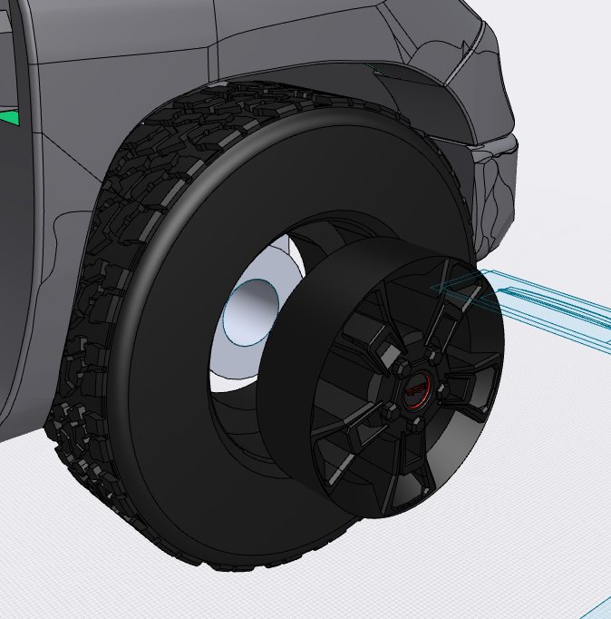

    Not sure how these will turn out, but we'll see. Tread pattern is modeled after Wildpeak AT3s and ratios are from 295/70/r18

    Wheel is a separate piece that slides into the tire and on to the Axel.
    As far as the axels go, I've been thinking about trying some 5 mm carbon fiber rods like used in rc planes, but wood or metal could work too.

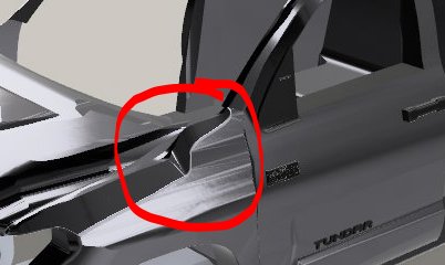

  15. Feb 26, 2024 at 10:23 AM
    #105
    34,502
    18" TRD Off Road Wheels
    Amazing work, but I gotta ask; what's up with this part of the fender?
  16. Feb 26, 2024 at 11:22 AM
    #106
    THORYOTA
    THORYOTA [OP] God of Thunder
    Sep 16, 2021
    #68123
    408
    Thor
    Asgard
    2021 MGM TRD CM "Mjölnir"

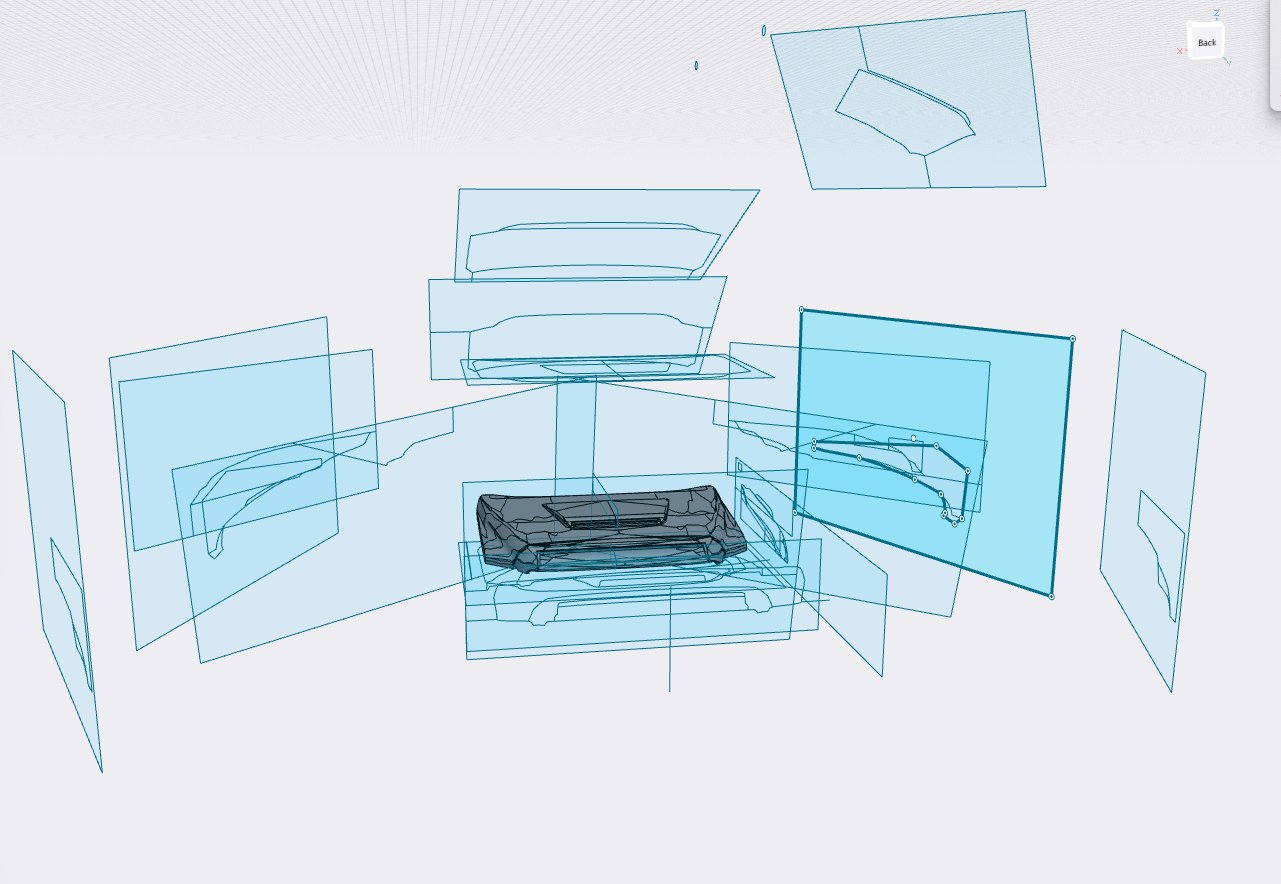

    I'm still trying to get that right. The hood and fenders have some crazy curves that have led to me remodeling each of them about 4 times.
    These are the 30 sketches for the hood, not including the ones for the scoop and bulge.

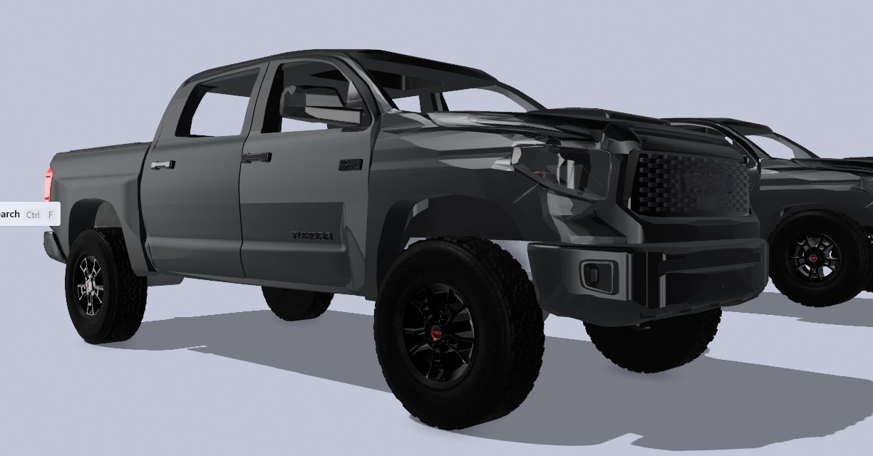

  19. Feb 29, 2024 at 10:14 AM
    #109
    Tripleconpanna
    Nov 11, 2021
    #70515
    13,682
    2021 TRD PRO CM; 2008 SR5 CM
    Did you put wheel spacers on that thing?? The 'poke' seems a bit off on the head on shot and the last photo depicting the rear tire/fender relation as well; maybe dial the tire size back just a little :notsure:
  20. Feb 29, 2024 at 10:34 AM
    #110
    THORYOTA
    Sep 16, 2021
    #68123
    408
    Thor
    Asgard

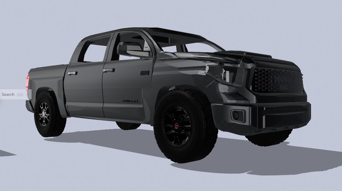

    Decided to mess around with "lifting" this bad boy. I'm working in 1:24 scale and since 1 inch = 25.4mm, for our purposes 1mm is almost equivalent to one inch.
    Here's the base height:
    Here's a 2.5mm"
    And here's what 6mm would look like:

    Voda48
    Voda48 New Member
    Dec 23, 2018
    #23382

    With the current tires, I vote that the 2.5 looks the best. :thumbsup:

    Good call. I was working with the frame that everything was based and the proportions of the tire/wheel while still giving myself a flat surface for printing. So without having to change everything I made some cutouts in the frame so the tires could still be somewhat proportional, tucked-in, and not forcing me to re-model each of the components.
    I'll have both versions available to download and one could use some 5mm washers as "wheel-spacers"

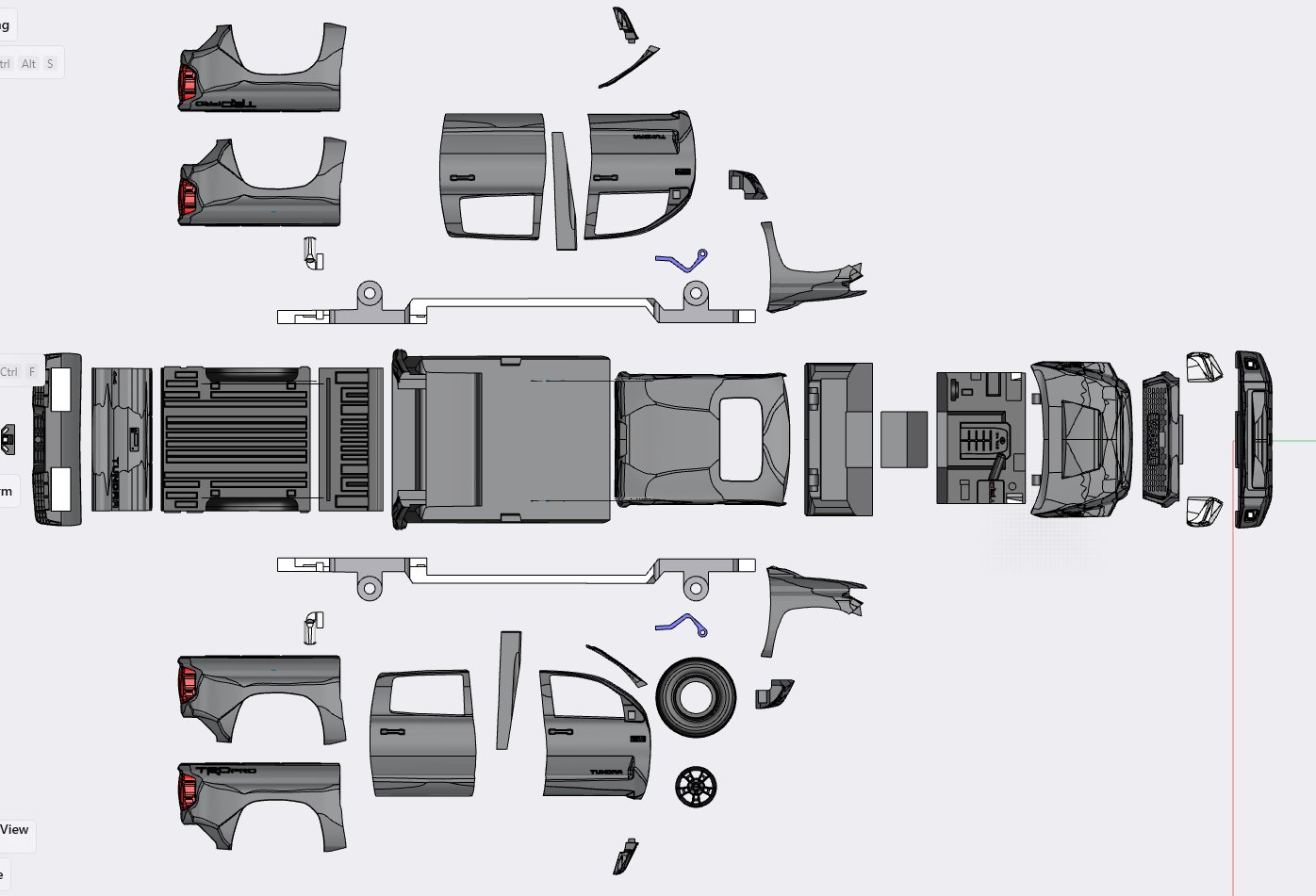

    News and Notes:
    • V 1.0 Modeling 99.9% is complete! I'm currently going over each component for "printability" and packaging each piece for testing.
    • Click here to take a brief survey if you are interested in helping test print. More info on that to come. We'll set up a group chat on GroupMe to chronicle our progress.
    • For those interested in utilizing this for your RC car, sorry but V1.0 likely won't be of use. The original intent was to create a printable model, not something that can be used and abused. That will likely come in v2.0.
    • Rear Doors will not open and close. I cant make it work without remodeling the entire cab and the front doors. As we test print if someone can figure it out, we'll go from there.
    • Other items needed to complete the model:
    1. Axel Rod
    2. Door Hinge rod
    3. Hood Rod
    4. Tailgate Rod
    5. Tailgate Magnets
    6. Door Magnets
    • Looming Questions/Concerns:
    1. Push-Fit Connections
    2. Filament
    3. Layer Height/Infill/Print Settings
    4. Viable Scales to print in

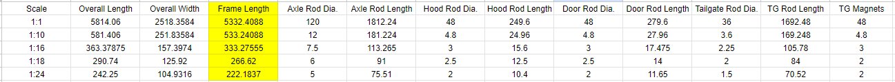

    For most people, a full model will only be able to print in 1:24 and 1:18, as the frame length is the limiting factor due to bed size. upload_2024-3-4_12-52-28.png
