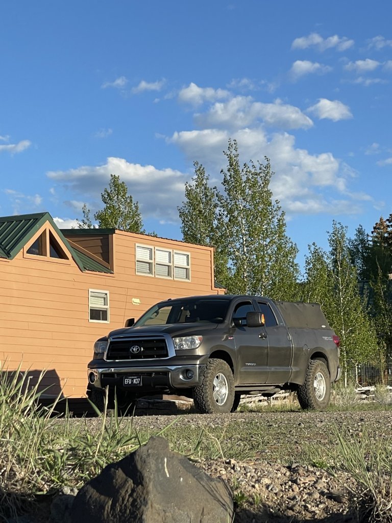

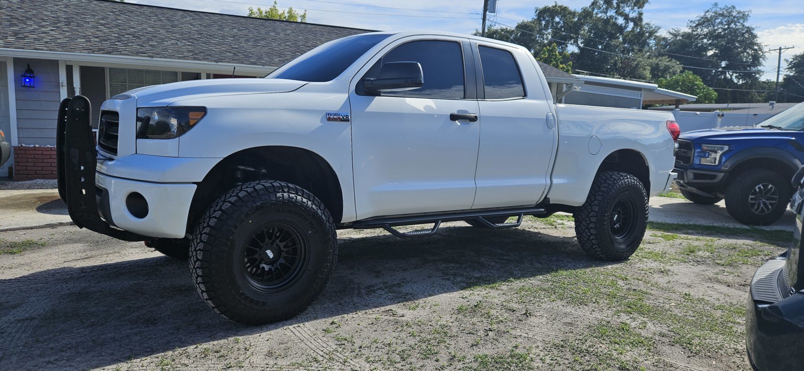

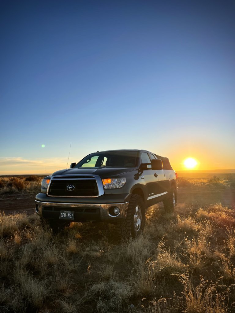

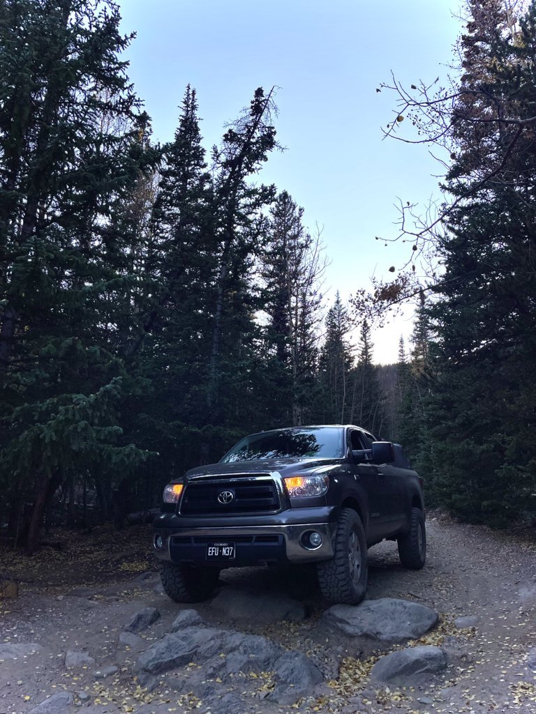

    I just got back my rig yesterday. Thinking of regearing but still has plenty of power. I'm running 0mm offset on 37x12.5x17 Kenda.
  19. Feb 11, 2025 at 8:43 AM
    #139
    SikkyRippin
    SikkyRippin New Member
    Feb 11, 2025
    #130188
    3
    2010 5.7 TRD Off-Road - pyrite mica DC

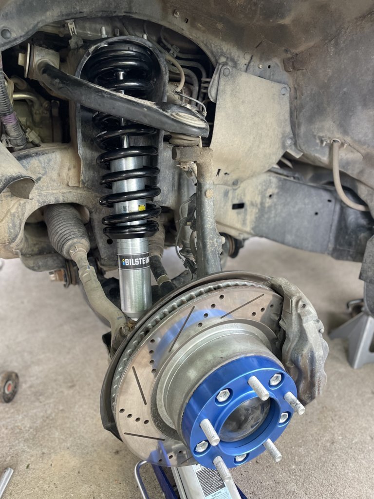

    6112/5160 Bilstein 1.9" setting ProForm 1.5" rear shackles 37" Trail Hog A/T- Kanati 1.25" KSP spacers SoftTopper shell
    Huge shout out to KevinK for sharing the specs photos and process. Toyed with the math and ideas for months based namely off of your build. My 2010 off-road DC is now sitting comfortably on 37s thanks to your information, and looks fantastic
    1'9" setting 6112/5160 bilsteins. 1.25" spacers on stock (60+~) rims achieving ballpark +27mm offset. Swaybar delete. Some grinding and fender liner work, and she's golden
    No regear, live at high elevation, don't personally feel you need to unless you're towing frequently. The 5.7 spins the 37s on dry blacktop. Not to say i don't feel the "power loss," it slowed her down a bit. But it's still fast as shit, maybe cause I'm coming from an 80 series, but I'm happy with it as it sits. Plenty of articulation, though I plan to lift the front .5" further with a spacer. Maybe extended bump stops
    some photos attached

    @SikkyRippin Love it! Are those 11.5 tires? What model? Are you getting any rub in any situation?
    A 1/2" spacer lift should be fine 6112s. When you extend the minimum shock length it's a good idea to mod your bumpstops as well... you don't want the shock itself taking all that force when it bottoms out. I got some cheap ones from Energy Suspension, that aren't listed for this application but work well. Get some 10x1.25x30mm bolts to install them.

    Thanks for the link! Id planned on getting bumpstops but hadn't looked into them. I wanted 37x11 skinnies but the only ones available to my knowledge are twice the cost.
    The tires are 37x12.5 Kanati Trail Hogs, AT and three peak snow rated. No complaints from me, can't even come close to them for the cost. & I'm not a "buy cheap tires" guy cause cheap tires are usually awful.. but I know a lot of guys that run these year round and offroad with great results
    eBay carries them
