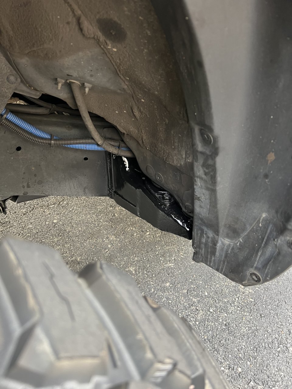

    #56744
    2,009
    Phuc (Phooc)
    Connecticut
    I think you've got another 1/2 inch of BMC to actually cut off - even then though, you will have to do PWM to really get clearance for 37s.
    reywcms likes this.

    what’s a PWM?

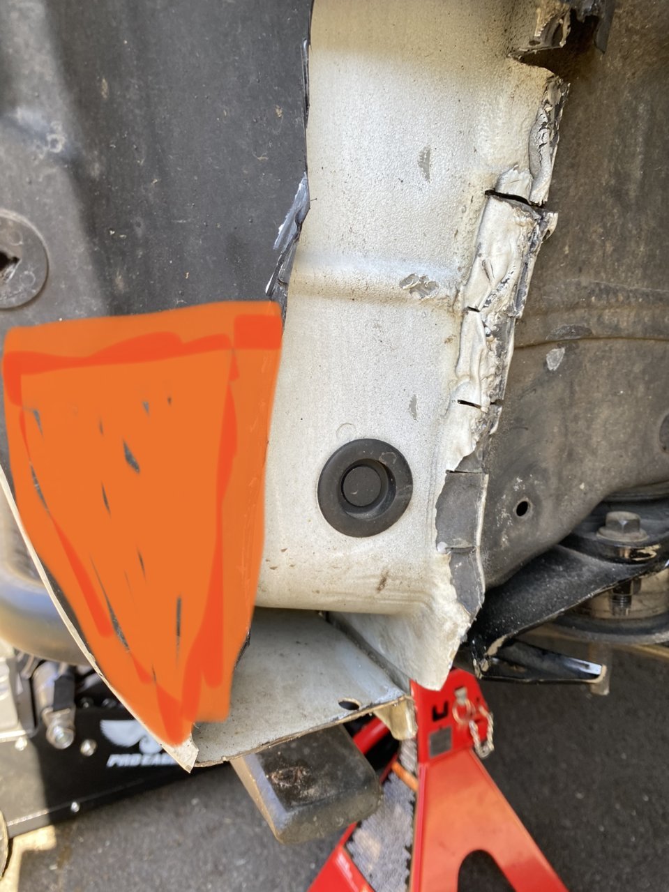

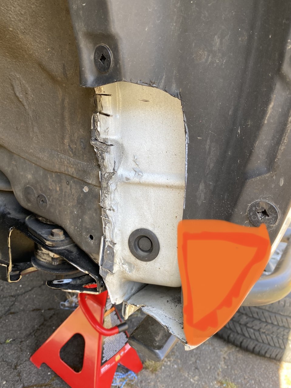

    Inside your wheel well, closes to the cab on both sides, behind the plastic fender liner lays your pinch weld.
    What you would have to do is cut away the plastic fender liner, and behind that, cut the pinch weld every 1-1.5”. Use a sledgehammer or deadblow hammer and hammer in those welds.
    It’ll create clearance for the 37s to be able turn (along with a very aggressive BMC and caster adjustment) and articulate. Otherwise without it, you’re going to rub mad crazy.

    2,529
    2017 Tundra Platinum
    Thanks for the info for this is good to know. Not sure I’d want to go through that much trouble but who knows.
